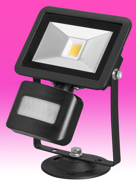

So, title says it all really.
I had a halogen security floodlight with an integrated PIR.
The mains feed ran into the PIR and there was a switched live accessible (it went to the floodlight), so I ran a further cable from this light to another non-sensor light, such that when the PIR switched the floodlight on, both lights came on.
The floodlight is very old - it pre-dates Part P.
I'd like to swap this floodlight for a modern LED unit, but all of the PIR LED floodlights that I can find seem to have just a mains connection to the PIR and no access to a switched live from the PIR. The connection from the PIR to the LED is enclosed and/or filled with some sort of potting compound)
In essence, what I'm looking for is an LED floodlight with PIR that has an accessible switched live (aka accessory switching) so that I can just do a simple swap of the old unit for the new.
I know that I could run the mains feed to a stand-alone PIR and then run this to non-sensor lights, but this would involve re-configuring the cables where, ideally, I just want to swap like-for-like.
So, (a) do such things as 'accessory switching' PIR LED floodlights actually exist and (b) can anyone point me in the right direction (links to same would be fab).
A quick Google search using terms like led security light "accessory switching" simply turns up "ordinary" PIR security floodlights as so searches on the likes of Toolstation & Screwfix
Thanks in anticipation,
XRD

Sadly, that doesn't work for me as I am in Yorkshire and there isn't a TLC branch north of Birmingham!
I did find this however (Timeguard LED PRO 10B) but it seems like it needs an additional (plug-in) PIR to do what I want it to do >> link here
Luckily, there are two CEF branches fairly close by (within 7 miles).
XRD

Not sure what link you clicked on but I liked to a floodlight with a PIR, not a standalone PIR.
oh yes, sorry. I clicked on the Steinel one in Bernard’s post.
Anyways, there’s only L,N& E. Look at the install document in the technical info.
That's not the same LED floodlight.
This is a link to the correct documentation - look at page 5 (labelled '4' as they don't count the cover as page 1) under'ConnectionDiagram'
It shows that there is a switched live output - but I think you need the plug-in PIR in order for that to be 'active'.

Yes, you buy the flood and the PIR module. Then you get the functionality that the OP is after.
Well,I had a look at both the Timeguard LED PRO 10B floodlight and the dedicated PIR - the Timeguard LED PRO SLB and it looks very straightforward and offers what I Wanted.
However, LEDBulbs.co.uk have both of these in stock (floodlight and PIR) and together with free delivery, they come to almost exactly half the cost of the same units at CEF (£33.90 vs £62.10). CEF were offered the chance to price-match, but wouldn't.
