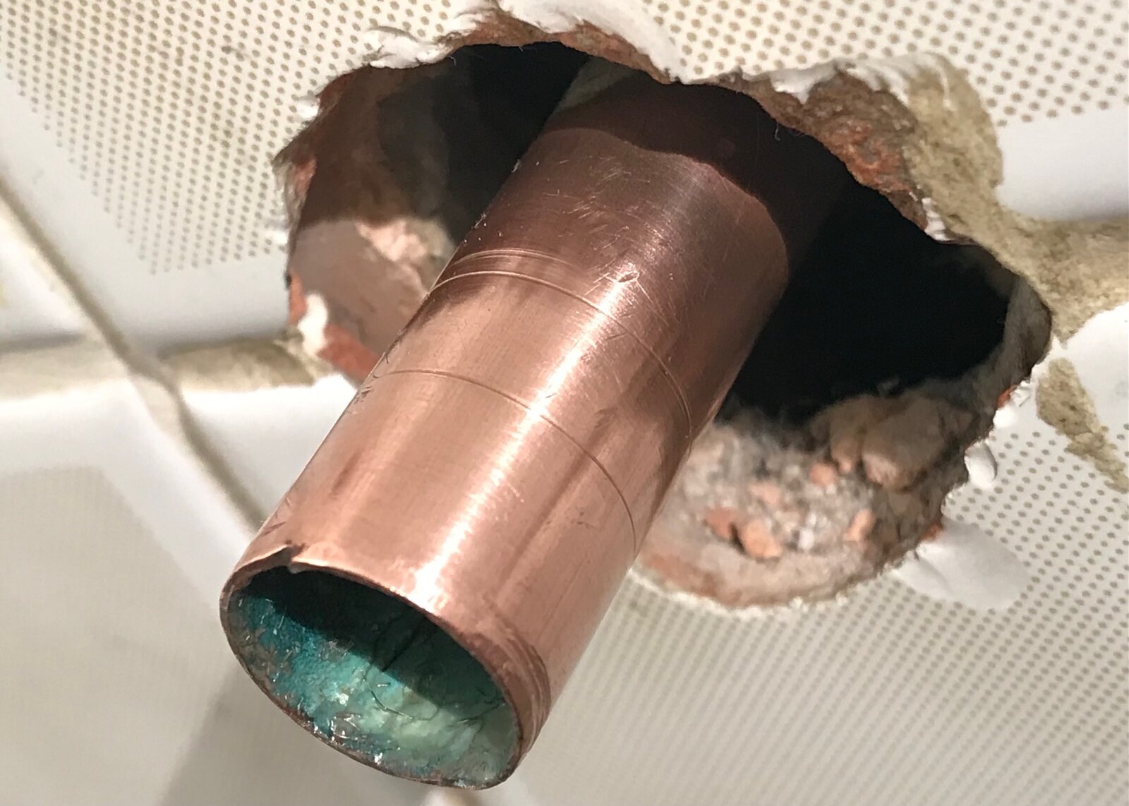

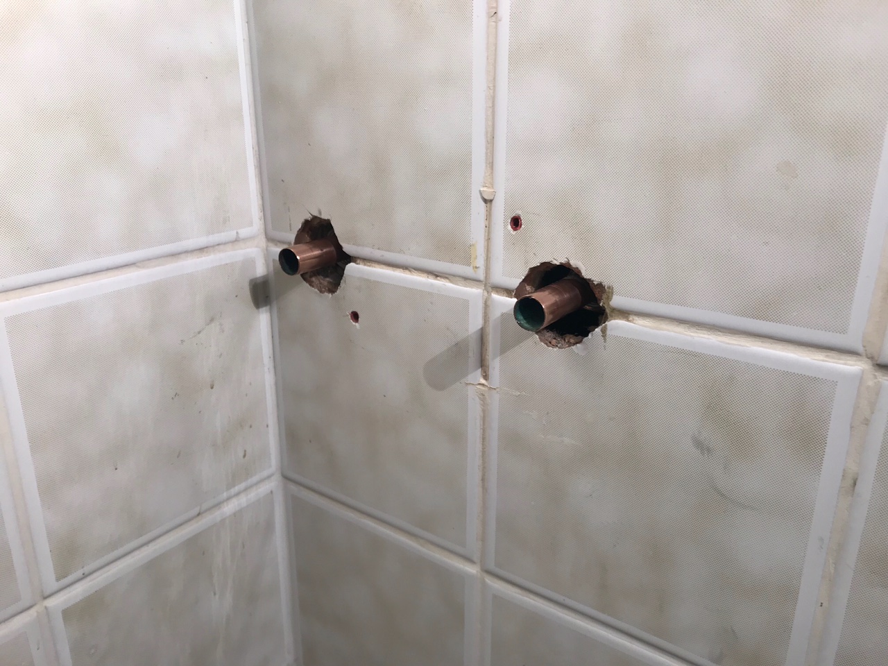

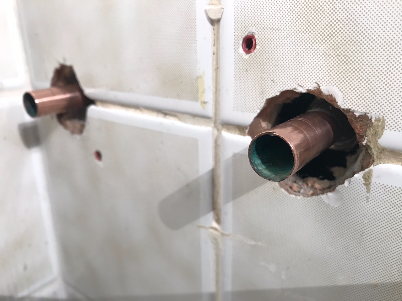

I am replacing an old gravity fed Triton T650 mixer shower. It wouldn’t stop dripping. I was hoping to repair it but having removed it, it doesn’t look repairable. But I haven't done any 'major' plumbing jobs for 25 years, so would appreciate some guidance on replacement options.
It is in a guest bathroom, infrequently used, so it doesn't need to be state of the art, top of the range or stylish, just reliable - and easy to fit! The Triton shower had originally been fitted with a pump. But this was subsequently removed as the head of water from the tank in the 2nd floor loft was found to be more than sufficient.
Having done a search I see that modern units are plumbed in in different ways . Obviously I would like one which can utilise the existing inlet pipes, which protrude 25mm, and are between 135 and 150mm apart (there is some wiggle room). Incidentally, the old olives on them came off relatively easily, but have left very slight rings (see photo). Might this be a problem? Replacing the pipework would be a pain...
Replacing like-for-like would mean a unit with separate temperature and flow controls. And the options would appear to be either a 'concentric' or 'bar'.
Any suggestion for what new unit to go for?
Thanks.
