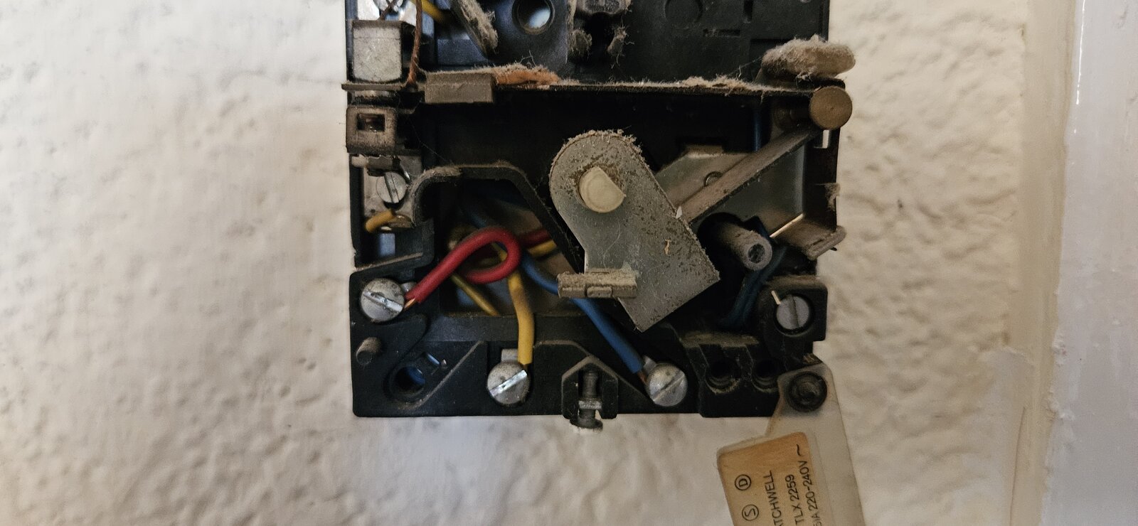

I need to replace this thermostat.
I take it I need a 2 wire thermostat to replace it
I thinking blue it neutral and I won't need it.
Red is live
Yellow is switched live?
so you planning on using two wire digital battery one
or still a normal mechanical one if mechanical then use the neutral
yep red is usually the switch live in yellow switch live out
It will a mechanical one.
So order a 3 wire thermostat?
Think we both posted at the same time
Okay thanks. I'll get the one you posted
