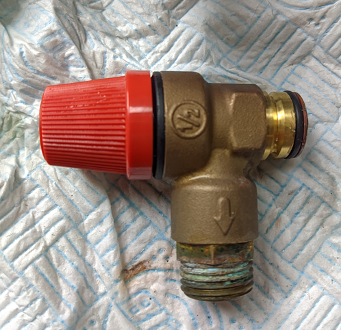

Hi there,
I ordered a compatible replacement (248056) PRV for the baxi 105e. When I removed the original I realised they are not the same. The original is all one piece. I need to get the missing screw thread (thread on both sides with the nut in the middle) but not sure what part number or what it is called. I've not been able to find the part during a search.
Any ideas?

unscrew the bit out the old one they dont come with new one

It's either fused or is one piece. I wasn't able to unscrew it. Looking inside it's too flush to look like separate parts. I could be wrong though. I've ordered another copling body to use with the new part.

You are wrong it's two parts . Maybe try two weetabix for breakfast give you strength to separate it ;)
