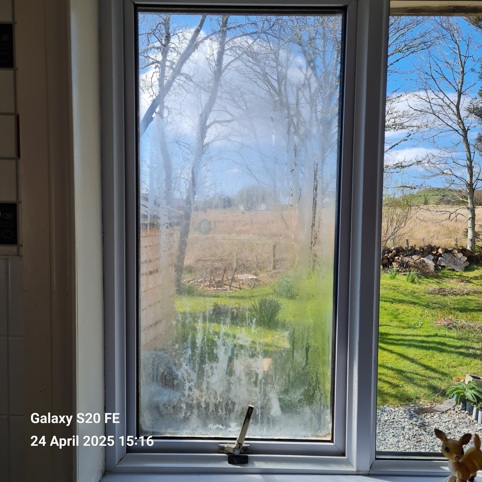

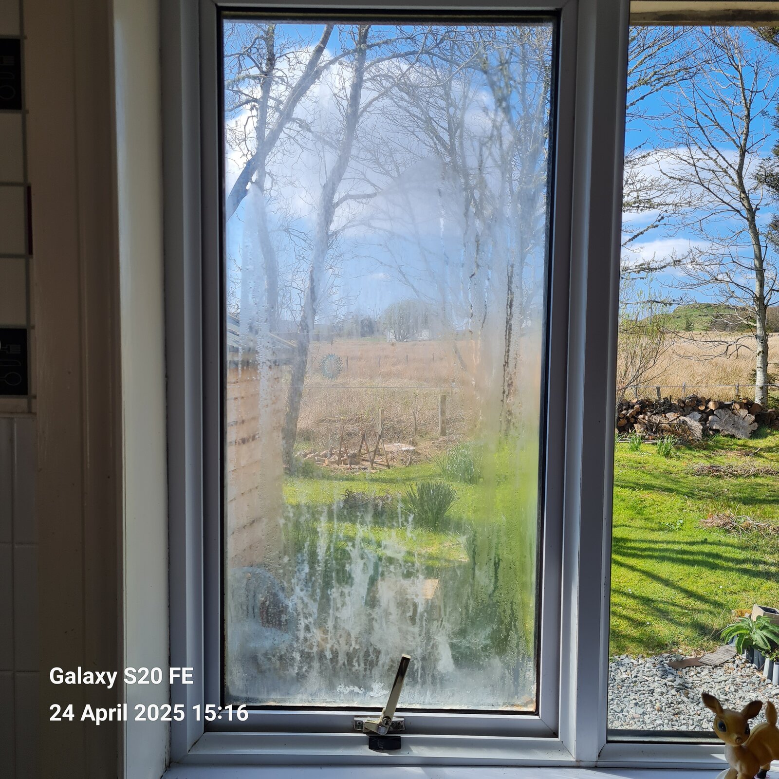

Hi, Any help would be appreciated. I am wanting to replace a double glazed unit in my CR Smith upvc window. The problem I have is there is no bead holding the unit in place either on the inside or the outside. I think the sealing rubber is the rap around type. Is there anyway of relacing the double glazed unit without removing the whole window, which is held in place with pop rivets, and opening up the casing.
Please see the attached pic for reference

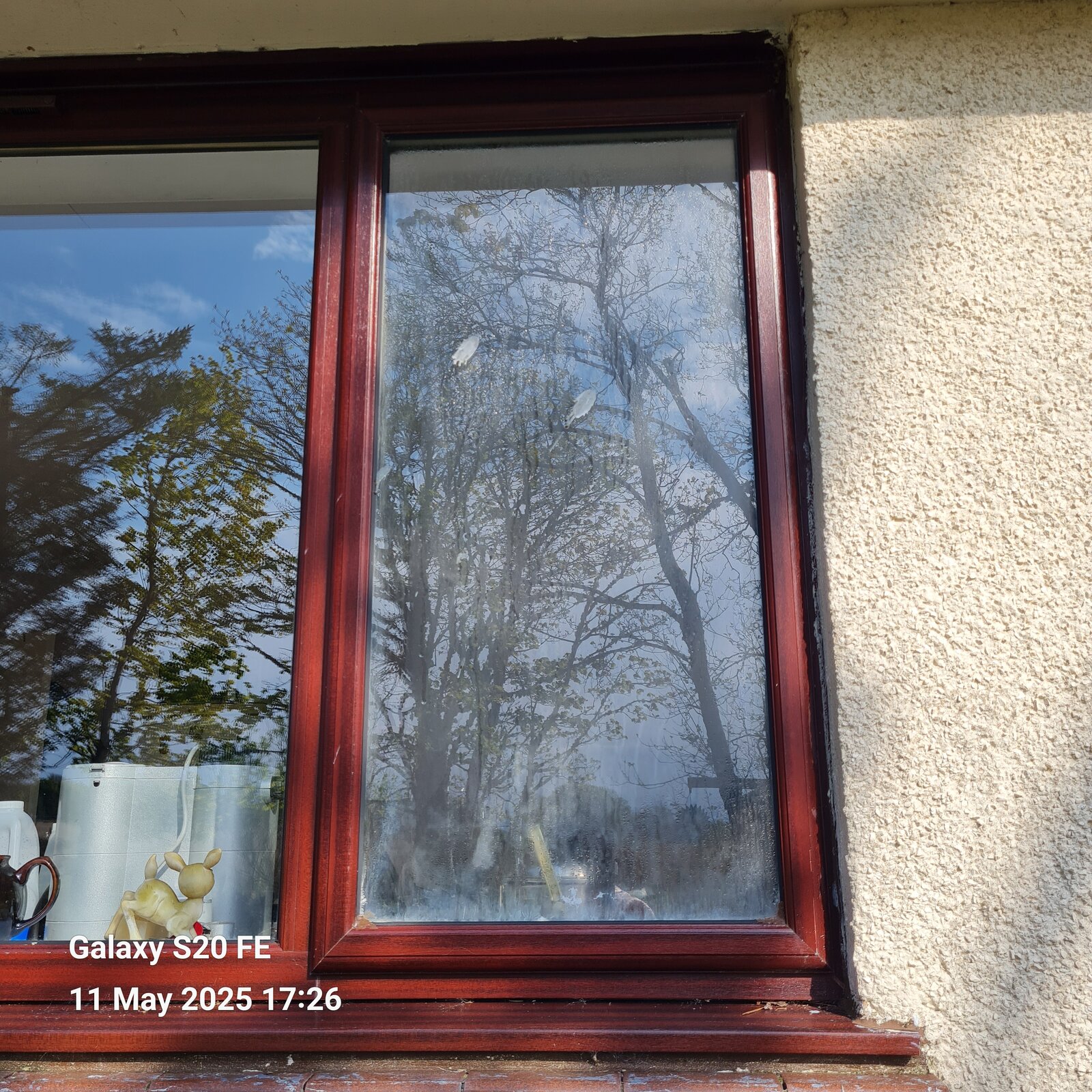

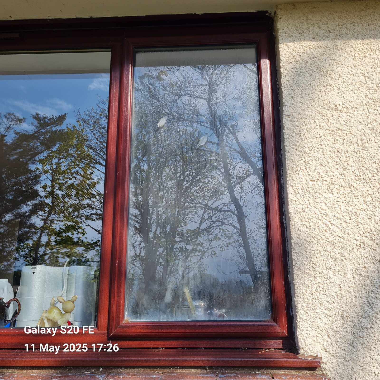

If it's wrap around then you have to remove the casement from the frame and separate the Ali from the glass, are you sure it's wrap around and not external glazed, photo from outside would be good even if it's another window so long as it's the same, downstairs maybe

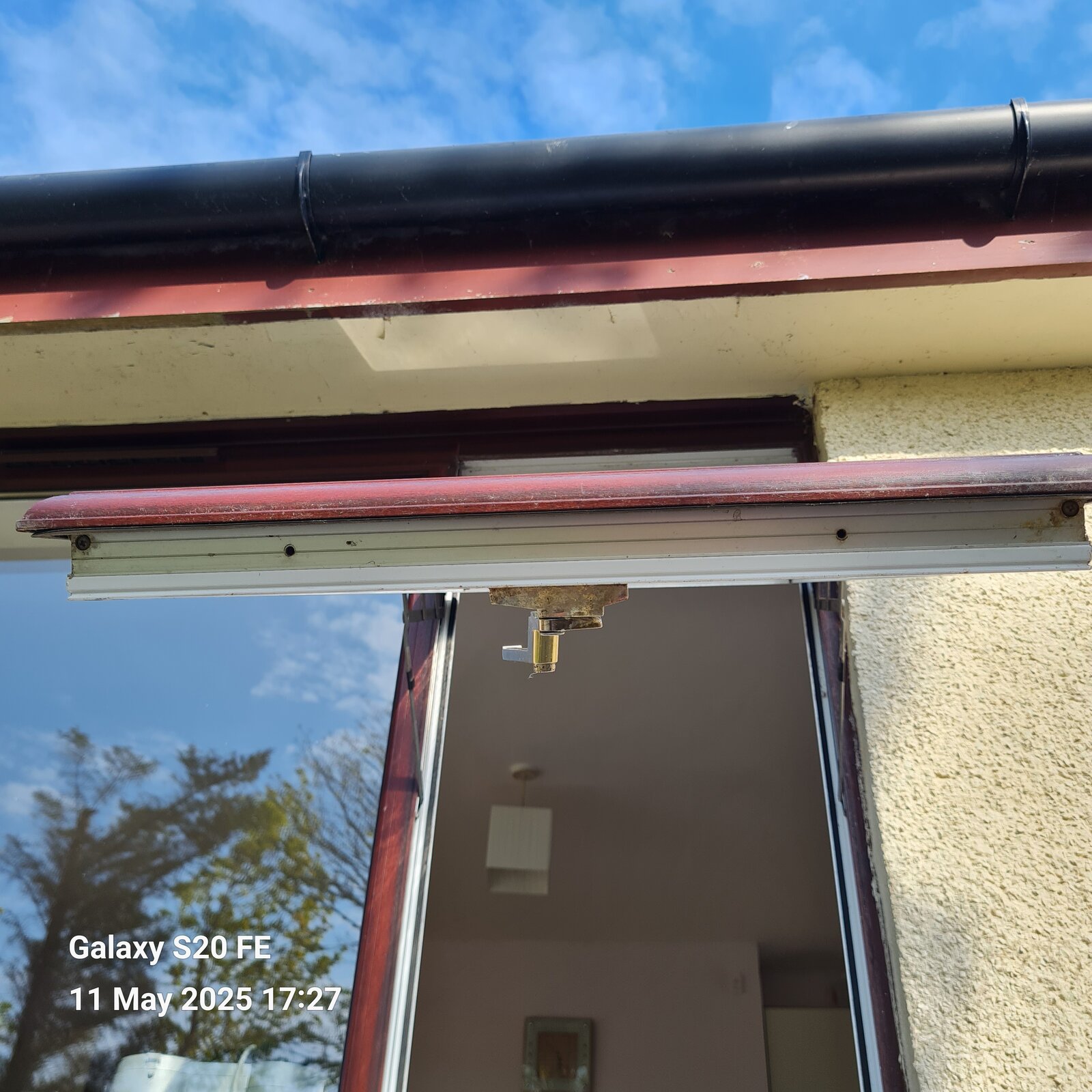

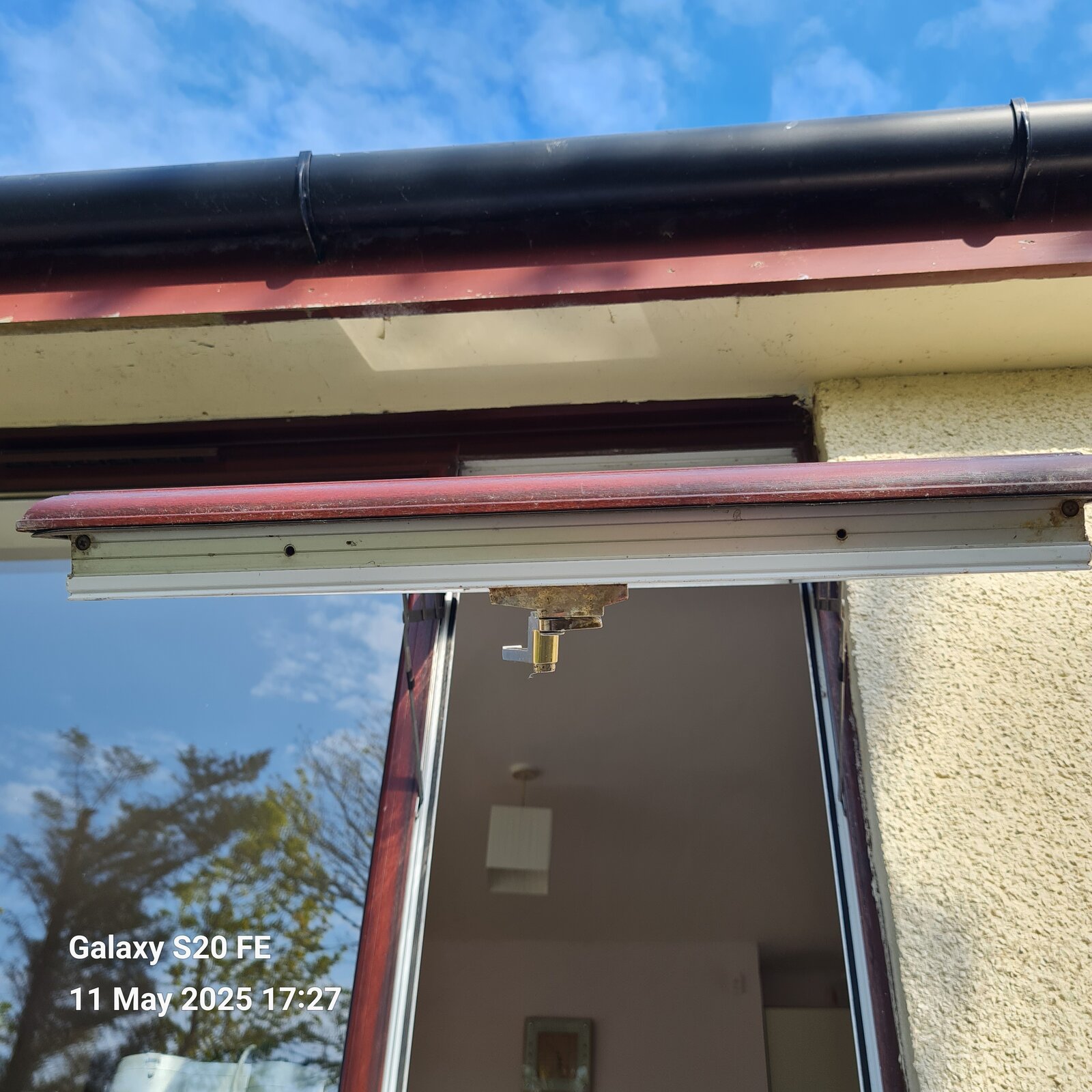

Hi Crank 39, Thank you for the prompt reply. Please see attached files. Underneath there are 2 small screws. I am thinking I would remove these, top and bottom, to split the casing!!!!!
Yes it'll have small self tapers in each corner that hold it all together but do you propose splitting the top rail off, then having the side rails still attached to the hinges, trying to rebuild it all afterwards holding the glass at the same time knocking the rails over the wrap around rubber, it's an accident waiting to happen, best to remove the casement completely and do it on the floor even if you have to drill out pop rivets on the hinges
I'm speaking from experience as I've not had much to do with CR Smith, quite big in Scotland but unheard of down south, I know our engineer in Scotland had loads of warranty work due to them
I was going to drill out the pop rivets in the upvc window frame side rails to release the whole unit and work with it at ground level. I no what you are saying about trying to replace the glass with the frame in situ. Ouch, would be an accident waiting to happen.
Thank you for your feed back
Yes remove the whole casement but after that remove the self tappers and pull off the aluminium sections
Yes C R Smith is quite big in Scotland but they don't come to the Islands anymore. Trying to get someone to come and replace the windows is costing an arm and a leg, very expensive. I can get the replacement glass from CR Smith for around £80 delivered. You can add another 4/500 pounds at least to get a company to fit it with no guarantee. Hence D.I.Y. I can generally turn my hand to many jobs.
Yes, I was going to remove the pop rivets and take of the aluminium slides and reattach them with self tappers if I can to try and make it easier.
Once the new window arrives I will get on with the job, hopefully with not to many problems as there are more to measured up and purchased and fitted. Good job I am semi retired.
Once again thank you for all your feed back.
