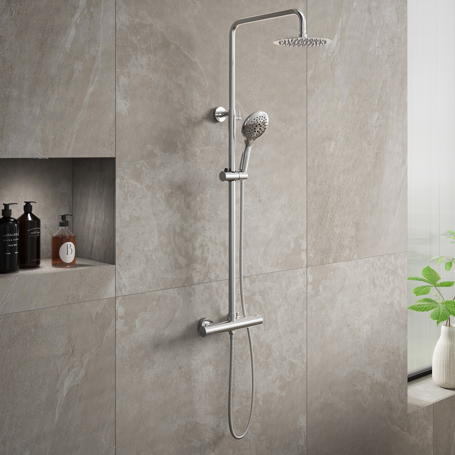

I'd like to replace the exposed shower set that we have with a 2 outlet set, but I don't want to have to change the tiles.
I've been looking at the Grohe ones and the inlets seem to be on a 150mm centre, which is the same as the one I have, and the Grohe ones have a movable support for the upright.
But the dimensions show the upright as 1106mm (and it's similar on the Villeroy and Boch). I only have 890mm max for the upright, or I'd have to move the inlets.
Is this a fixed amount or do I cut the vertical pipe to the shower head to the required length?
I bought a cheap set from Screwfix to replace my Mita which im pleased with.
I cut the vertical post so that the fixings matched the holes in tiles...
Is that what you are taking about?
Yes that's what I mean. Do you think it's normal to cut the vertical pipe to the desired length?
It's not just a post, it's the pipe carrying the water to the shower head
Mine was just the riser bar.
Money was tight at the time.
If I was to replace now I'd just get the original Mira and fit.
Can you not get a direct replacement?
I don't know about your specific setup and cutting
Most I've seen can be cut to suit, some come with a preformed end which can't. Just check that, but likely to be ok.
Grohe specifically state theirs can't be shortened. https://www.grohe.com/en-ZA/service-support/faq/products-faq/shower-faq
(They are in fixed lengths connected with o-ring sealed plug/socket type connections to the mixer body and curved arm.) Actual height/length varies a smidge depending on exact model choice.
Other brands may vary.
Sounds like your mixer is fitted higher off shower floor than average... to leave only 900 to 1000 before hitting the ceiling?
Yes it's fitted higher than necessary. I've found an Aqualisa AQ150 which has an adjustable height that I think will work.
