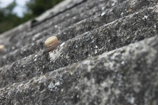

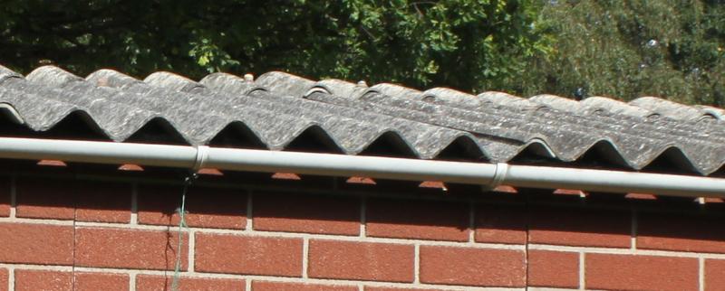

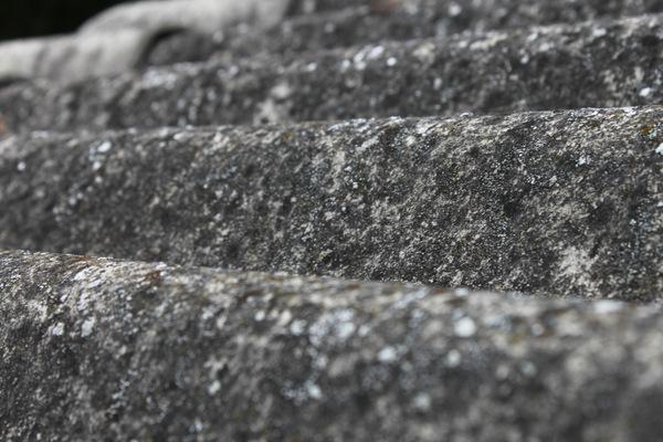

I want to replace a garage roof, principally because the current roof is made of asbestos.
I know next to nothing about building, so wanted to know, if I get an asbsestos removal company in to remove the current roof, will the garage be structurally safe for a while without a roof?
Or do I need to get a builder in immediately to put a new roof on top of the garage?
If it's corrugated asbestos cement panels then fine to remove with no effect of the structure.
What are you planning to replace them with?
There is no reason to replace them because they contain asbestos - perfectly safe if in good condition and left alone.
I don't know what I'm going to replace them with.
Would you say these panels are in a good condition?
