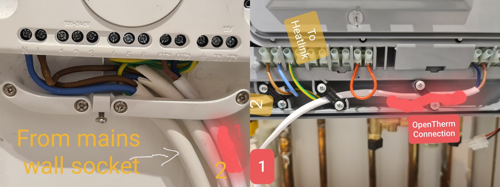

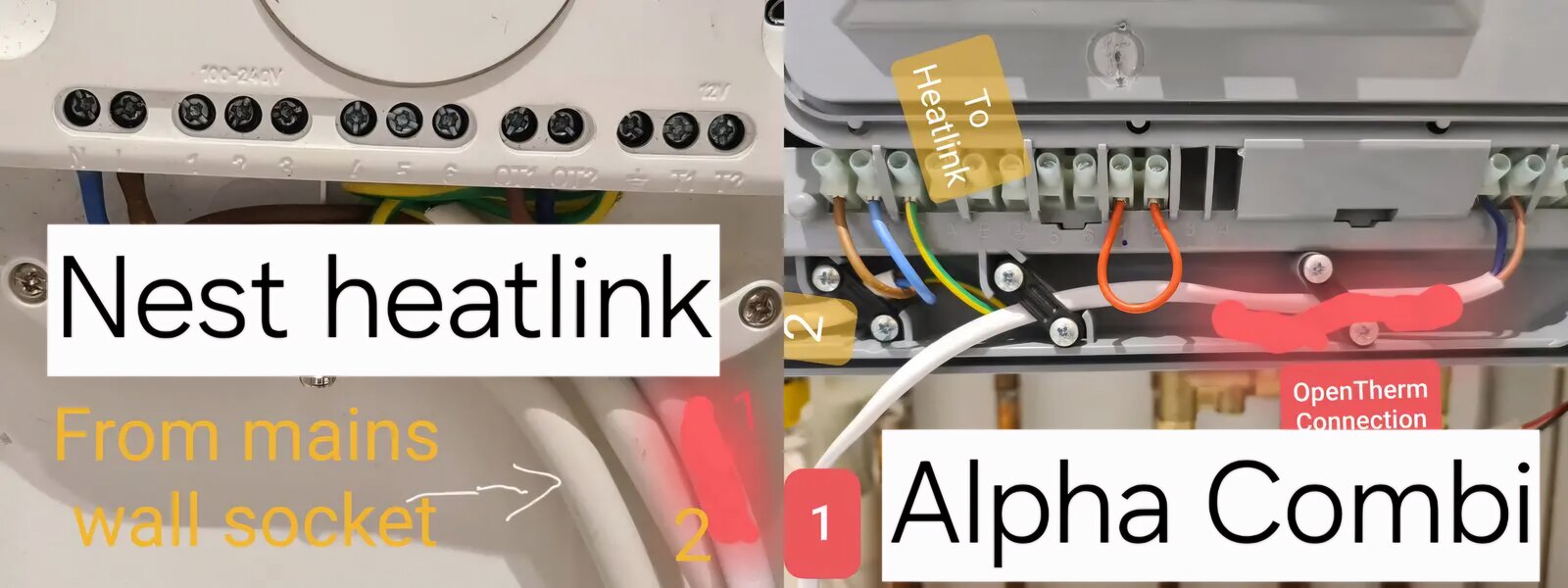

so, the current setup is
1) Alpha Combi boiler...
2) Retofitted with a google nest heatlink to the boilers OpenTherm connections with cables, so the heatlink and boiler are in the same cabinet in the kitchen
2a) The Nest "Thermostat" ' which is the round clock like, Apple-esque dial, is portable and can move anywhere I can connect a usb power source to.
3) The small Tado wifi bridge is connected with a lan cable.to my internet router, and manages to see.all the Tado radiator TRVs in the house.
the attached pic shows the boiler and Heatlink connections (in the picture: 1) From the boiler OpenTherm connectors (41/44) direct to correspondong OT1 and OT2 on the Heatlink
2) L/N/E from Boiler to L/N/E on Heatlink, and from there to power socket.

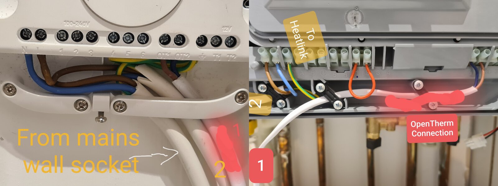

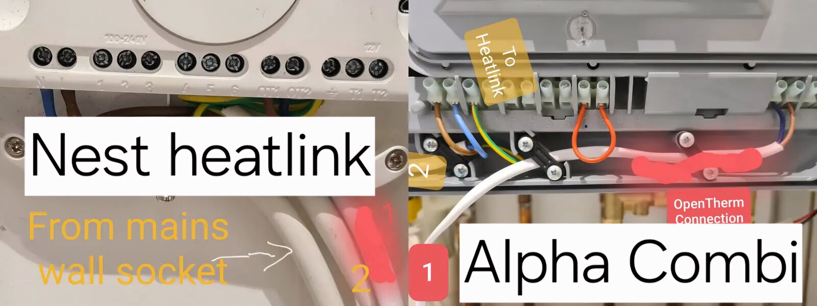

So, I decided to go for the TadoX boiler controller, to replace my old google nest. the wiring for the controller back when I had Nest in olace, had a jumper between terminals 1 and 2 on the Alpha boiler (in addition to the 2 opentherm cables coming from the nest heatlink) - see attached picture.
Im following the instructions from the Atado app, and there is no instruction to have the jumper in the app - is it needed, or should I remove the jumper?.
thanks
OK, so, in the end, I left the jumper in place, read thru the Alpha installation manual again - it states in case of OT controller, you have to go into the service menu and set the boiler for OpenTherm control AND the jumper needs yo be in place on terminals 1 and 2.
