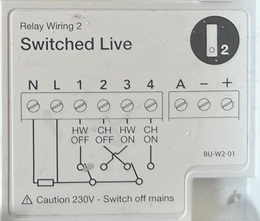

Salus RT510RF to Tado system
Green/yellow with brown sleeve to CH/ON terminal 4
Brown to L
Blue to N
Following this View attachment 337372 diagram that you posted. Or as @RandomGrinch has said swap to 1 system link, and use link wire.

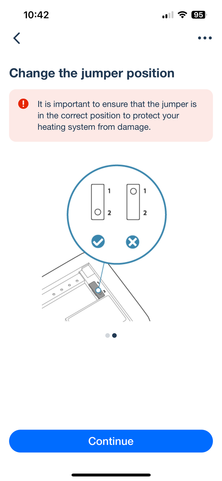

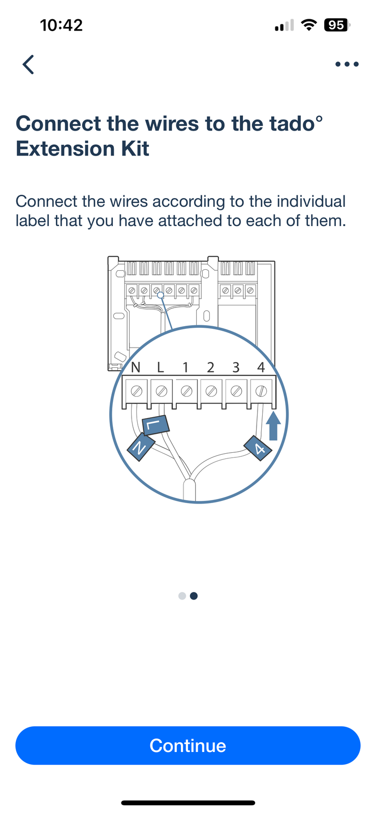

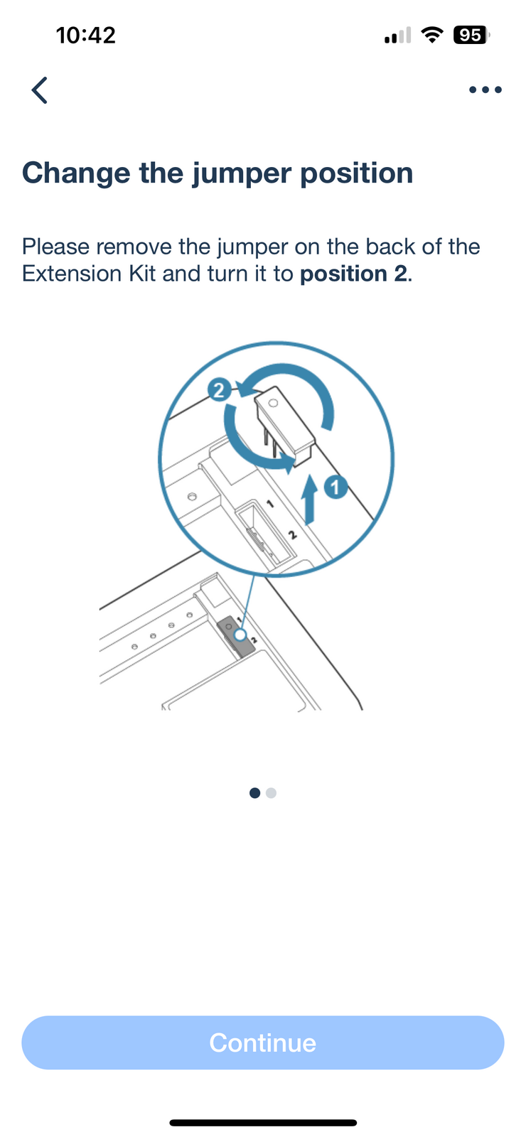

I was following the Tado instructions for replacing a Salus RT510 Receiver and it mentions to wire:
Brown to L
Blue to N
Jumper setting to 2 (which is what I believe @ericmark suggests).
I have attached photos from the Tado instructions on the app - proposed wiring suggested by Tado and the jumper suggested setting.
Should I follow the instructions as suggested by Tado which I believe/hope is for connecting Tado to a combi boiler and have it on jumper setting 2? Also, can I ignore the need for attaching the small Brown link wire between L and terminal 1 ?
Stupid question but I asssume I follow the Tado instructions to install the devices at my son's home (i.e. pairing the extension kit with the Smart thermostat) and then follow the moving of devices to a new home instructions ?

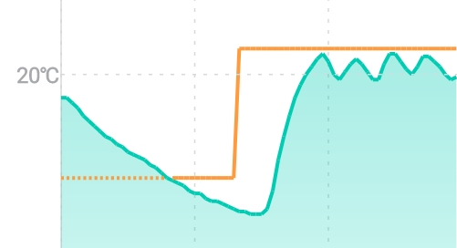

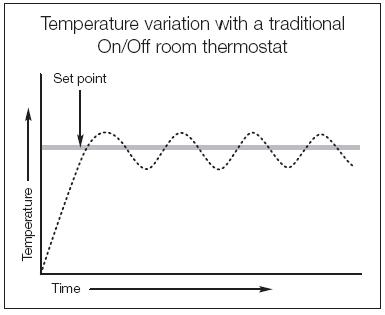

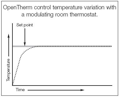

I do see how there is a huge difference between modulating and non modulating boilers, same with heat pumps with on/off and inverter speed control. In the pre-modulation days thermostats used the mark/space ratio to stop over shoot, however this will cause many boilers to auto return to flat out setting and it messes up controlling how much to modulate a boiler. I had this problem with my mothers house, with a Worcester Bosch boiler which did modulate but had no way to interface with the modulation control.
I know my own boiler (oil) does not modulate, and looking at the graph from the Kasa TRV 1711027027238.png one can see the result of on/off control. We have seen the two graphs for years, Temp_variation_on_off.jpgTemp_variation_OpenTherm.jpg but actually seeing the report from the TRV makes one realise this is not theory but actually happens in practice.

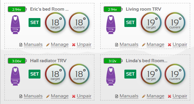

However the question is with a modulating boiler, what does what? If one has a modulating boiler and no wall thermostat the TRV's can be set to maintain each room at the set temperature, I did this with my mothers house, the report from the TRV's TRV-report1.jpg was used to set the lock shield valves, if the current exceeds the target close the TRV a tad, and of course the reverse. What I found was radiators did not get hot and cold, but some where between the two limits maintaining the room temperature as set. The TRV heads did not link to main thermostat.

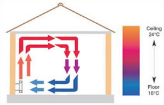

Linked TRV's and ebus control makes the setting up so much easier. We see the diagrams circulation3.jpg showing why the thermostat should be on the opposite wall in line with radiator to work and be at a height that is easy seen and adjusted, but really what we want is a hub collecting info from each TRV and using it to tell the boiler what to do. Also add some temperature sensor to the hub, so should signal between the TRV and hub be lost, it does not go daft.
I know my own boiler (oil) does not modulate, and looking at the graph from the Kasa TRV View attachment 337387 one can see the result of on/off control. We have seen the two graphs for years, View attachment 337388View attachment 337389 but actually seeing the report from the TRV makes one realise this is not theory but actually happens in practice.
