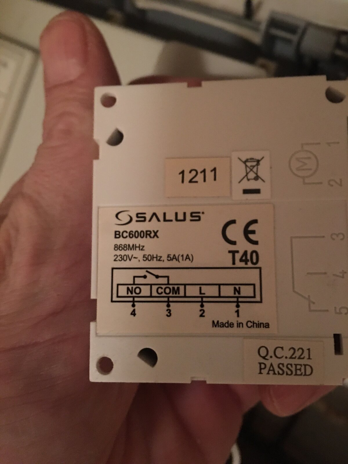

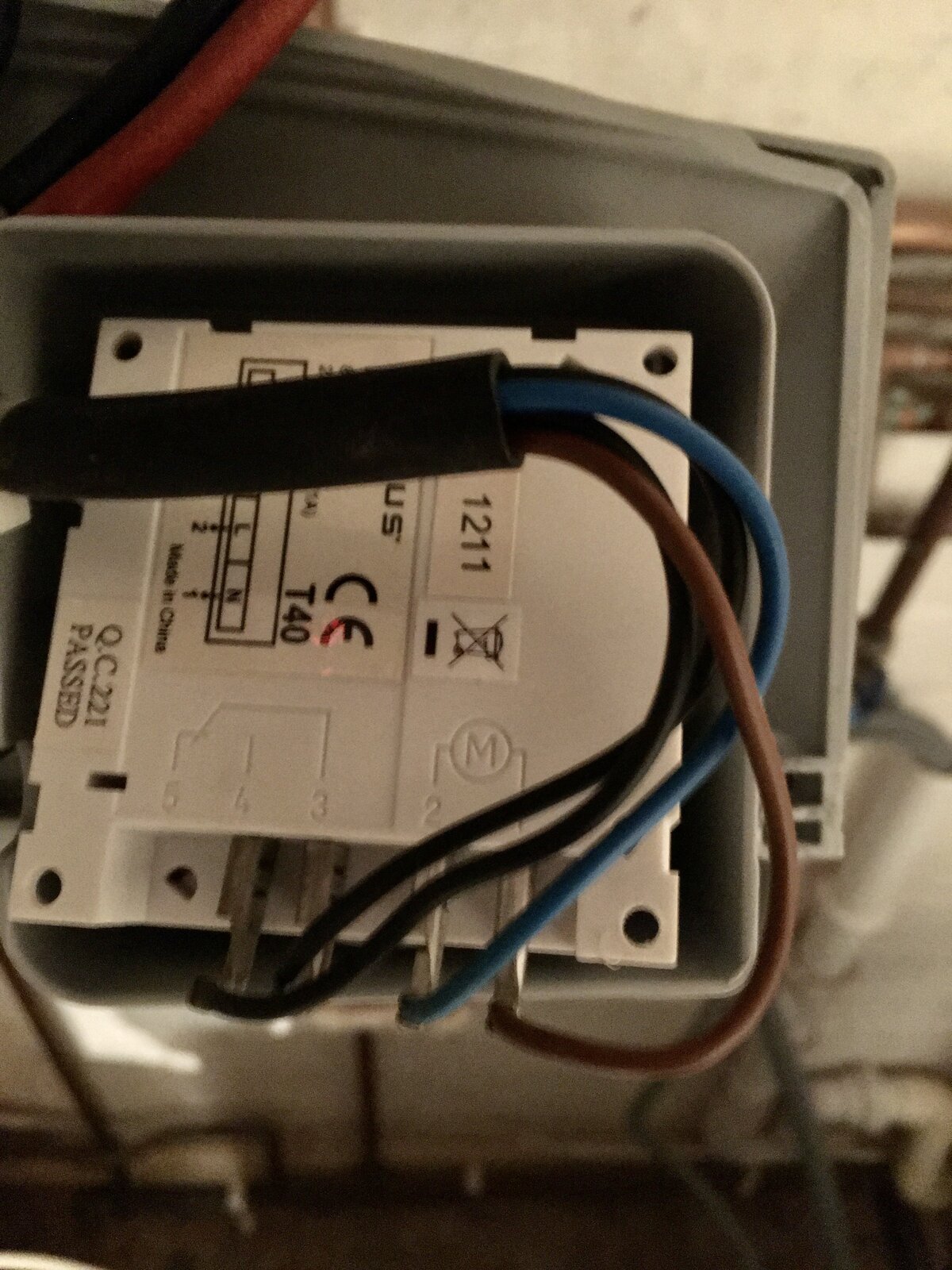

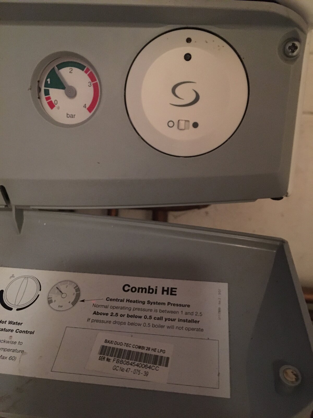

The receiver installed in my boiler (Baxi Duo Tec HE A) is currently a Salus BC600RX. Please see attached a photo of said receiver (front and back) and the wiring of.

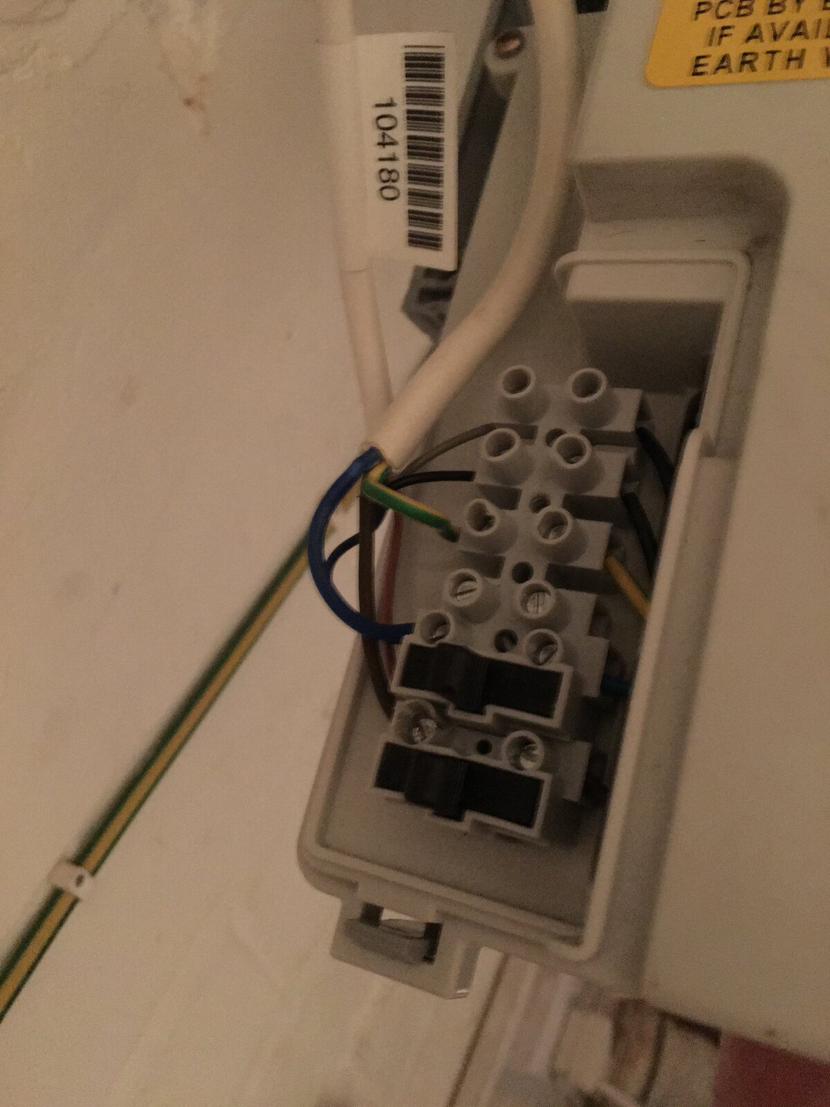

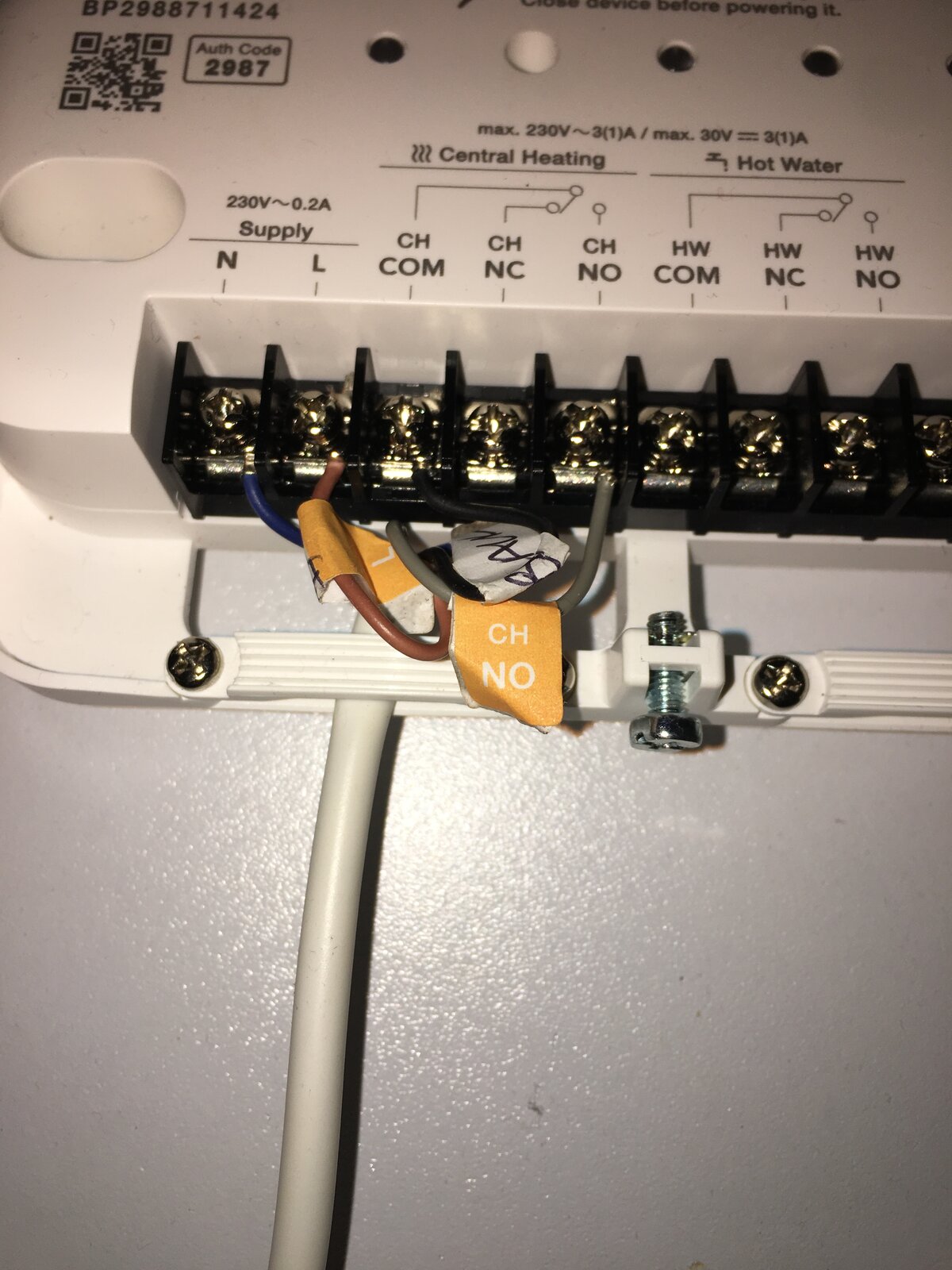

Also attached are photos of how I’ve wired in the Tado wireless receiver as advised on the Tado website for a Baxi Duo Tex HE A.
the problem I’m having is both wireless receivers have to have a demand for heating before the boiler will cut in. If the Salus is demanding heating it won’t likewise with the Tado.
should I just disconnect the Salus and see what happens?
Many thanks
there will be 4 wires on the back of the BC600RX, L&N to power it and then 2 switching wires , you need to join the two switching wires no 4 and 3

If you want to remove the salus phsically you will have a hole in the facia just join the two wires in 3&4 and the Salus is by passed, if you want you can remove the L&N too but dont join them to anything
So that would effectively put the Tado in sole charge, the Salus is no longer connected so plays no part.
Can you confirm, does the Tado wiring remain as it is in the picture, connected away from the salus, wired within the power input wiring?
yes you could have used the Salus wiring to do it but its done now it will be fine
Many thanks ianmcd, that seems to have done the trick. Just one final question, the Salus receiver is still flashing on and off, is this only because the 2 wires are connected, it’s no longer searching for the thermostat?

Yes it is trying to pair with the origional thermostat, just pull one of the wires off and it will stop
