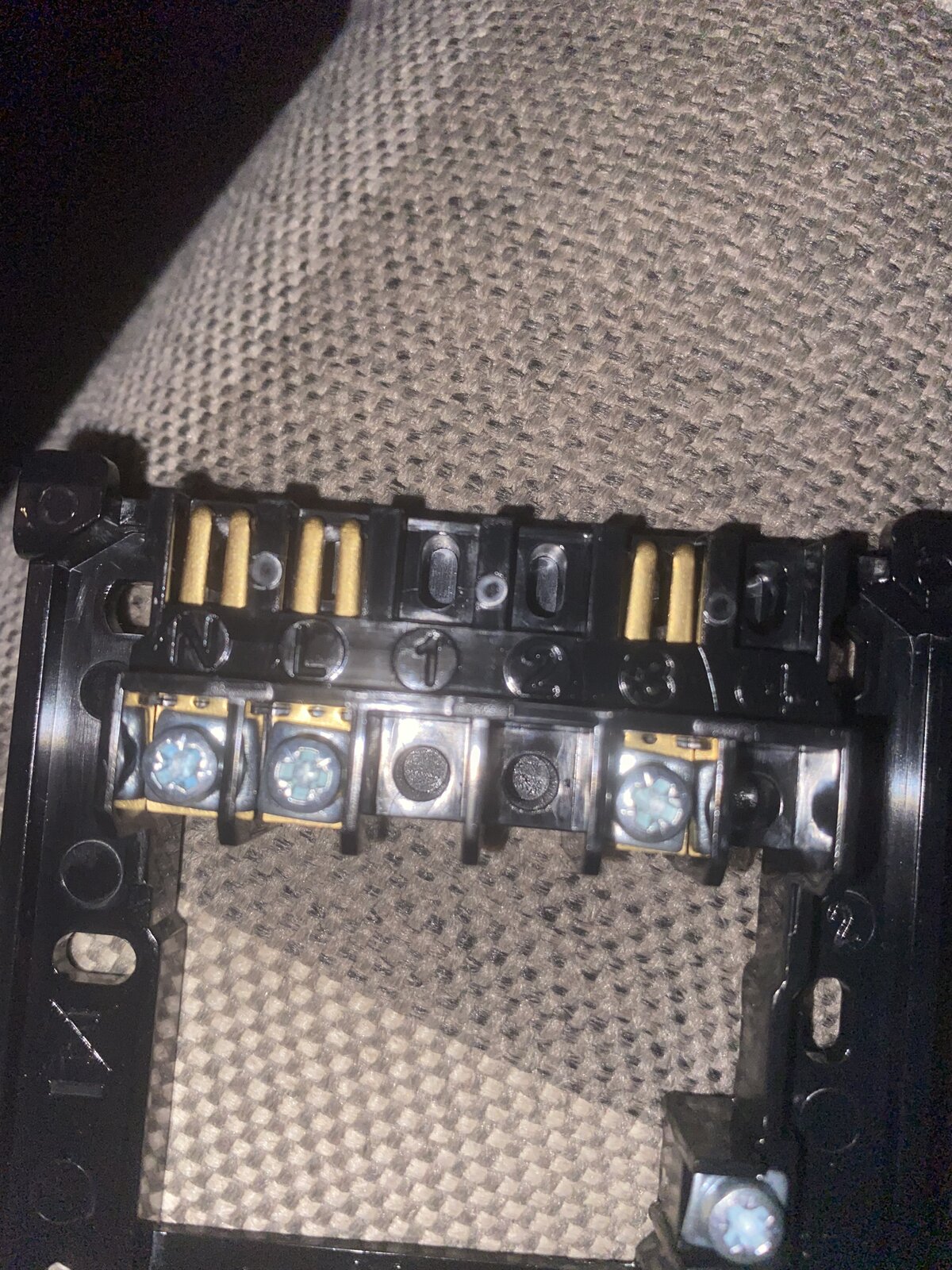

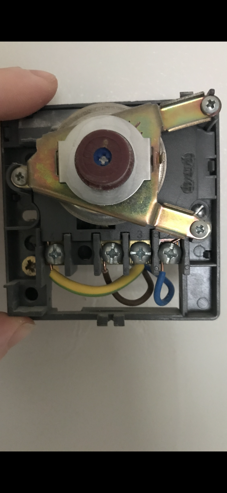

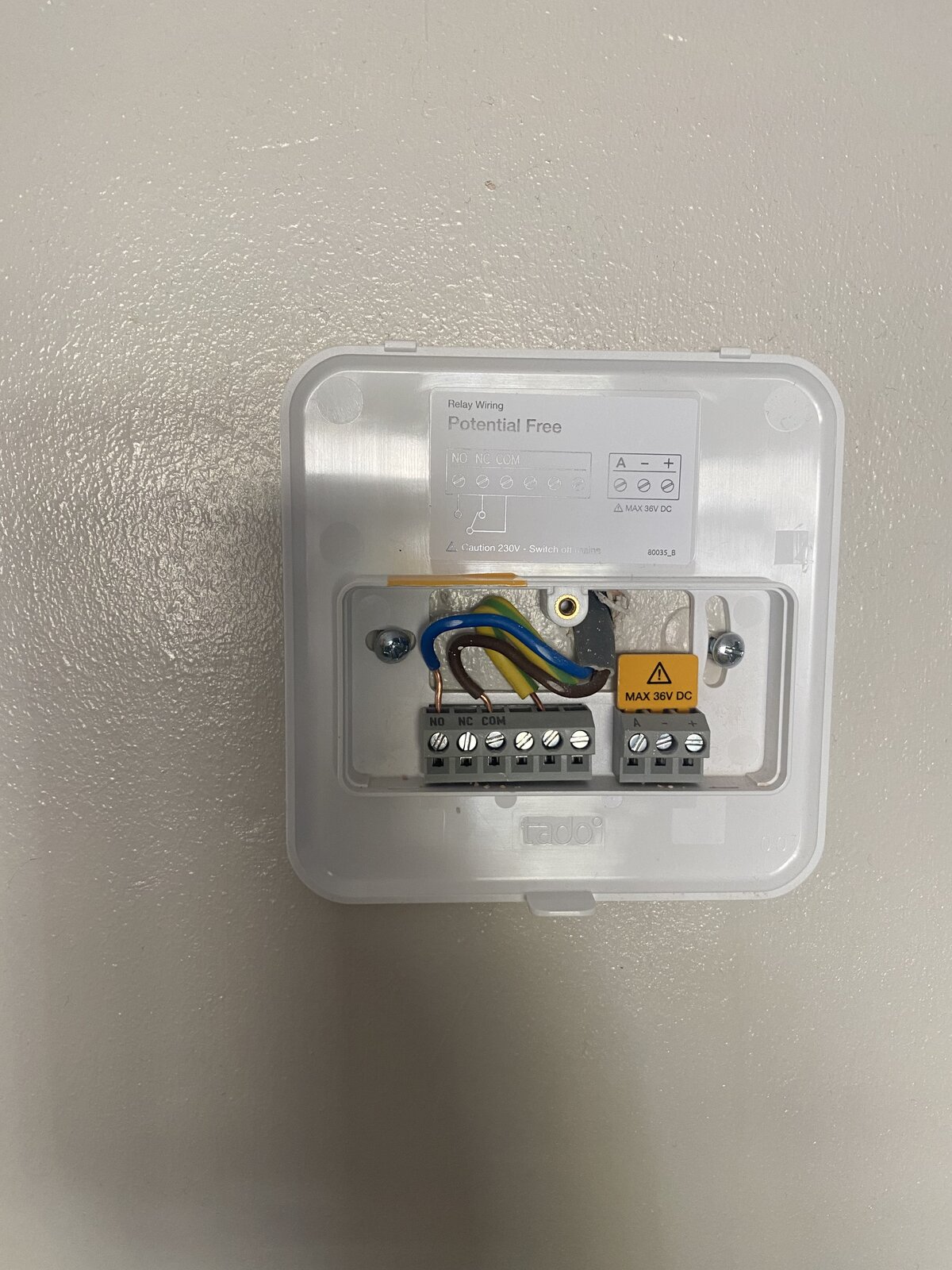

Hi, I want to take my tado with me to a new home and need help wiring a new thermostat.
I have bought a Drayton RTSI 2400i to replace the tado (hope it’s right!!)
I’ve uploaded a pic of the tado wiring, the back of the Drayton (which only has N L Call for heat and earth), I also added the old thermostat prior to the tado just in case.

You need a Neutral for the Drayton, which looking at the Tado wiring, you do not have. You can get 2 wire thermostat’s including a similar of the one you have, a Drayton RTS8, or a battery operated one (any brand).
