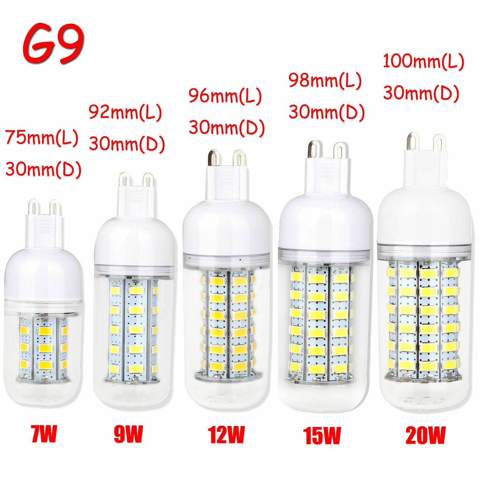

SMD-5730 is the chip (0.5 watt) but likely not driven to maximum output possible down to 0.1 watt, so likely around 6 to 10 watt total, but not marked, neither is the lumen output, so in theory not level to sell these bulbs in the UK, internet is the only way to get them. It does seem there is a range 1661832496112.pngLooking at picture off internet I would say mine are 15 watt, but as said unmarked. They are really too bright for a bedroom, so wife has some wall lights for when not wanting such a bright light.
