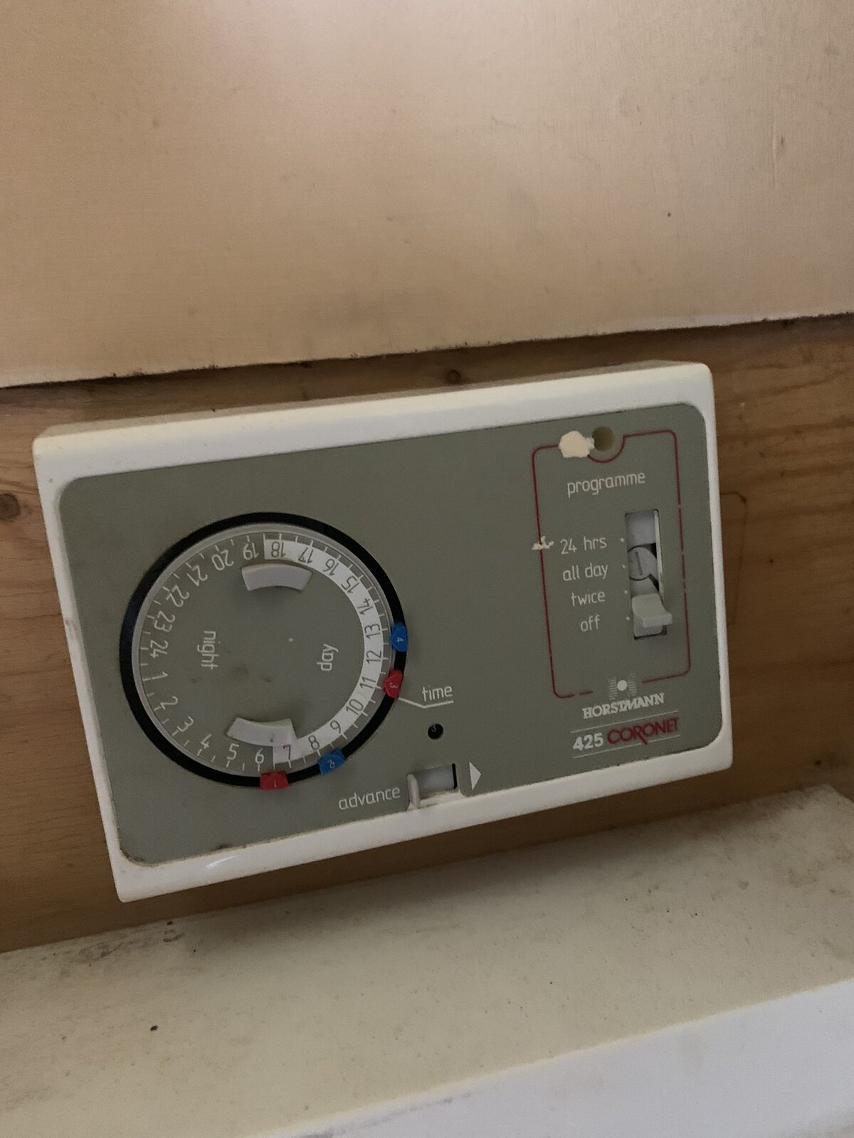

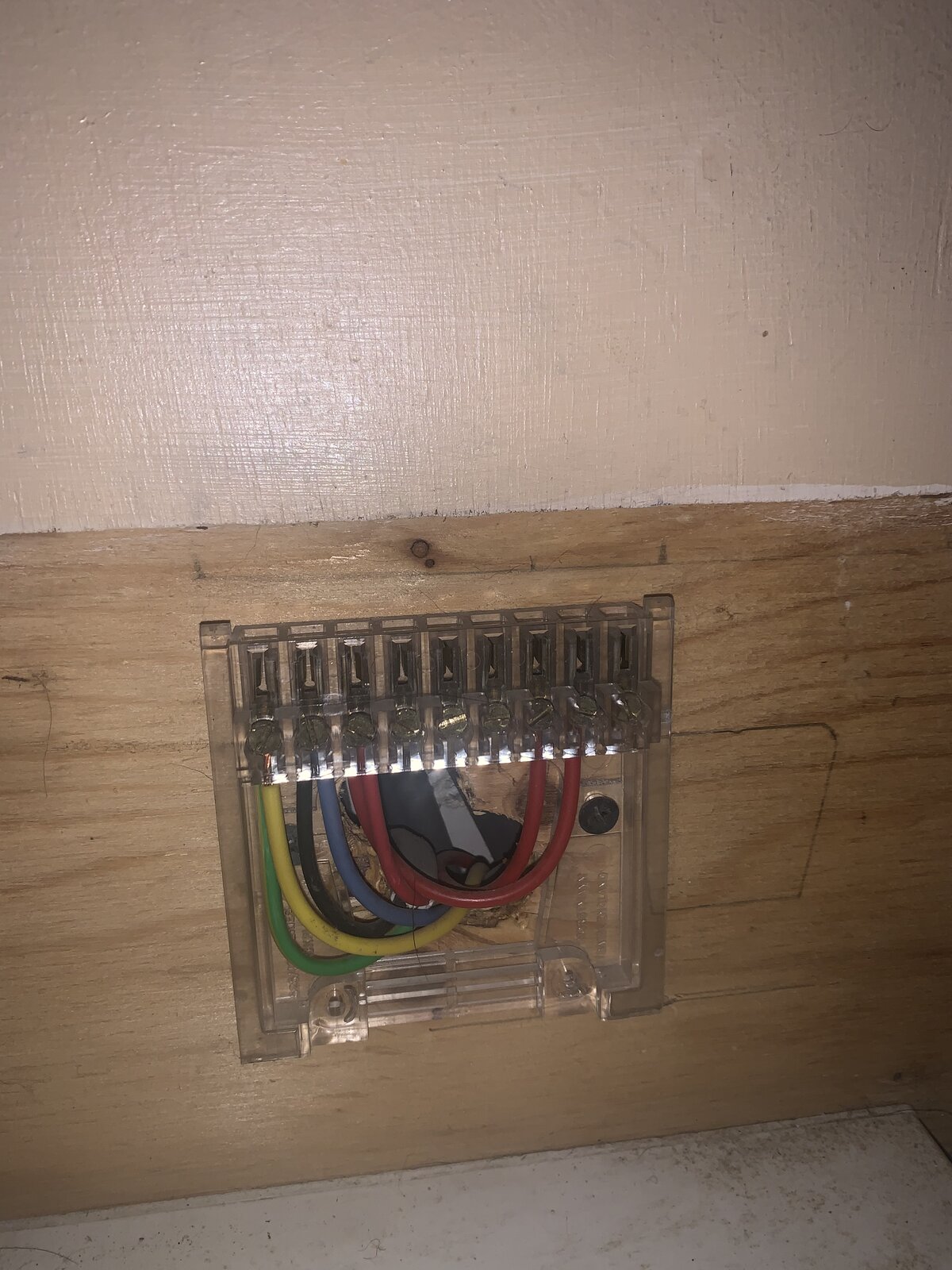

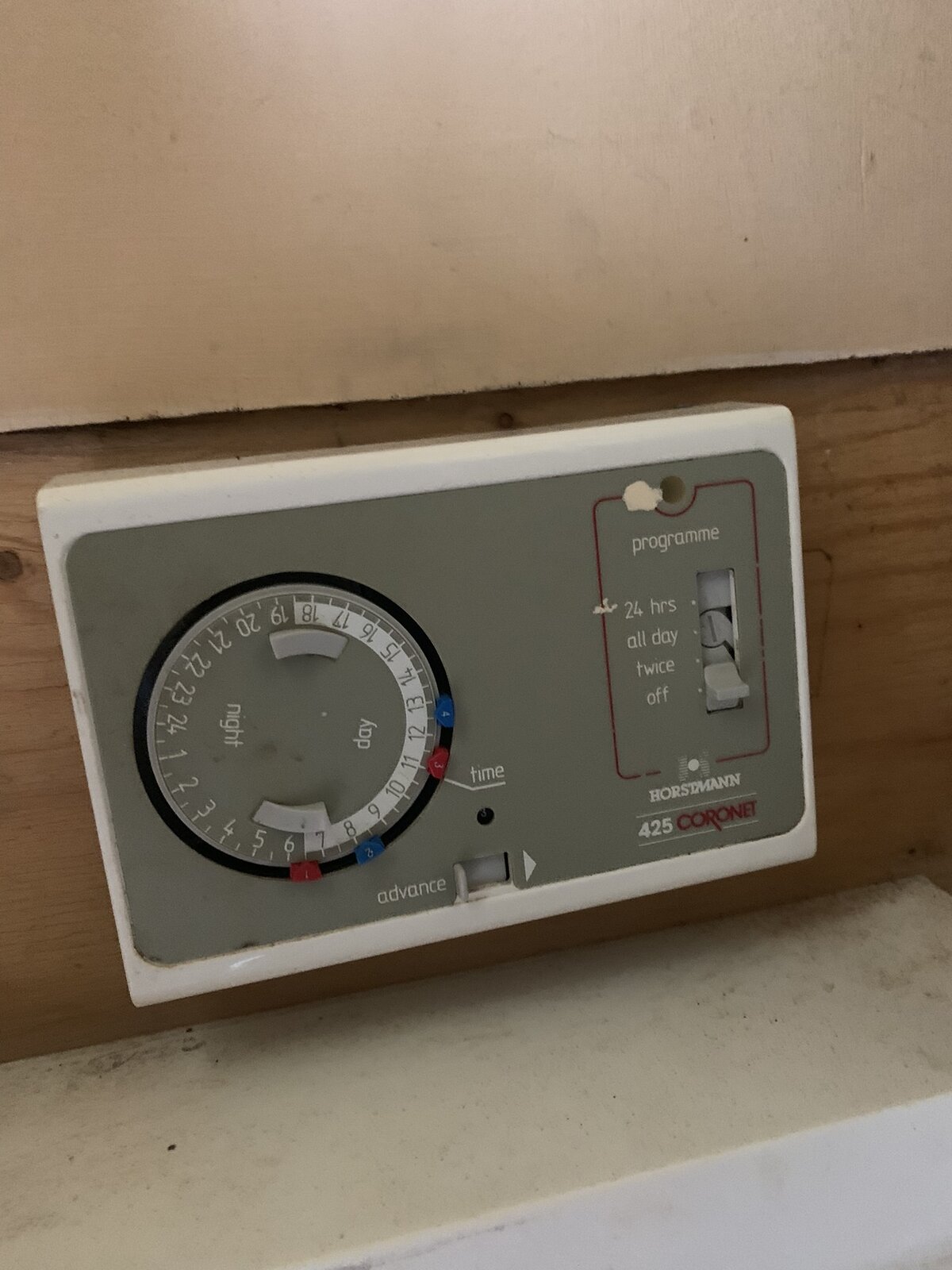

What central heating programmer can be replace the 425 coronet with onto existing back plate without rewiring. Thank you

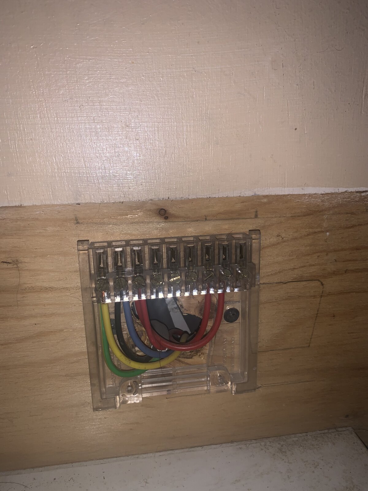

I believe the Horstmann/Secure ChannelPlus H17XL would fit on the existing backplate, without any wiring changes...
Although, could we have a photo of your backplate to confirm (isolating the power safely before removing it)?

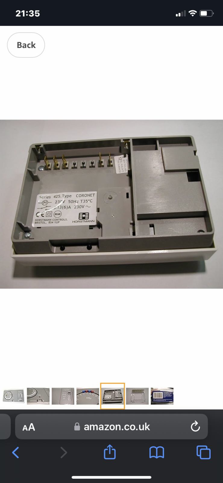

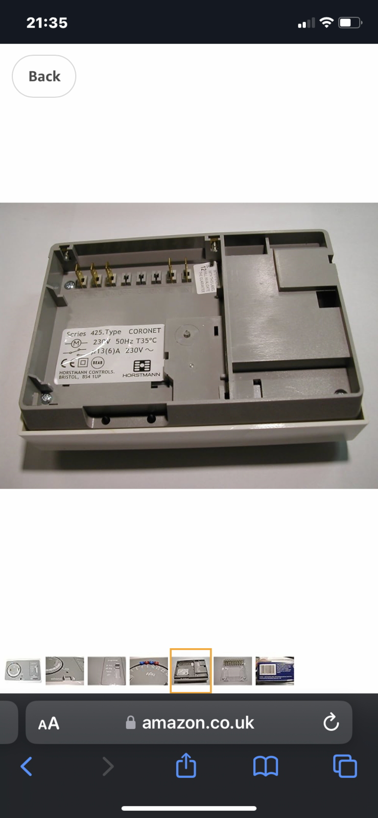

looking at instructions it looks same back plate
