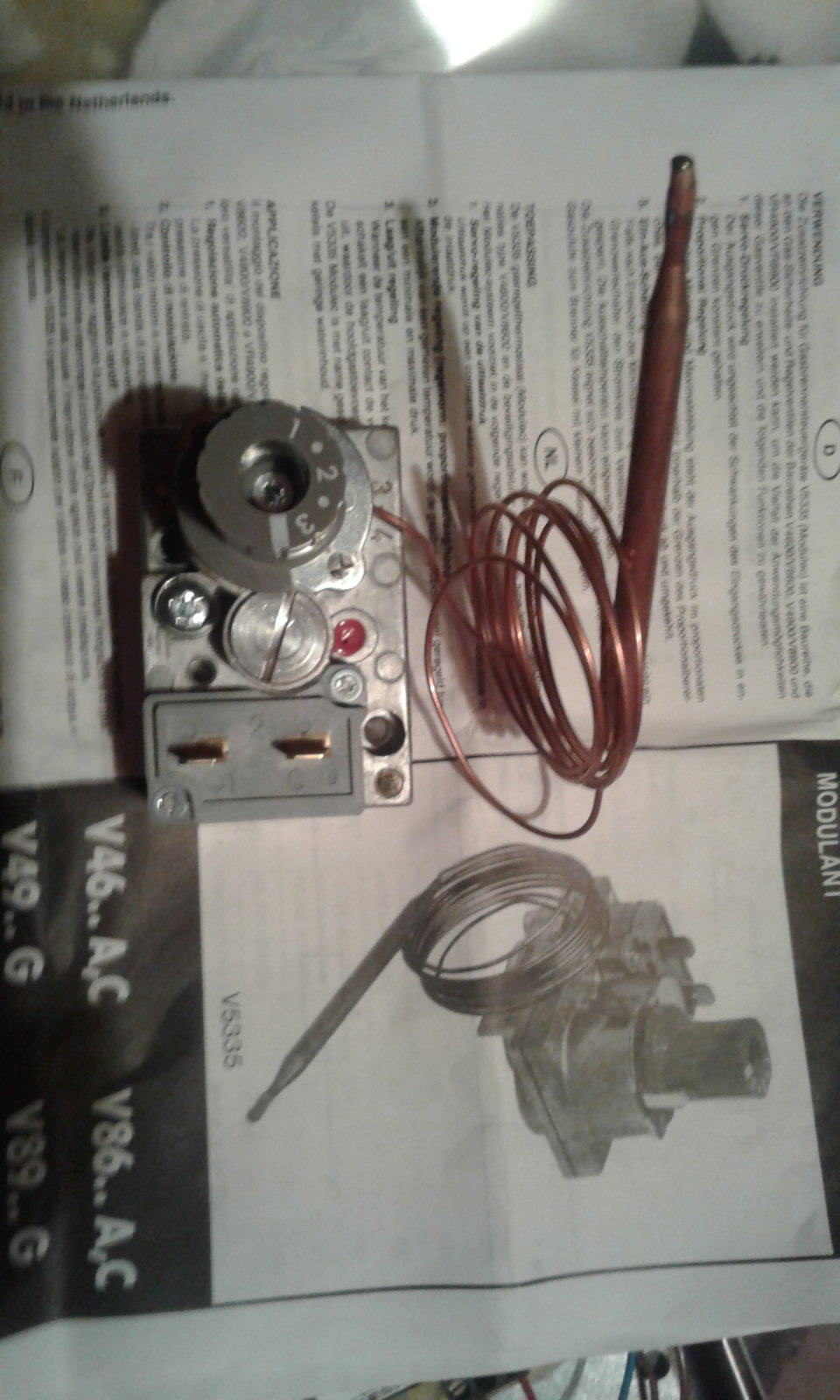

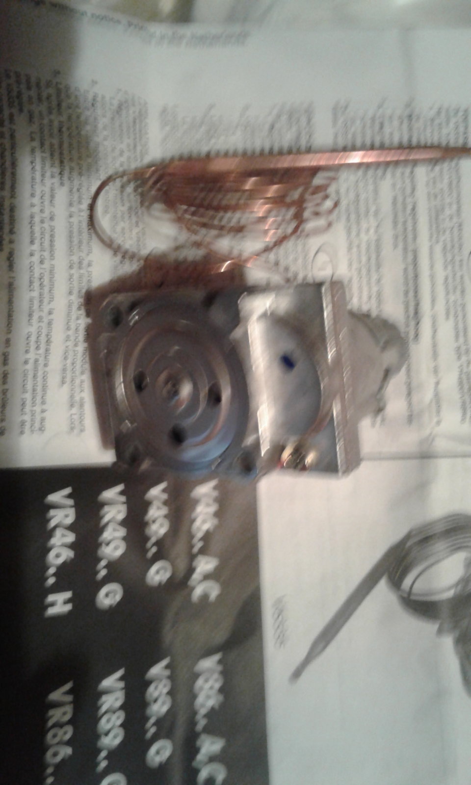

stem, the gas valve has what is called a modulec regulator, see pics
this acts as the boiler control stat. as temp increases full burner pressure 10mb is reduced instead of turning off gas valve, down to as low as 2mb. this device also controls pump overrun, hence the red wire. this is why all other ways of getting this boiler up and running will not work as the boiler was designed to. this is a bit like allen harts baxi platinum :cool:. ok it's 30 plus years old but this is part of the reason servowarm where always slagged off by the trade, they just couldn't work out how the boilers worked. remember no internet back then plus parts only available from servowarm at silly money
Ah right OK, that makes sense thanks for explaining. I learn something new (or should that be old in this case) everyday. In the photos though I can only see two electrical spade connections which I guess is the coil, plus the earth screw on the Modulec. Where's the third?

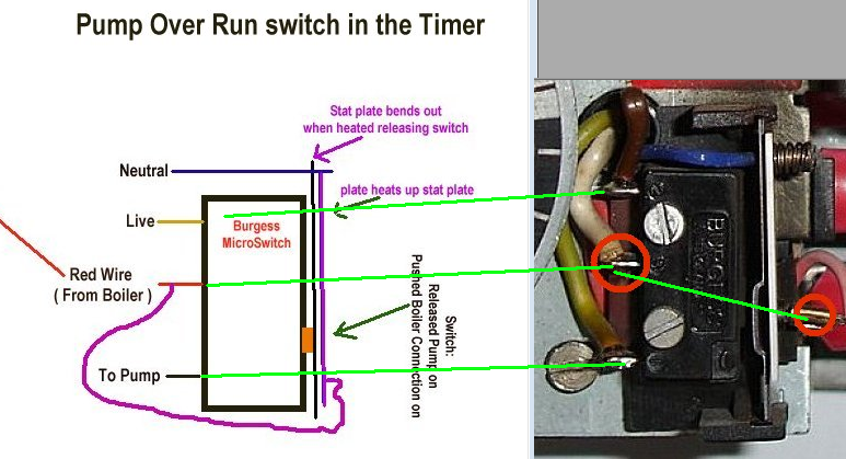

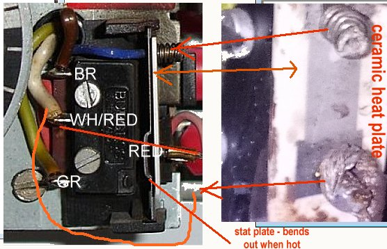

Stem: yes the red wire from gas valve is connected to the existing timer terminal (2) solenoid. which then, from this terminal, a white wire
is wired to the 2nd terminal of microswitch and relayed to ceramic heating place. I have linked the actual positions with green lines between the
drawing and photo. this 2nd terminal is switched on when the boiler is cold as the stat plate is keeping the button down /on.
within a min of firing up the the plate heats up and bows outwards releasing the button, which disconnects the 2nd terninal, and simultaneous switch on the bottom terminal ( permanent L) to the pump
This simple unit with just a 3 pieces of small parts with a £2 microswitch, much less than the elite 50 converter is much more complicated and larger.
( I am not sure what Voltage or Amp output the red wire is. for the hot plate .. if it is possible to buy the ceramic plate then
it would be quite possible to build the same overrun as it is only a simple unit.) I could remove it and put it in an enclosure, but as I said
whole switch unit is tatty .... anyone knows anything of this heating plate?
GAS VALVE to Programmer Solenoid terminal:
I am not sure.. but I have a feeling that this red wire from the gas value maybe a DC current instead of AC ? the ceramic plate has a grey metalic conductor strip ( see image above) that heats up the stat plate next to it... Or probably the wire supplies a very low Amp AC.. anyone throw a light opon this??

The metal arm on those is just the trigger, the metal plate on the pump overrun switch is bi-metallic, which when heated by a small electric element bends and triggers the microswitch.
In that case, as it is just a connector for the two wires and there is no other connection inside the existing timeswitch, then you could wire in your new timeswitch as below, leaving the old timeswitch, and all of other existing wires, including its 230v supply in place exactly as they are. That way, the rest of the circuit doesn't change, and the pump overrun mechanism & microswitch will remain exactly as it is. You would just be changing the timer part of the circuit.
The new timer would have to be mounted on the wall at the side of the boiler rather than inside it, and whilst the old timer physically remains in place, it won't have any time control of the boiler anymore.
The conversion kit would of course, be a better long term proposition.
