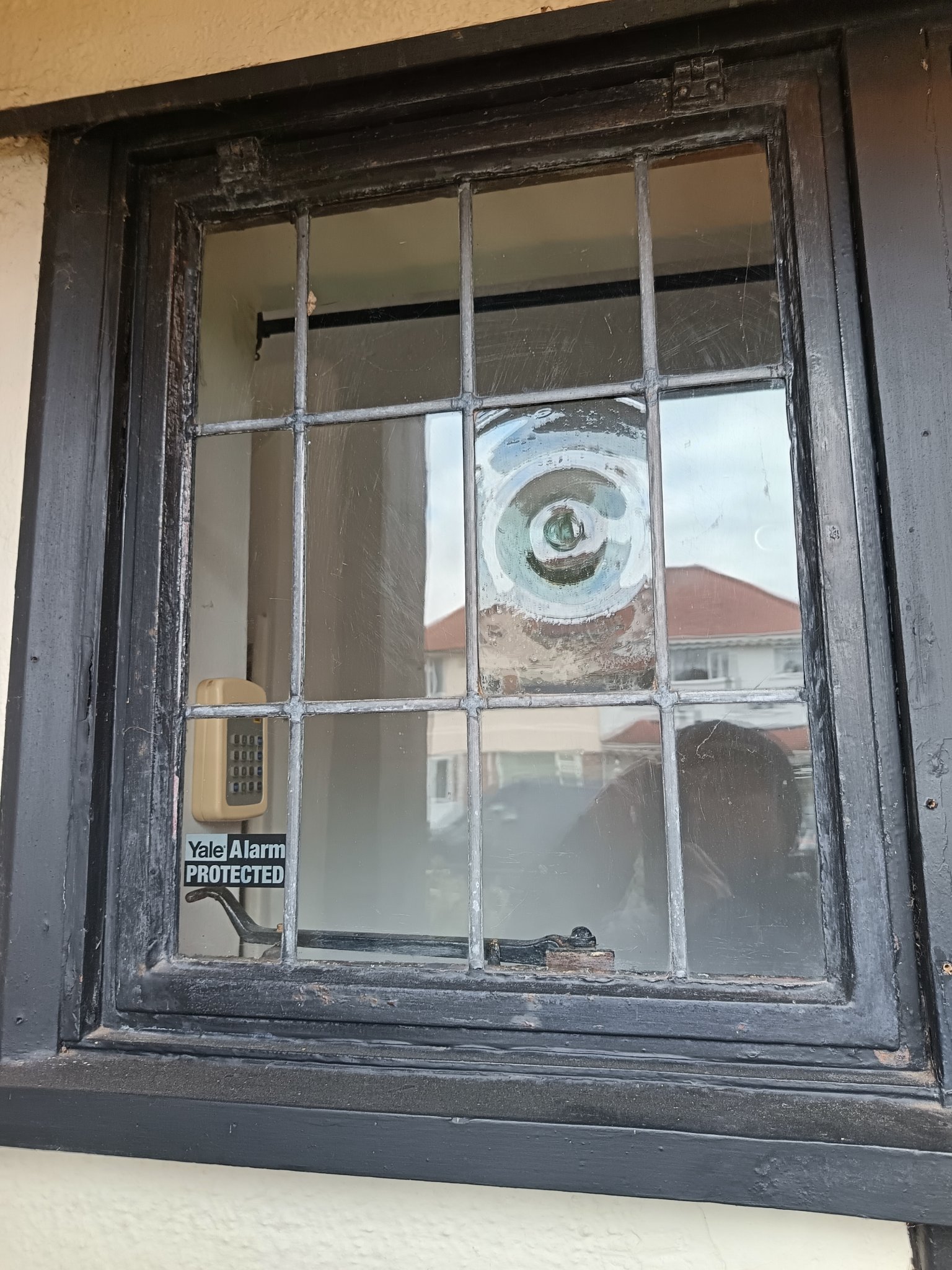

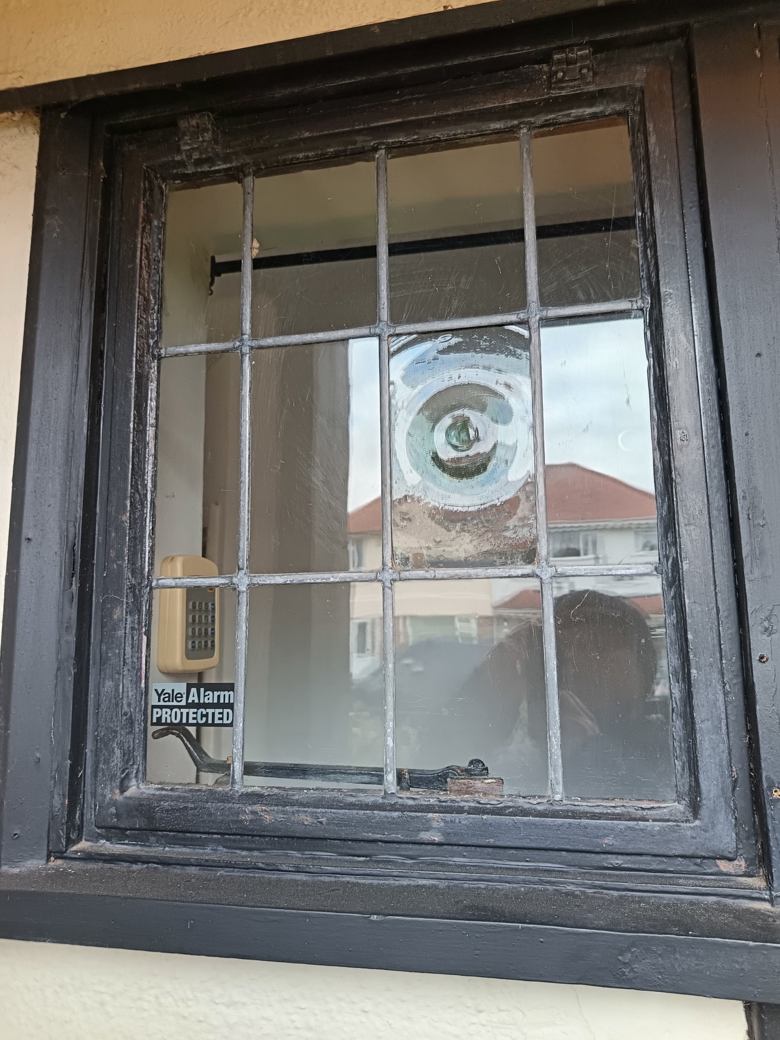

Looking at a property which was built 1920ish and has black painted timber frame lead lined windows, many of them have rot.
Attached are some examples.
Are we looking at replacements or fixing? What are the costs? If replacement, can you replace with double glazed versions? It's not listed or in a conservation area
You can repair wood with products like dry flex resin but maybe new windows would be better.
Lead is just stuck on and that can be done after windows are fitted. Unless you want the lead inside double glazing.
My neighbour leaded their windows but when they sold house the new people ripped it off.
I heard windows start at £500 each fitted as a guide. 10 windows is 5k. Probably gone up now. It's cheaper in January I heard as now is peak season

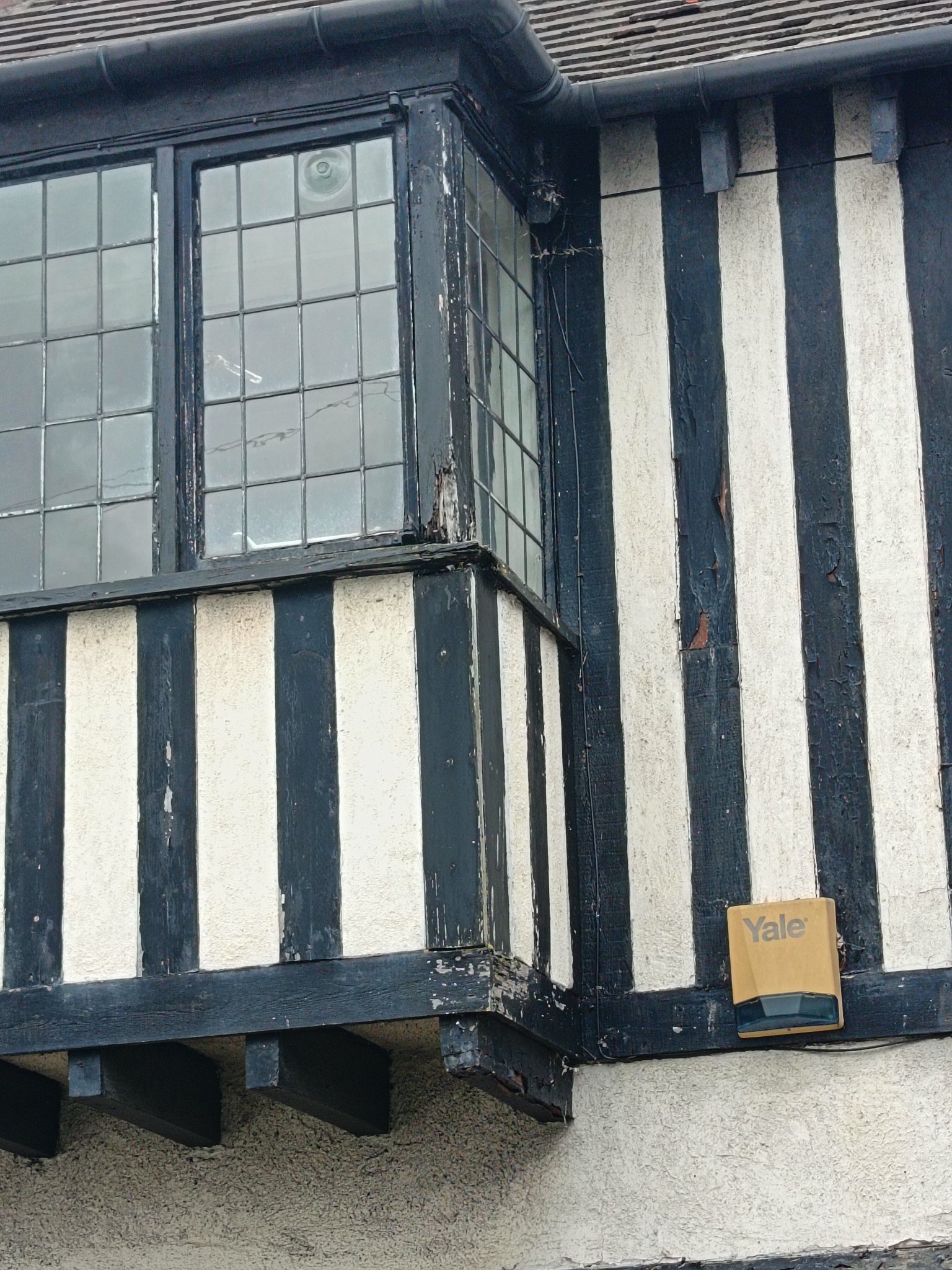

It doesn't look stuck on! Are you sure? Here's a closer pic
Maybe a closer pic of the actual windows you want to replace?

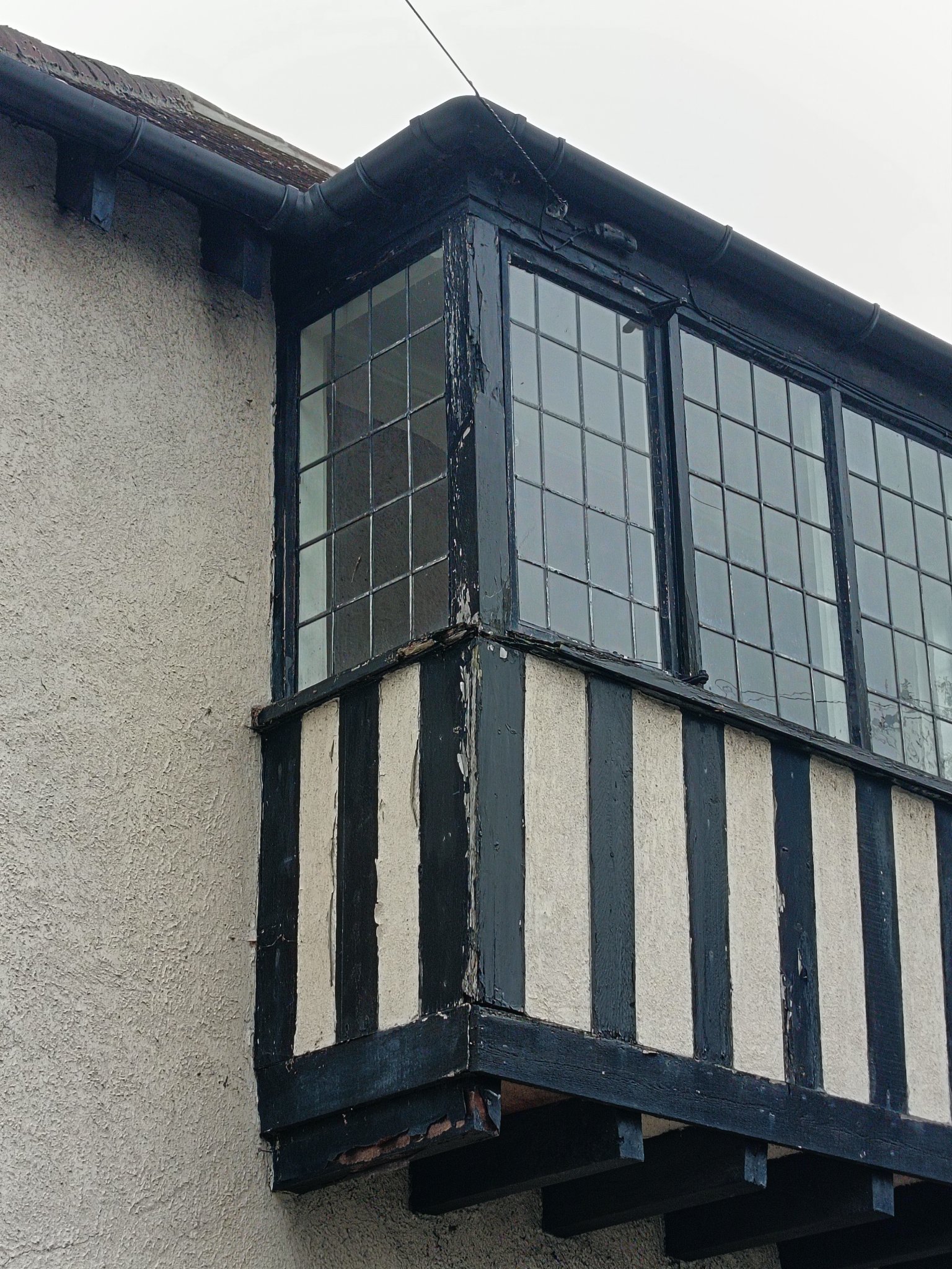

The one at the top is the most problematic as it's a bay window. Here's another one from the other side . You can see the rot at the bottom
That does look like traditional leadwork rather than ' sticky 'lead , that means every single pane is individual and youll be able to see the lead and came .
Depends how attached you are to the wooden windows really. We have used a carpenter to repair wooden windows in the past but he always says its not worth it in the long run, as when its completely rotted there is a lot of damage you can't see, but that's a decision for and depends on your budget. If you can't avoid new windows then I'd repair them but start saving up for new ones, which, if you still want the leadwork, will utilise the ' sticky ' lead mention previously ( which can be soldered to create the same ' crossover ' look

I couldn't care less tbh, I'd rather make the house more efficient. It's not like it's a Tudor house! Happy to patch repair in the near term and replace them longer term.
As such, do modern equivalent look decent? What are the options?
If you get the joints soldered they dont look too bad. You will always be able to tell the difference as they are in double glazed units. I'd advise speaking to where ever you intend to get the replacements from and get a sample of the leadwork, you can see exactly what you are getting then

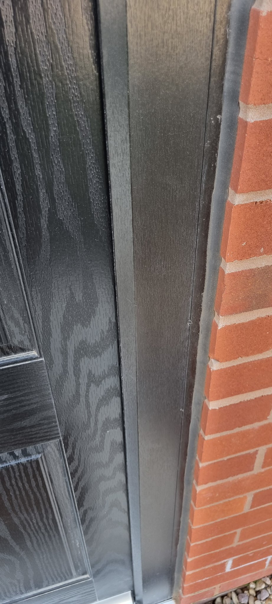

Here's anl perfect example I looked at today, black door and supposedly a black frame....
Personally I would avoid black uPVC altogether. The thermal expansion of uPVC is huge (0.07-0.08mm/m/degree), and black windows just get hotter which exacerbates the problem. e.g. a 1m tall window, with a 50 degree range (say -10 in a very cold winter, to a surface temp of 40 degrees with the sun beating down) will grow and shrink 4mm over that temperature range.
It's a simple window style to reproduce. Get a local joinery company to make some up in Accoya - they'll last for ever. As to glazing, I would be tempted to reproduce what is there but in DG. To me a 1920's house with 2020's glazing just looks wrong. If you have any empathy with the architecture then I would restore sympathetically to the period of the house.
