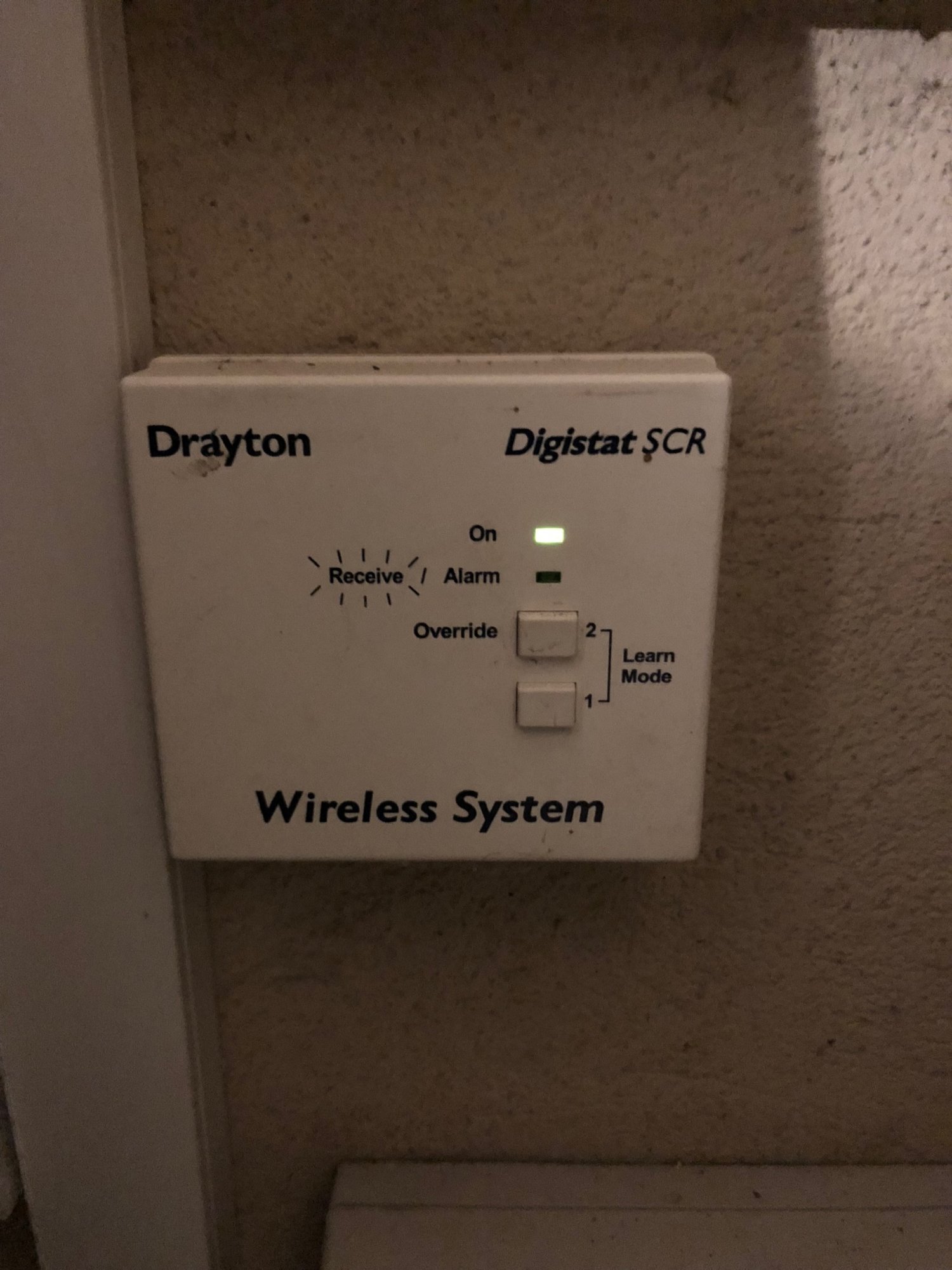

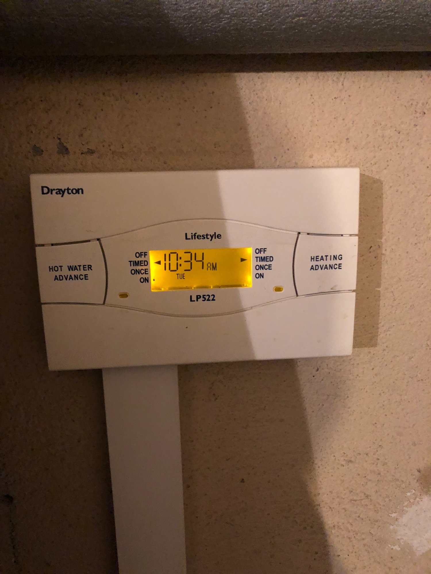

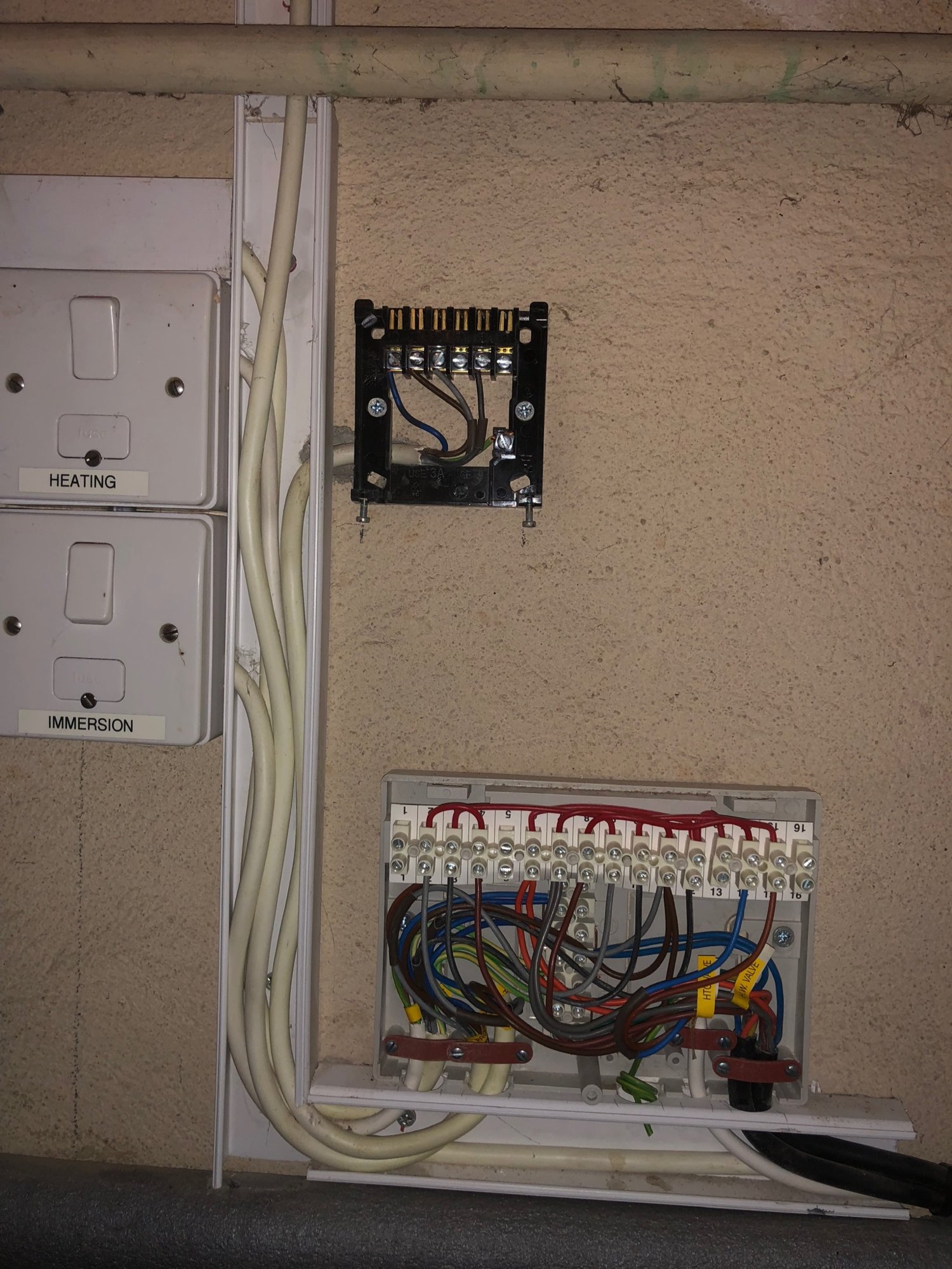

Looking for advice in swapping out existing LP522 and Drayton Digistat SCR for Hive 2 Hot Water & Temp controller.
Current set up is LP522 goes into junction box as does the connection from the SCR. See pics for current set up..
Appreciate any advice On how to do this please.
Thanks KSI

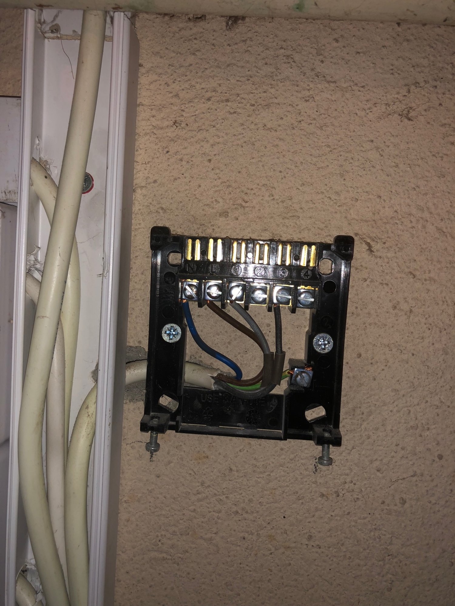

LP522 wiring
Digistat SCR and Junction box
SCR wiring

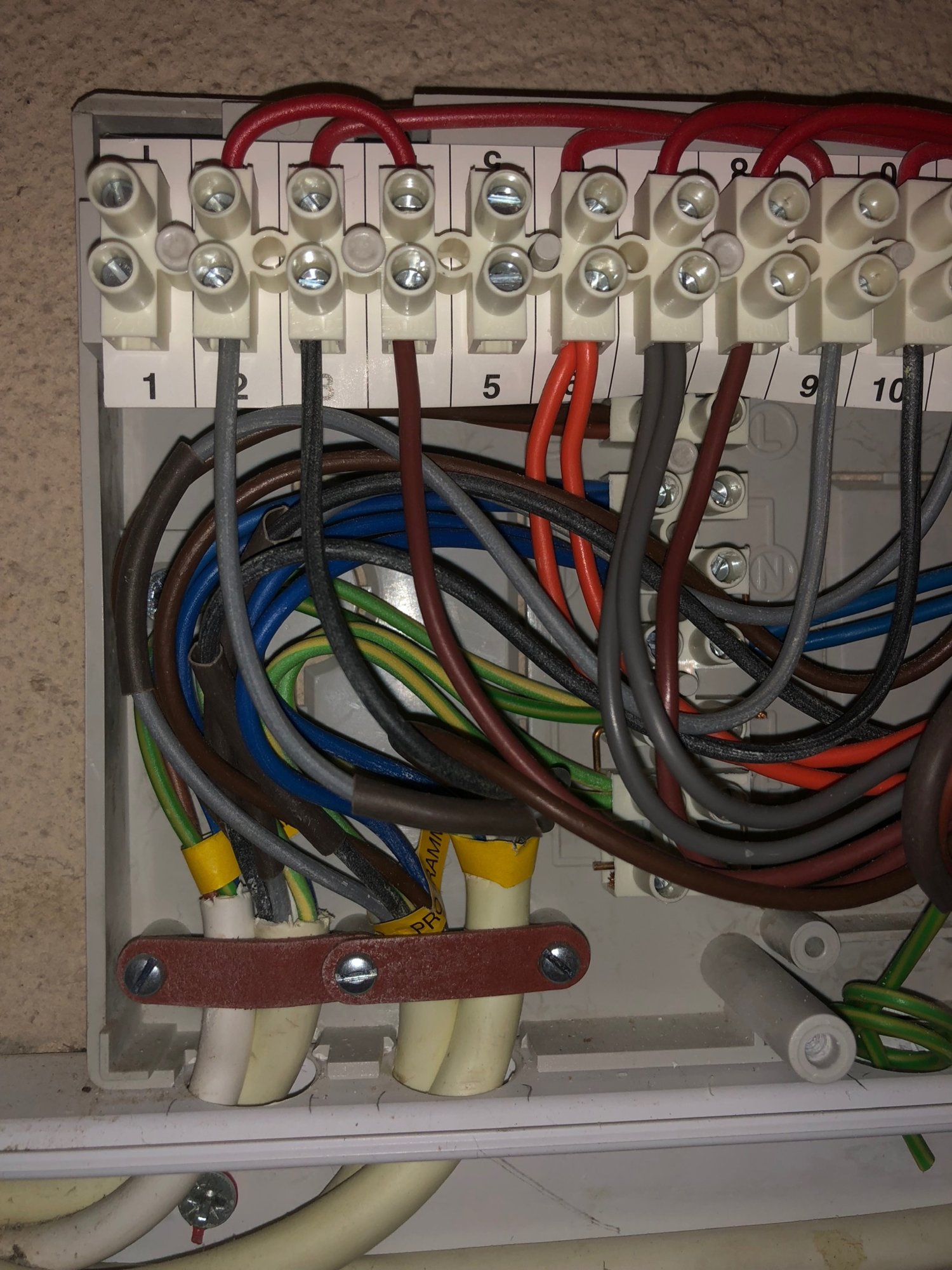

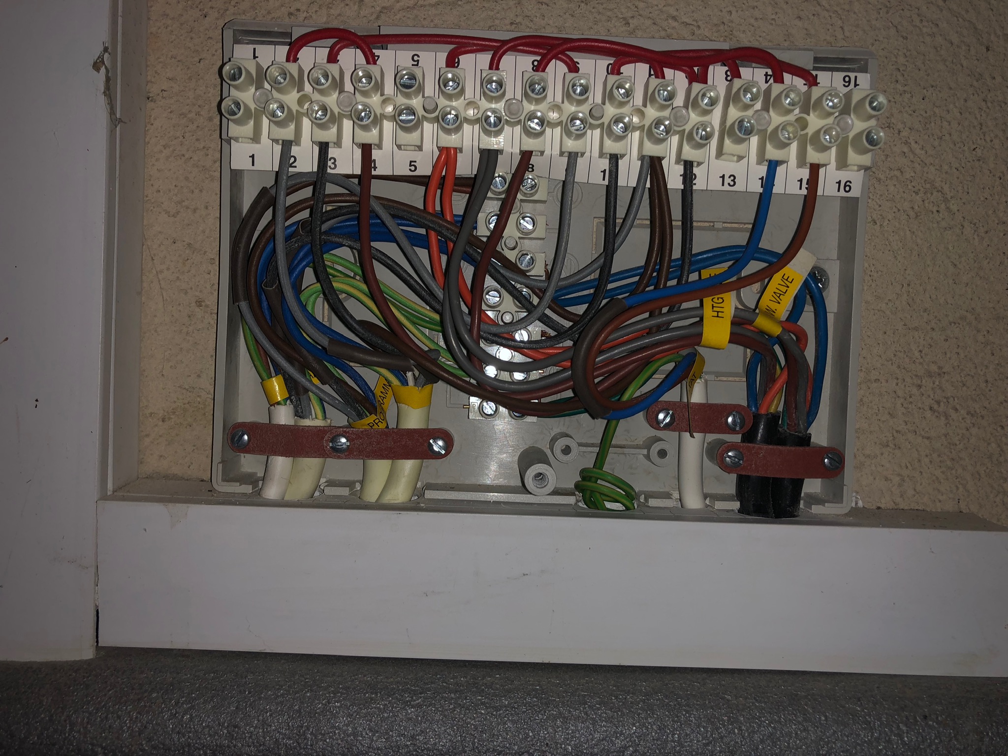

Close up of junction box. SCR cable furthest right, LP522 cables next to it to left

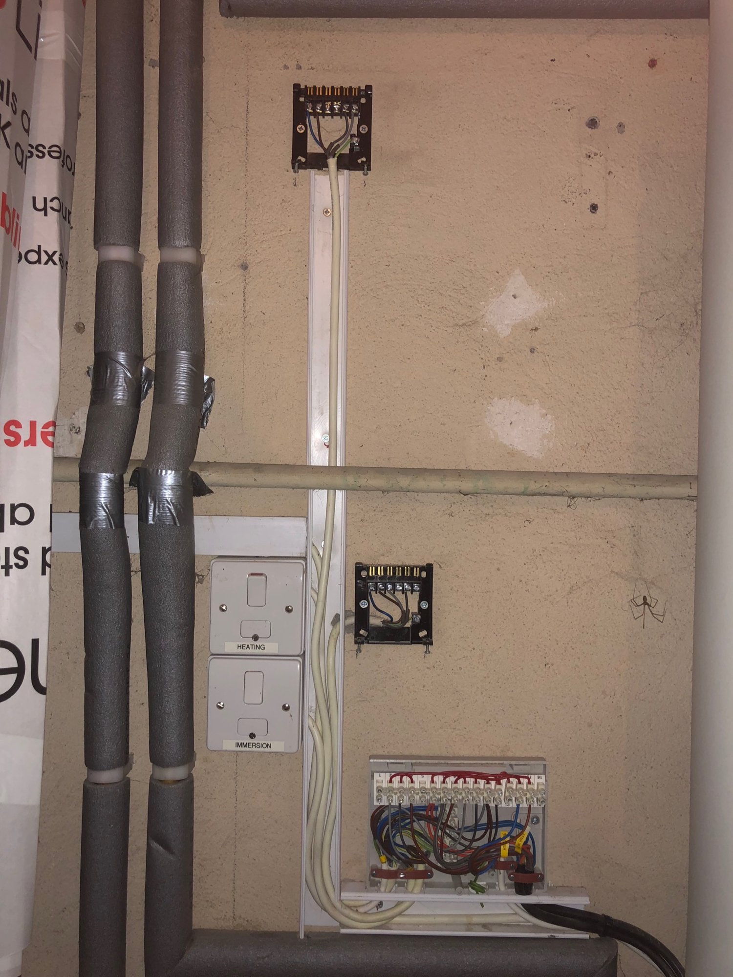

Junction box full view

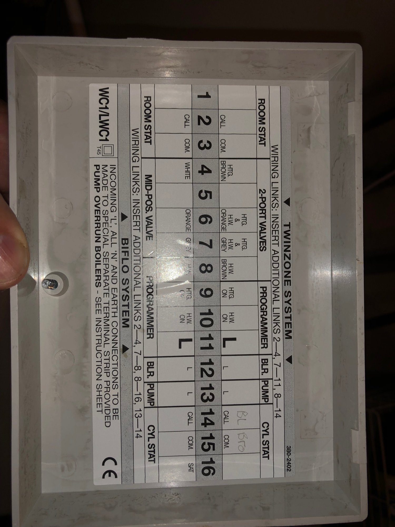

Junction box wiring layout
The programmer wiring is exactly the same as the Hive 2 - straight swap.
Remove the digistat cable completely from the wiring centre.
Then put a link wire between terminals 2 and 3
Thanks EFLImpudence.
Just so I am sure. If I Wire the Hive Dual control as per attached pic all will be good?
No. The link between 2 and 3 is at the wiring centre - not the Hive.
Otherwise correct.
Won't the Hive just fit on the existing programmer back plate?
You can change it if you want.
About to do this tomorrow (replacing an LF722 & Digistat SCR) All looks fairly simple. Just a swap out and then removal of the Digistat. Can I just ask out of interest why the link between 2 + 3 (just in case my junction box differs to the one above)?
