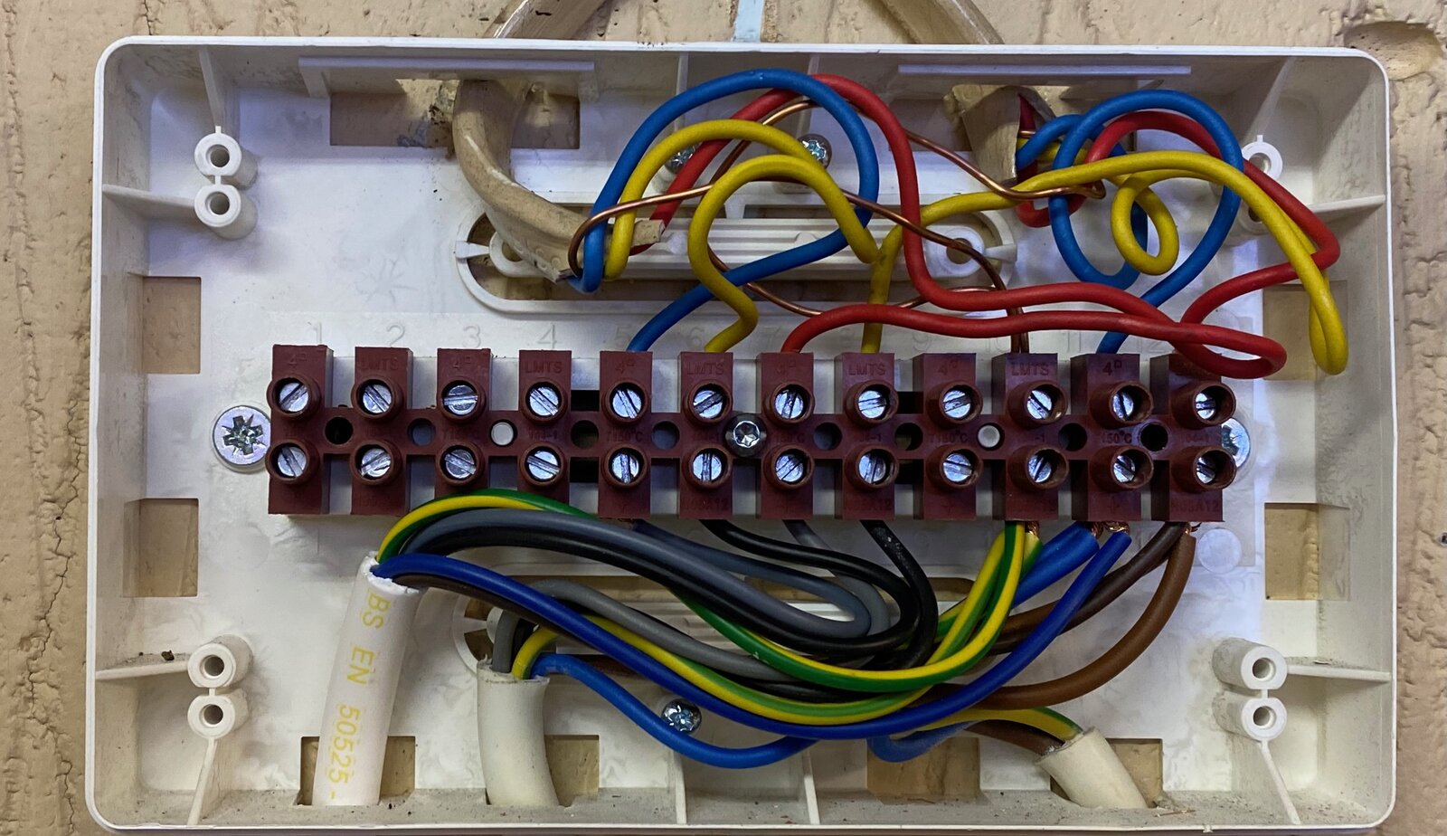

Hi
We have a Hive WPT1 non smart thermostat and I want to replace with a Smart one, I was hoping to do Tado but I am happy to stick with Hive it it makes it easier. My aim is to get the Smart radiator valves to control heating better round the house.
Attached is our current wiring but if I am replacing an existing Hive with a new smart version (Hive/Tado), would it not be a like for like replacement in terms of cables coming INTO this bundle?
We have a gravity fed pumped CH system with a system boiler and hot water cylinder upstairs.
Take a picture of the thermostat wiring, if it has a diagram on it that would be handy as well
If I recall correctly, the BG WPT1 has a receiver that would be a direct swap out with a Hive receiver, fitting on the same backplate, with no wiring changes.
