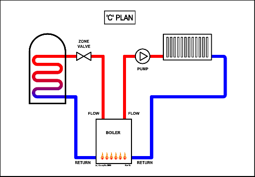

Based on your existing controls, you probably have a pumped central heating, with gravity circulation of hot water system. With this type of installation it is not be possible to have the central heating 'on' without the hot water also being 'on' at the same time.
When hot water is required the boiler operates, and hot water circulates naturally through the hot water cylinder to heat it up. When heating is required the pump starts and circulates water through the radiators. However, the hot water also has to remain 'on' to keep the boiler running. In this case you can still fit a Hive, but you won't be able to use all of its features.
Fig 1. Pumped central heating, with gravity circulation of hot water. (Yours probably won't have the zone valve fitted)

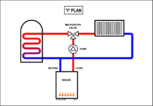

If I were you I would forget the Hive and instead, bring the system more up to date making it fully pumped by the addition of a motorised valve and hot water cylinder thermostat, which will give independent control of the heating and hot water, as well as making it more economical to run. You don't need to change the boiler.
Fig 2. Fully pumped Y-Plan system with 3 port motorised valve.
Fig 3. 3-Port motorised valve
EDIT
Once you have brought the system more 'up to date' you could then add a Hive to it and get all the available features.
