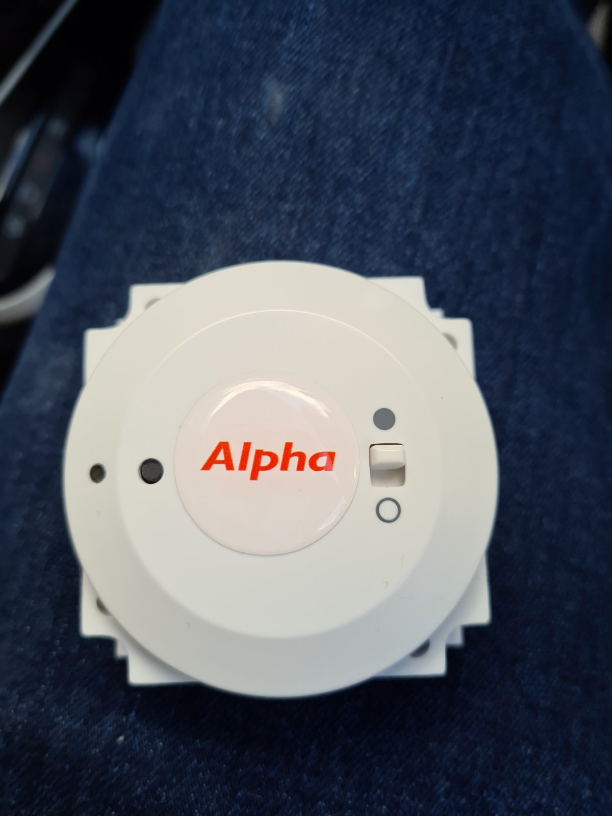

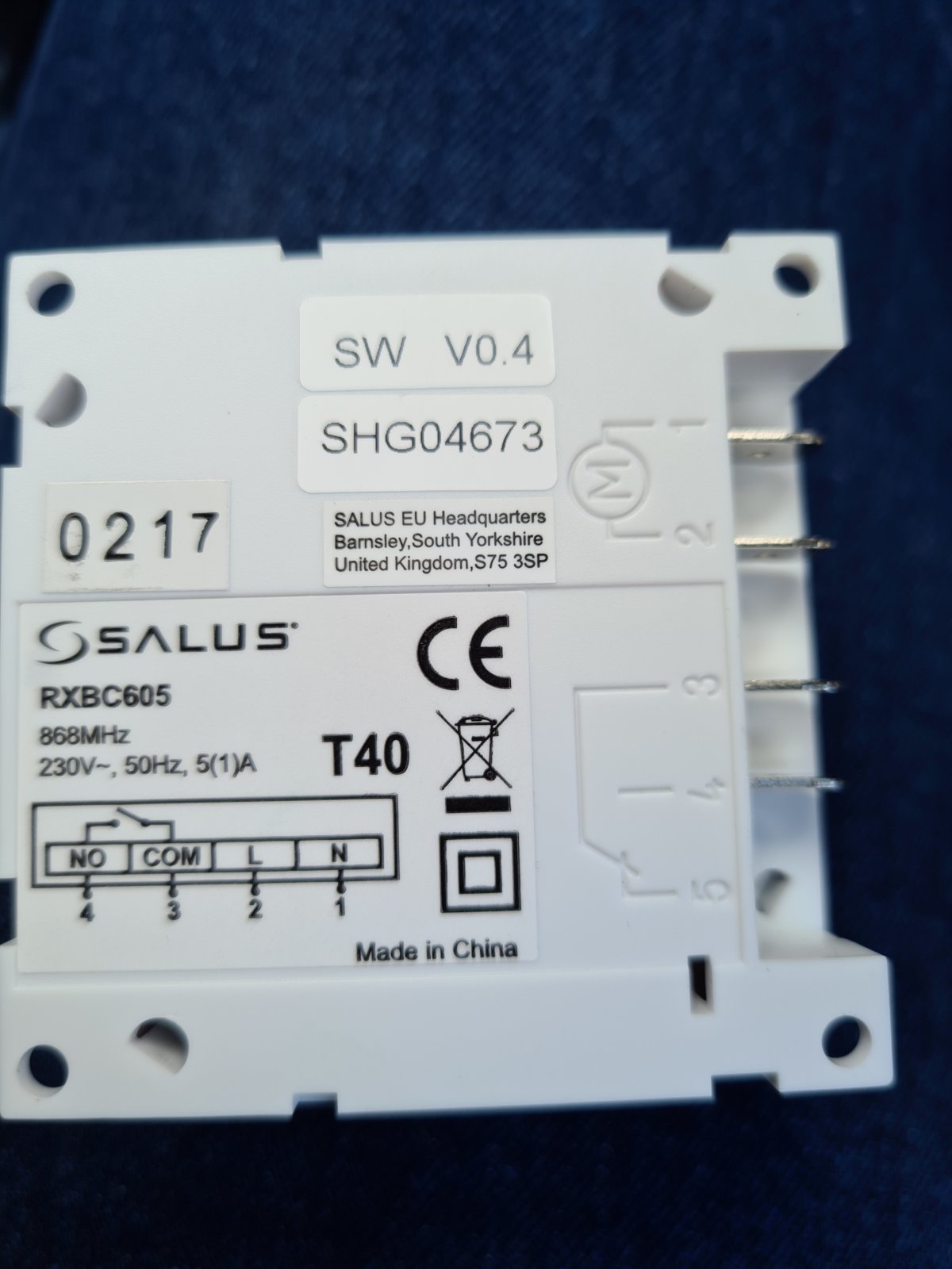

With these I use the wiring on the existing receiver that is built into the boiler, and take a cable to the Nest or Hive receiver, if you dont do this you will have to link out the existing on board receiver
Thanks Ian, is there a standard connector for that, or does this require modding/connecting/soldering wires to the boiler?

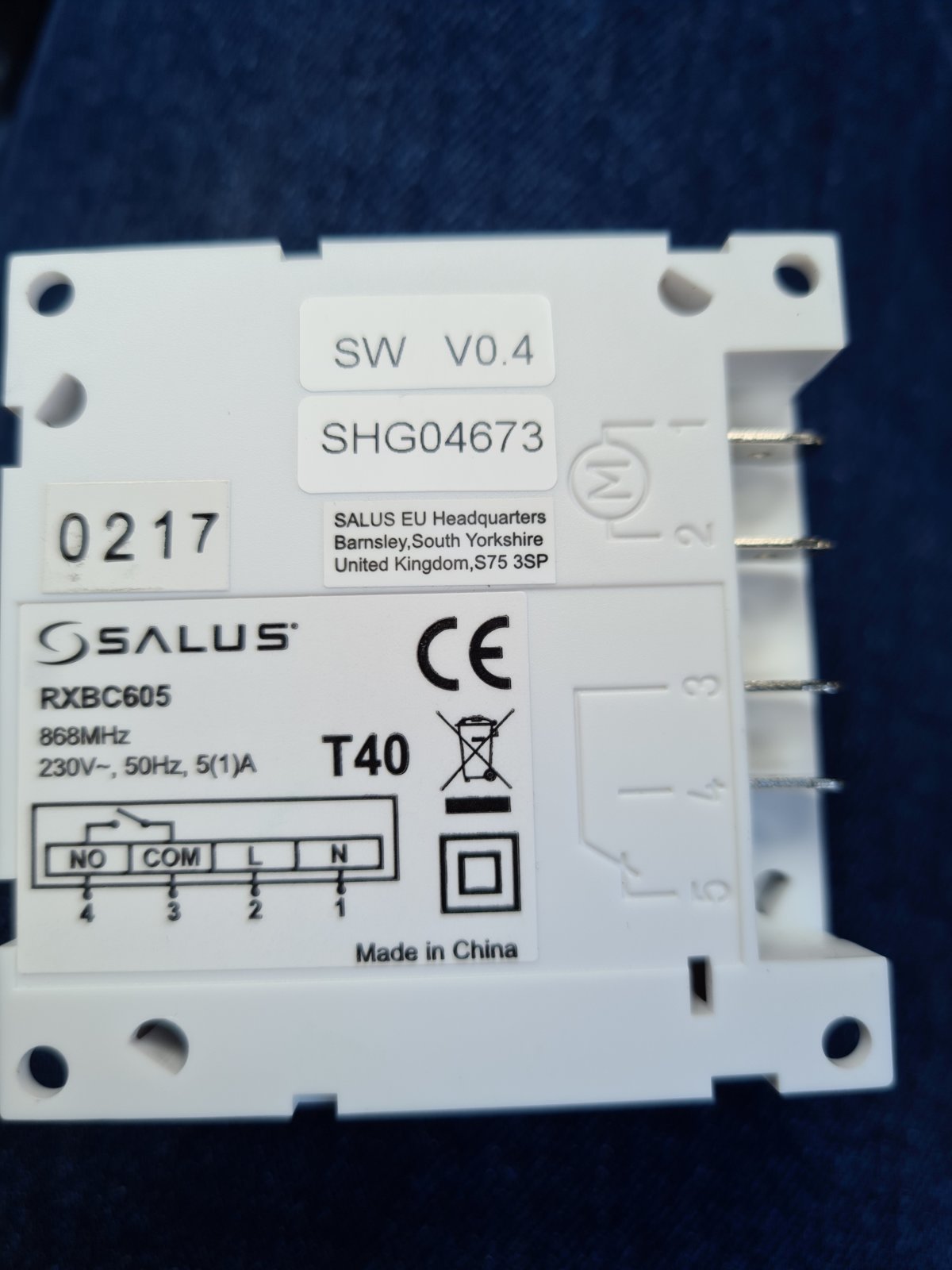

no need to solder anything,if you have crimping set then crimp male spades onto the wires if not just cut the existing wires and use common terminal block, the connections are obvious L to L , N to N and the other two wires to Com and NO on which device you choose, if you come back and say which one you have chosen I will give you numbers etc of which terminals on your device, but it will tell you what Com and NO are

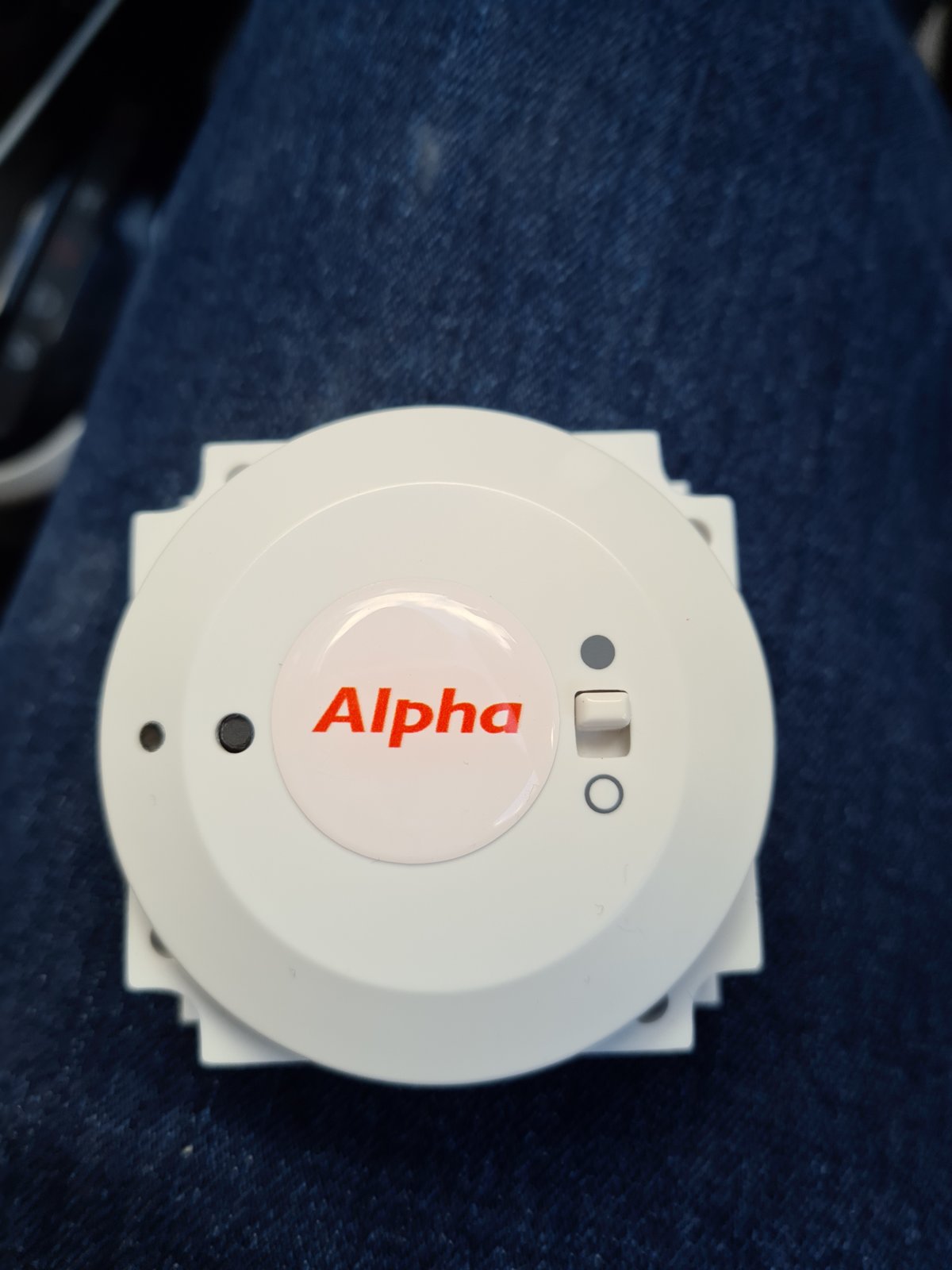

Thanks for all the help Ian, attaching pictures of the Alpha smartstat - to be honest, feels quote cheap and toyish!!!
Q1: Do I really gain anything from replacing this with a Nest - tbh, I've already ordered it so, its kind of a moot.question - physically, the Nest is a damn sight prettier!!.

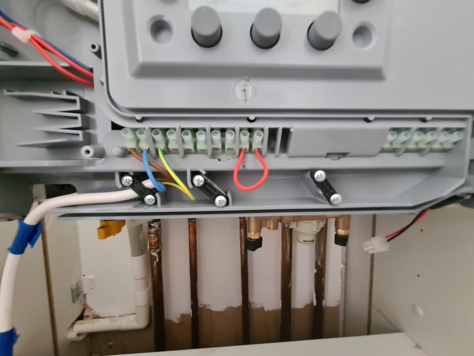

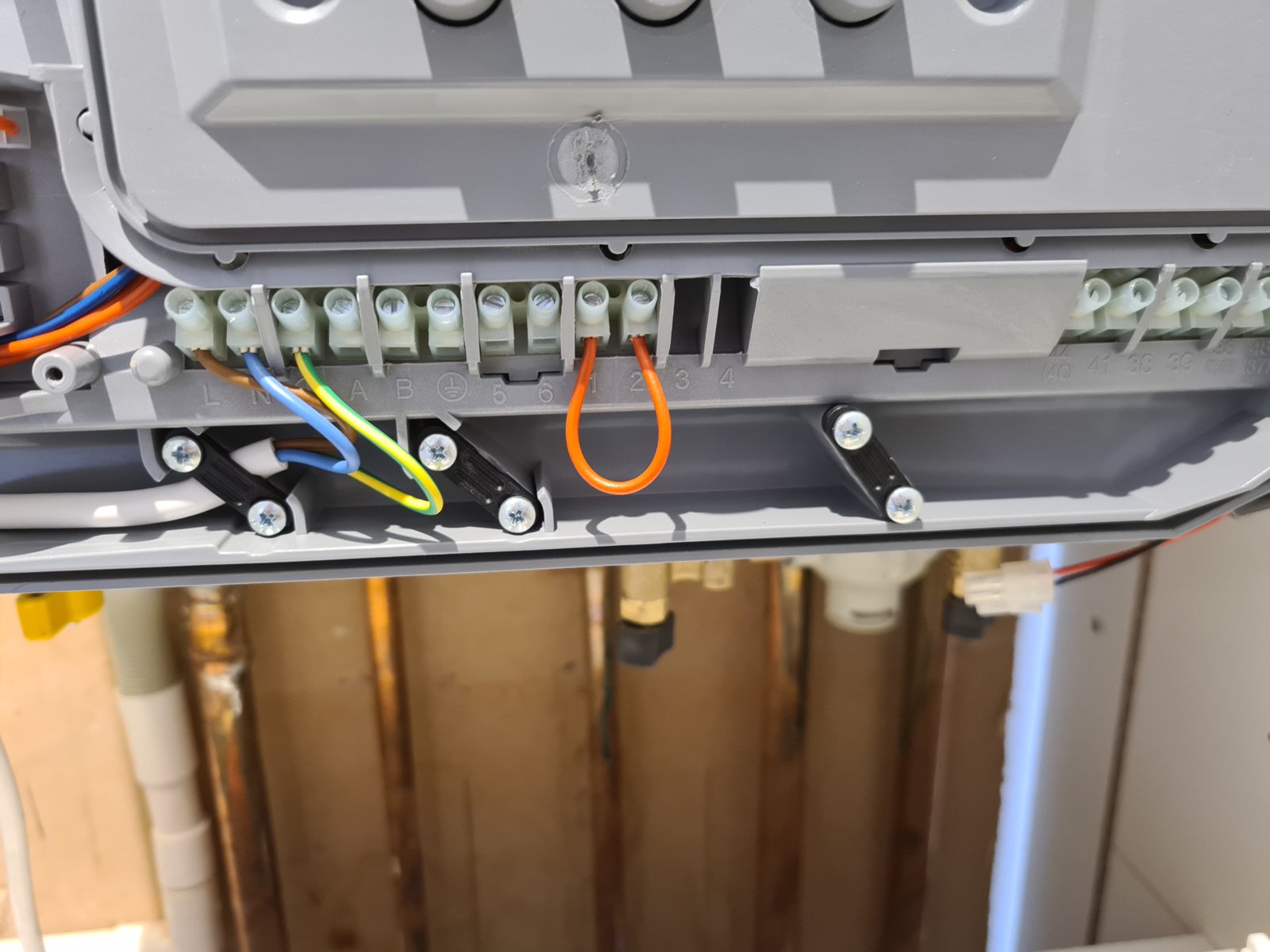

  1. So, with all the help around... Thanks Ian, I got a bit adventurousand opened up the boiler's front panel ( a first in my 2 score n 5 yrs!!!)...found it has nicely labelled connectors, including 2 for OpenTherm (see attached).
YouTube showed me the Heatlink has cnnxtors for opentherm as well..Ive been looking at nest for close to 2 yrs, but have only ever see the Apple-esque thermostat, wasnt wven aware there is a heatlink in the equation (which is why I was asking if I could run network cAble from the boiler to the Nest).
My Alpha combi"s manual has the following rather succinct instructions:
Open Therm type installation
Note: Before purchasing / installing Open Therm type controls from an alternative manufacturer, it is the installers
responsibility to ensure they are compatible with the Alpha boiler.
Remove the control panel as described in Section 5.10, if it has not already been removed.
Refer to controls manufacturer's installation instructions for specific mounting / fitting guidance.
Route the BUS communication wires along the groove in the control panel to the terminal block connections 41 and 44 (the
wires can be connected either way round).
Ensure the link wire between terminals 1 and 2 remains in place.
Replace the control panel cover in reverse order.
Note: Refer to parameter P7 (see Section 6.13) to select the correct parameter to allow the boiler to operate with alternative
control type '1'.
I think Im getting the hang of it now. With OpenTherm, Iunderstand it controls both water and CH, do I need to unloop anything, or just.connext the corresponding wires inckuding no 41 and 44?.

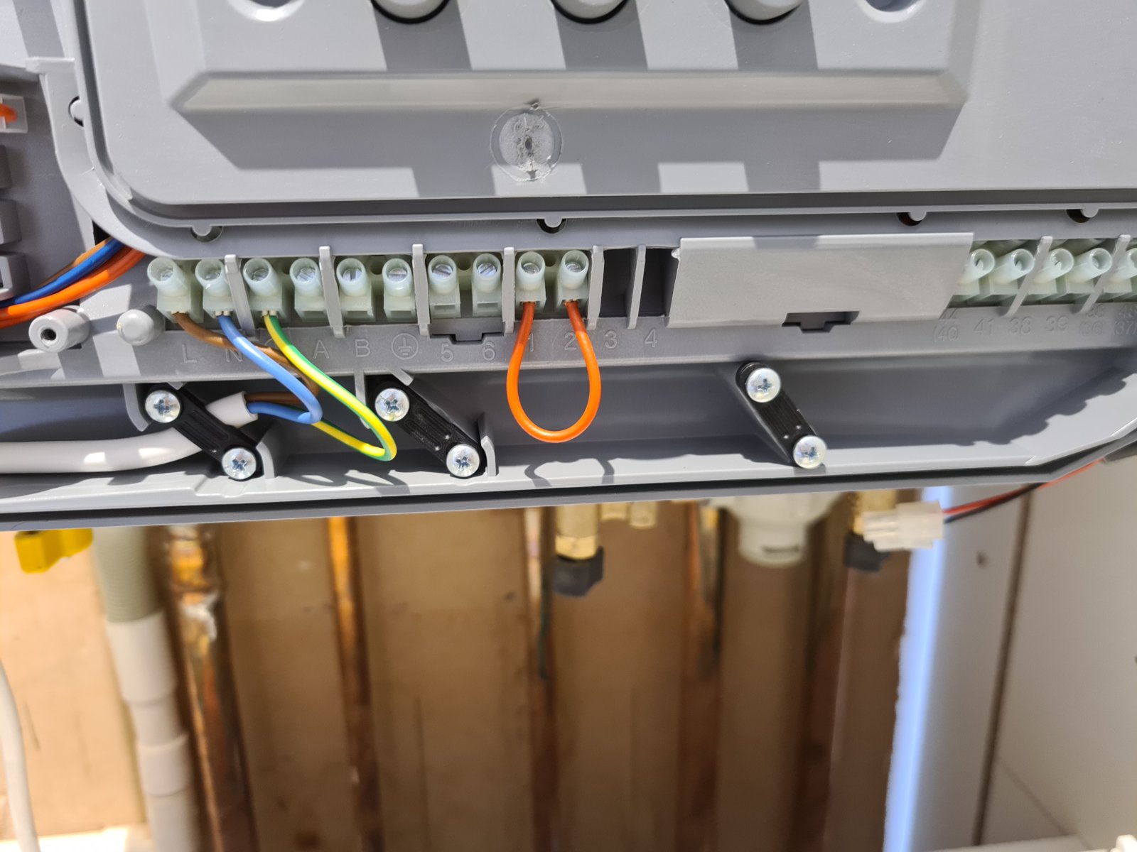

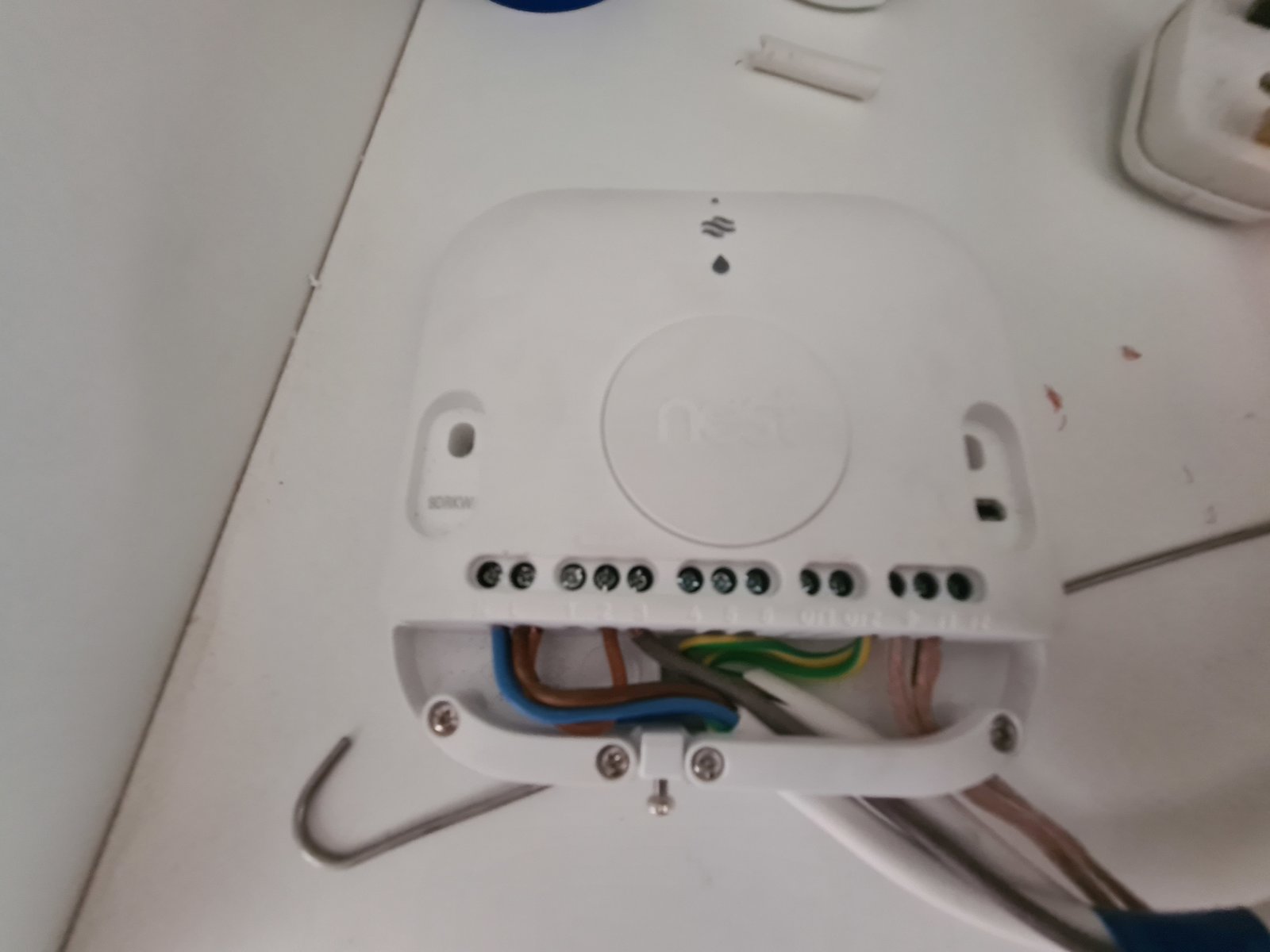

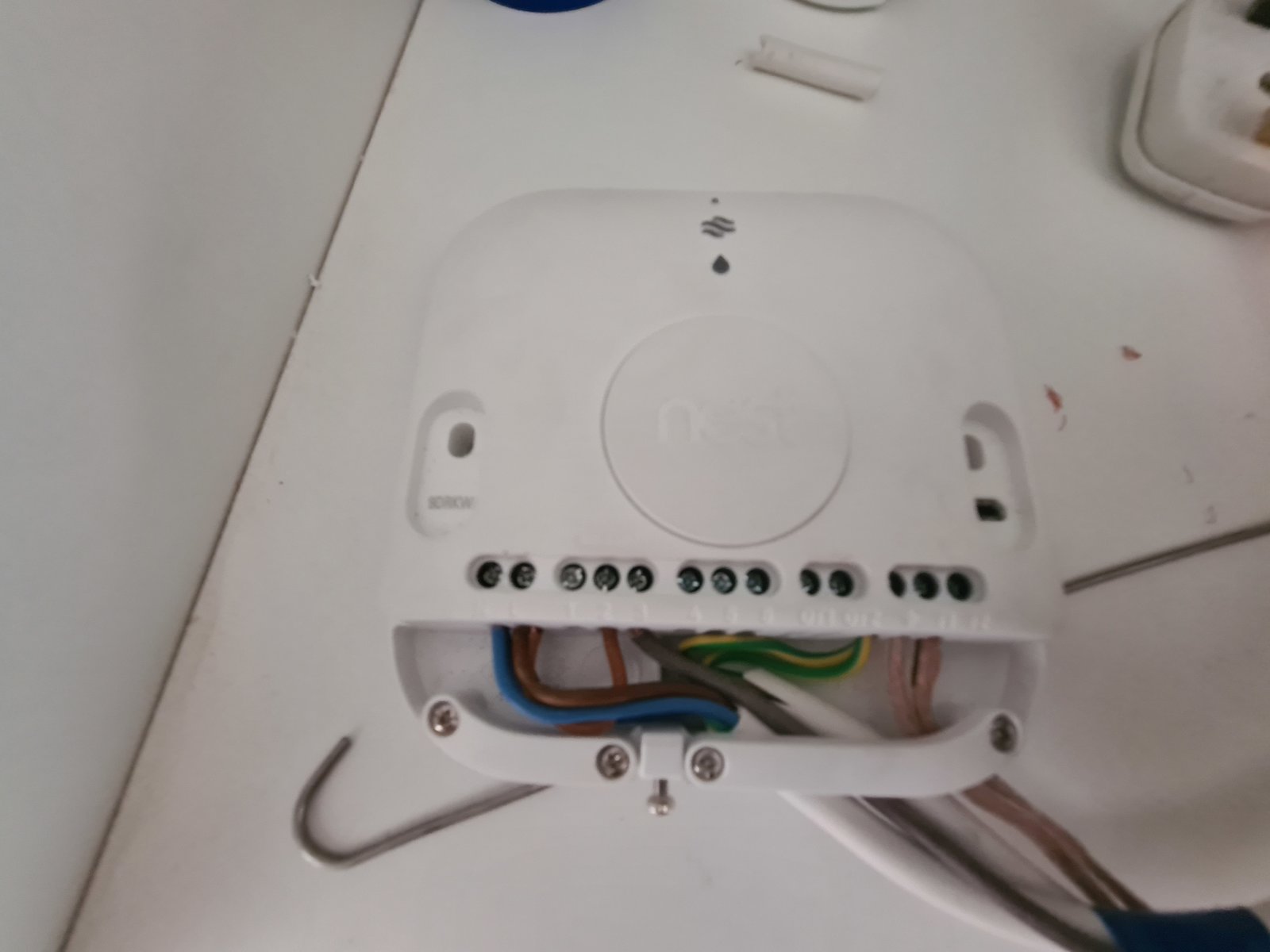

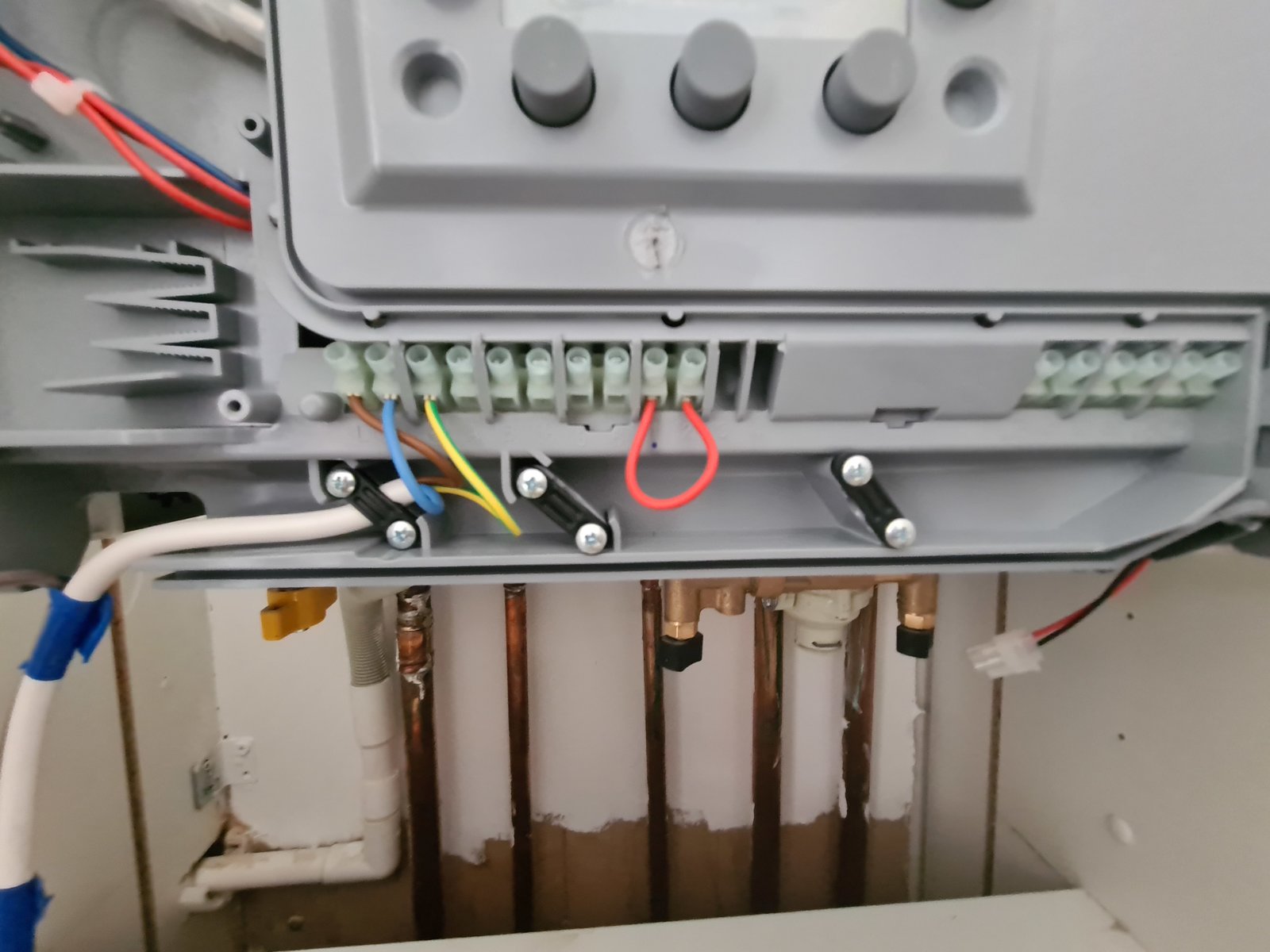

Hi Ian, finally got round.to connecting the Nest. My plumber is getting a bit stumped. Attaching pics, can you please advise which cables.go where?
