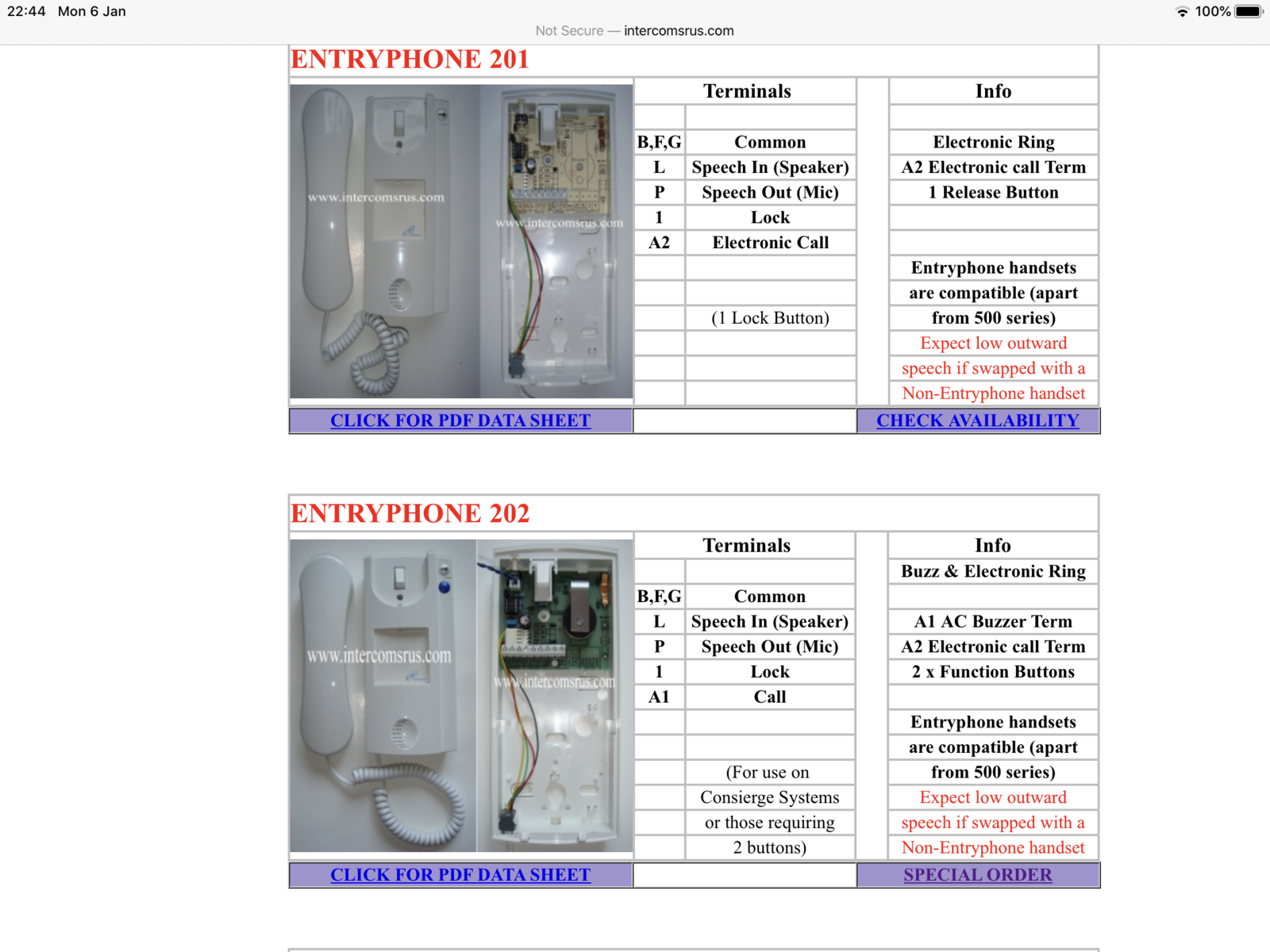

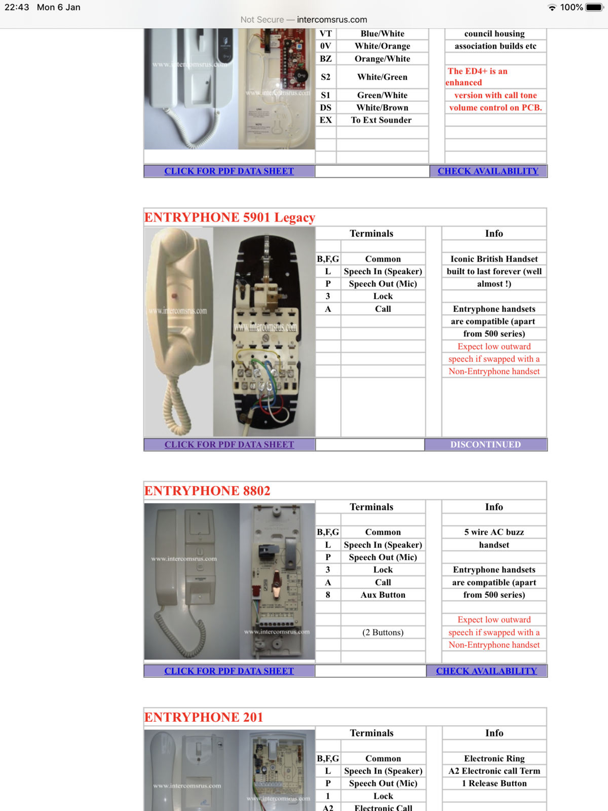

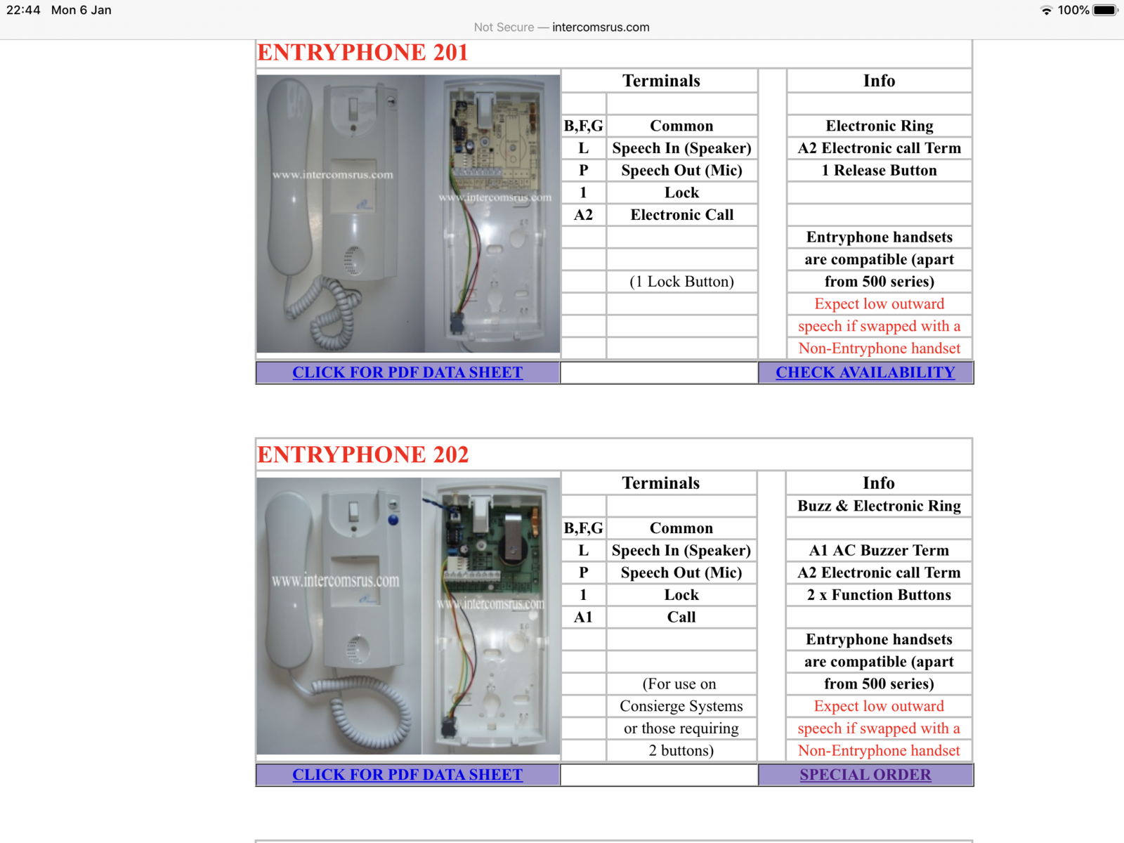

Evening all,
I am renovating a flat that currently has a London 5901 legacy phone, I have bought a FERMAX Citymax Universal to replace the London, can this be easily done? I did have a look at the diagram for the legacy but this does not align with what the FERMAX has. Please let me know thanks :)
Buy the correct part..... 9B8CE6E7-3456-46D7-974B-7111901967F7.pngA97FE0CC-EDDE-4C32-A6BC-0E666C6742AC.png
