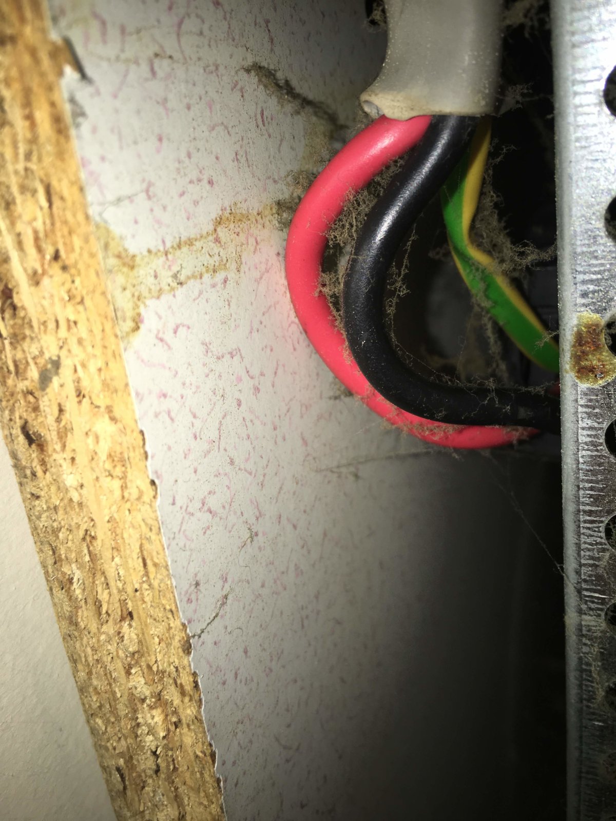

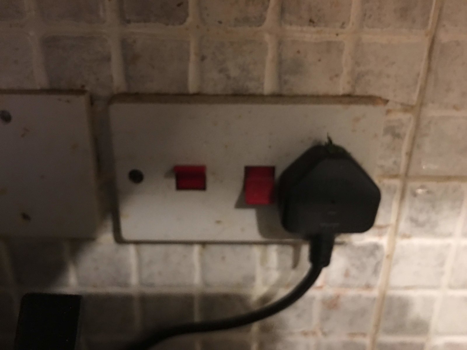

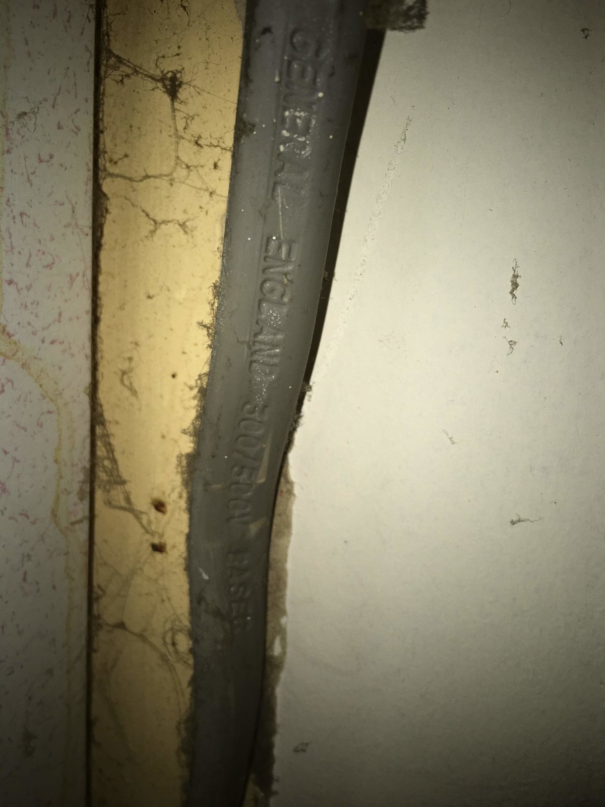

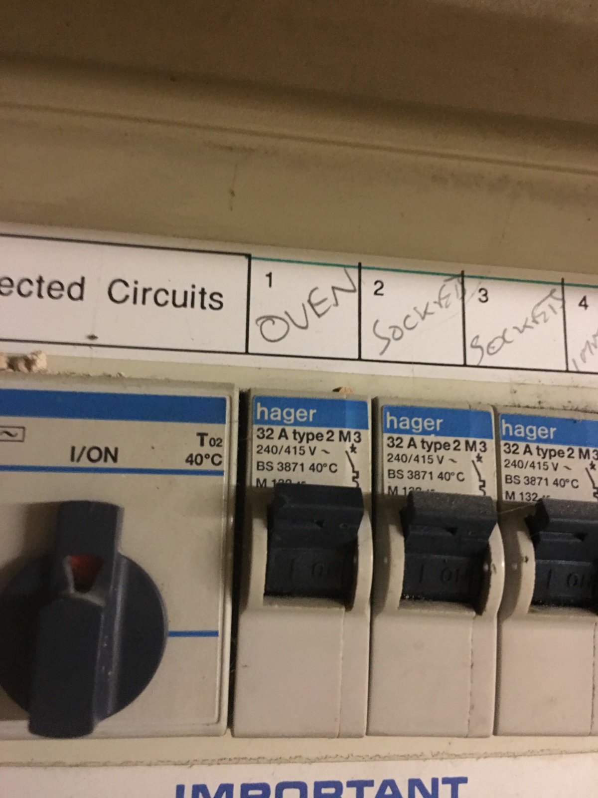

The current cable going to the oven is a really thick one, guessing 6 or higher maybe 10mm? which connects into a socket above the worktop (this socket also has a plug socket on it which i have my microwave plugged into) and then the thick cable goes back to the consumer unit into a 32amp fuse labelled just for the oven.
My question is, will the size of the cable be a problem, I was just going to remove the hardwired cable going into the old oven and wire it into a socket, I can then just plug the new oven into this new socket
Will this be ok given the size of the cable, I cant recall how it works in terms of size of cables and amped fuses, when the cable would burn before it trips etc.
I have attached some photos which will hopefully help show the current setup.

Having a cable that's thicker than what you need isn't a problem. Using one that's thinner would be !

The circuit should be RCD protected. Fitting socket directly behind the oven may impede the oven from going far enough back to the wall.

your picture appears to show cables going into the wall with no protective cover. This is wrong. Additionally, there appears to be a bare metal thing (perhaps studwork or lathing?) adjacent to or touching the wires. This is very worrying since they could conceivable become live if a wire comes loose.
If there is a square metal box in the wall, that the wires come out of, there probably is an incomplete Cooker Cable Outlet in it. If not, please add one. The connector block inside is sized to take those big cables; there is a clamp to prevent them pulling out, and a plastic protective cover. Crabtree is a good make.

The bare metal thing is part of the oven I believe where the cables go into in.
No it is not. Twin and earth cables can be plastered directly into the wall. A cover is nice but not required by the regs.
with no sheath on them, and no enclosure?
Nope.
Also, I see now it is laminated chipboard, probably the oven tower, and not the wall (thanks rocky)
