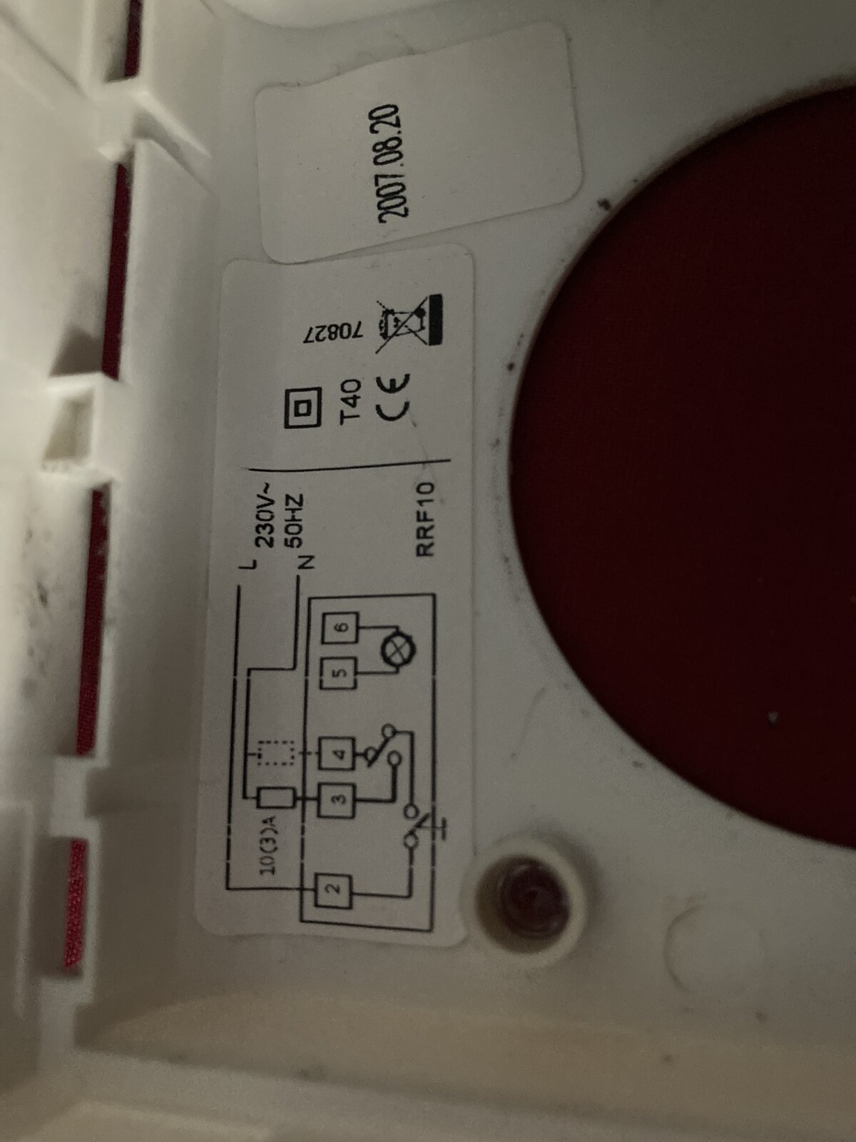

Hello,
it’s me again. I need to replace our upstairs thermostat because the dial is broken. We had the Robus RRF10 (https://xpresselectrical.ie/product/robus-heating-cooling-thermostat-10a/ ). Our local screwfix didn’t have that brand, so I went for the Honeywell T6360 instead and am now confronted with different wiring.

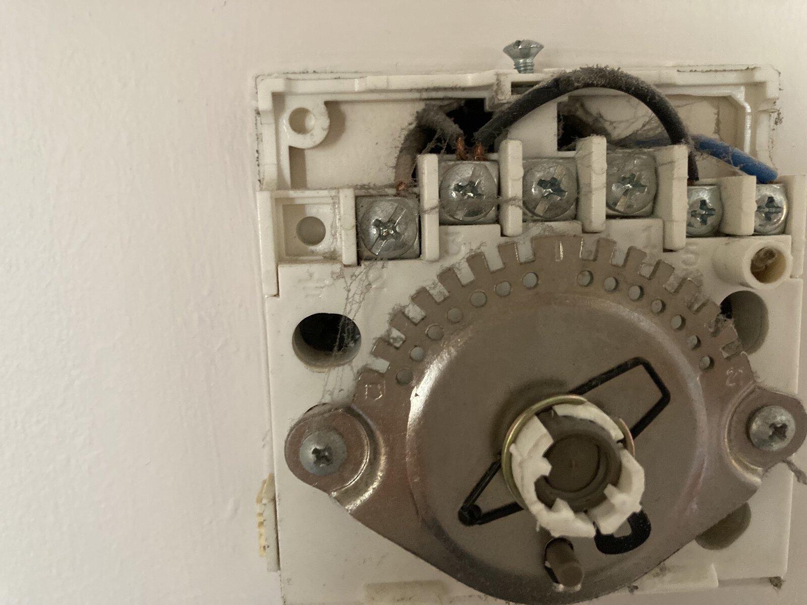

Here is the old wiring: 3ECF3CC9-8426-4E3E-8733-040607992862.jpeg
Old wiring instructions: 55ECE97C-5E1A-4393-AFF0-8919E3128FD5.jpeg

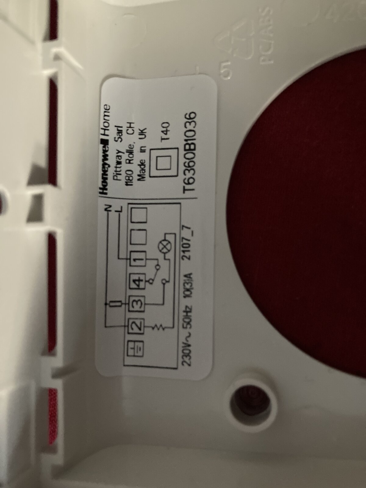

new wiring instructions: 198F7120-4889-4B21-849E-972C92EF6BB0.jpeg
In short: I’m lost and need some expertise. Wires that are there: 1 blue wire, 1 brown wire, 1 black wire and in the wall was the green and yellow one, who wasn’t even connected with the old thermostat. Any advice?
You only seem to have a brown and a blue wire, the black links one terminal to another. If that's correct follow as below.
Brown goes to new term 1, and blue (suitably sleeved with a brown marker) goes to new terminal 4.

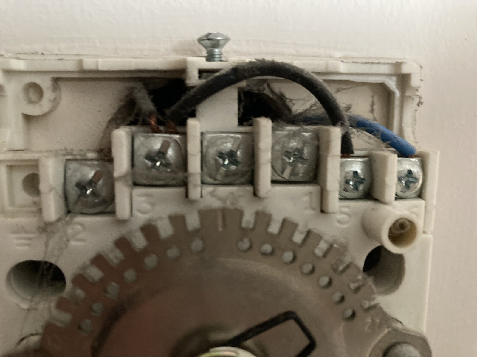

Hello, sorry my picture wasn’t too good…I definitely have also a black wire coming from the wall. You can see it better here: AA2D92EF-3F50-46F2-B434-AE15C17CB6FA.jpeg the brown one was in terminal 2 and the black one in terminal 3 (together with the other black one that connects to 5)
Then STOP right there. I didn't see the brown wire...
Does your old stat have a neon indicator? I suspect so.
Brown is live - to new terminal 1
Blue is neutral - to new term 2
Black is output - sleeve it brown and put it into terminal 4

On new stat live in is 1 live out is 3 and if there is a neutral it goes in 2
