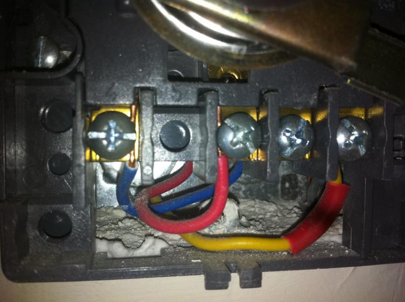

I'd like to replace my Danfoss RMT230 mechanical room thrmostat with an electronic programmable one.
I have settled on the Honeywell CM907 (not yet purchased), but would like to know where my wires go!
Currently, I have wires on my existing thermostat on terminals 1, 2 & 4, as below (terminals not in numerical order):
The wiring diagrams for the CM907 are below - which one do I follow?
Thank you so much in advance!
John
RMT 230 - CM907
4 neutral - not used make safe.
1 live ------- A
2 sw/l -------B
