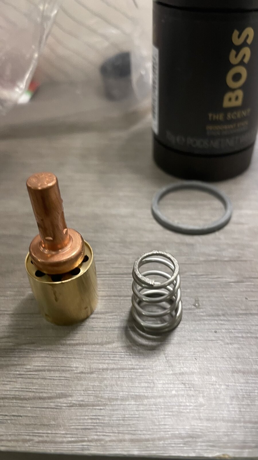

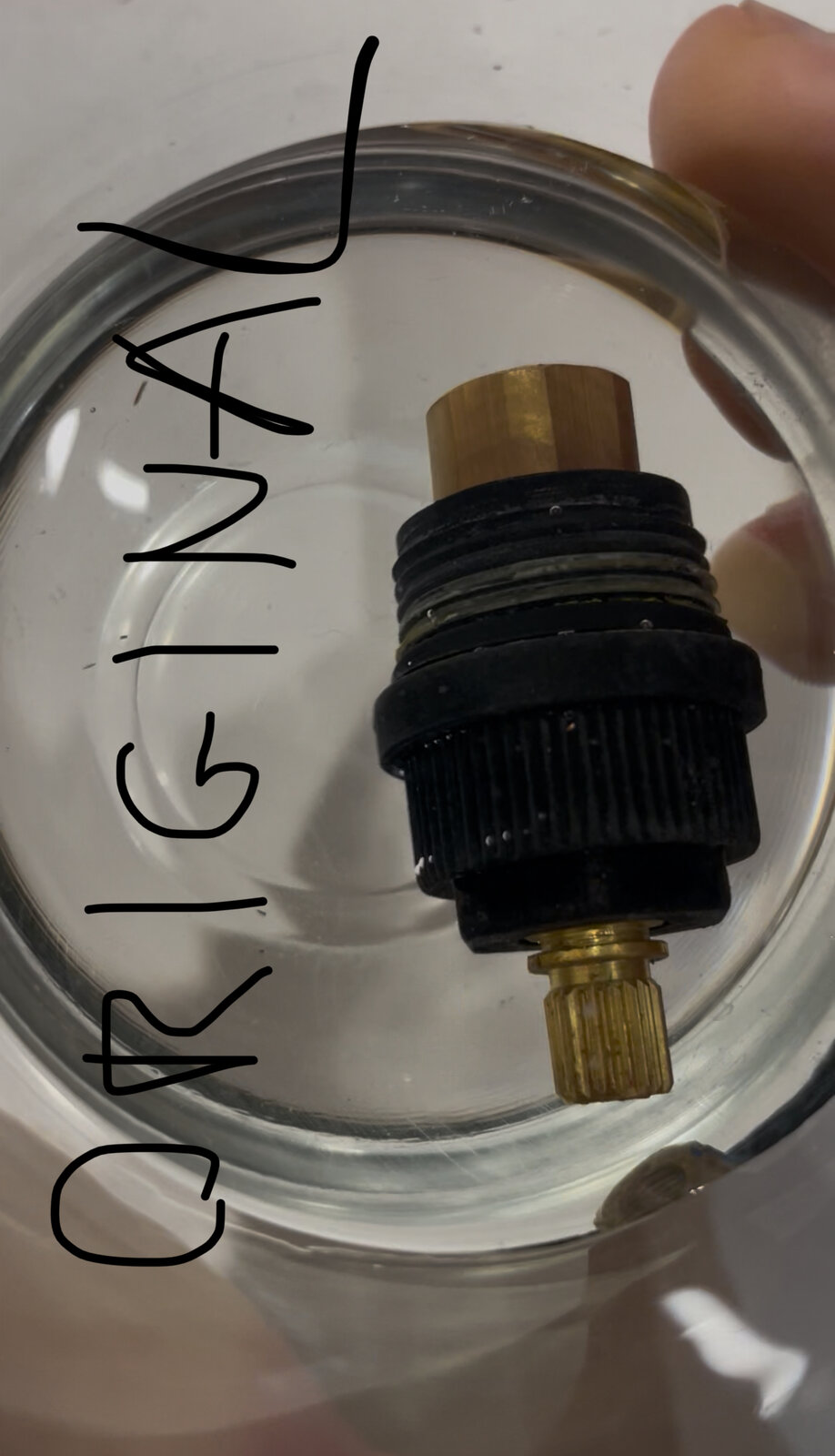

I’m trying to fix a thermostatic shower. The shop that sold it to me originally provided this part, which is slightly different from the original one.
First photo: original cartridge
Second photo: what the replacement cartridge looks like

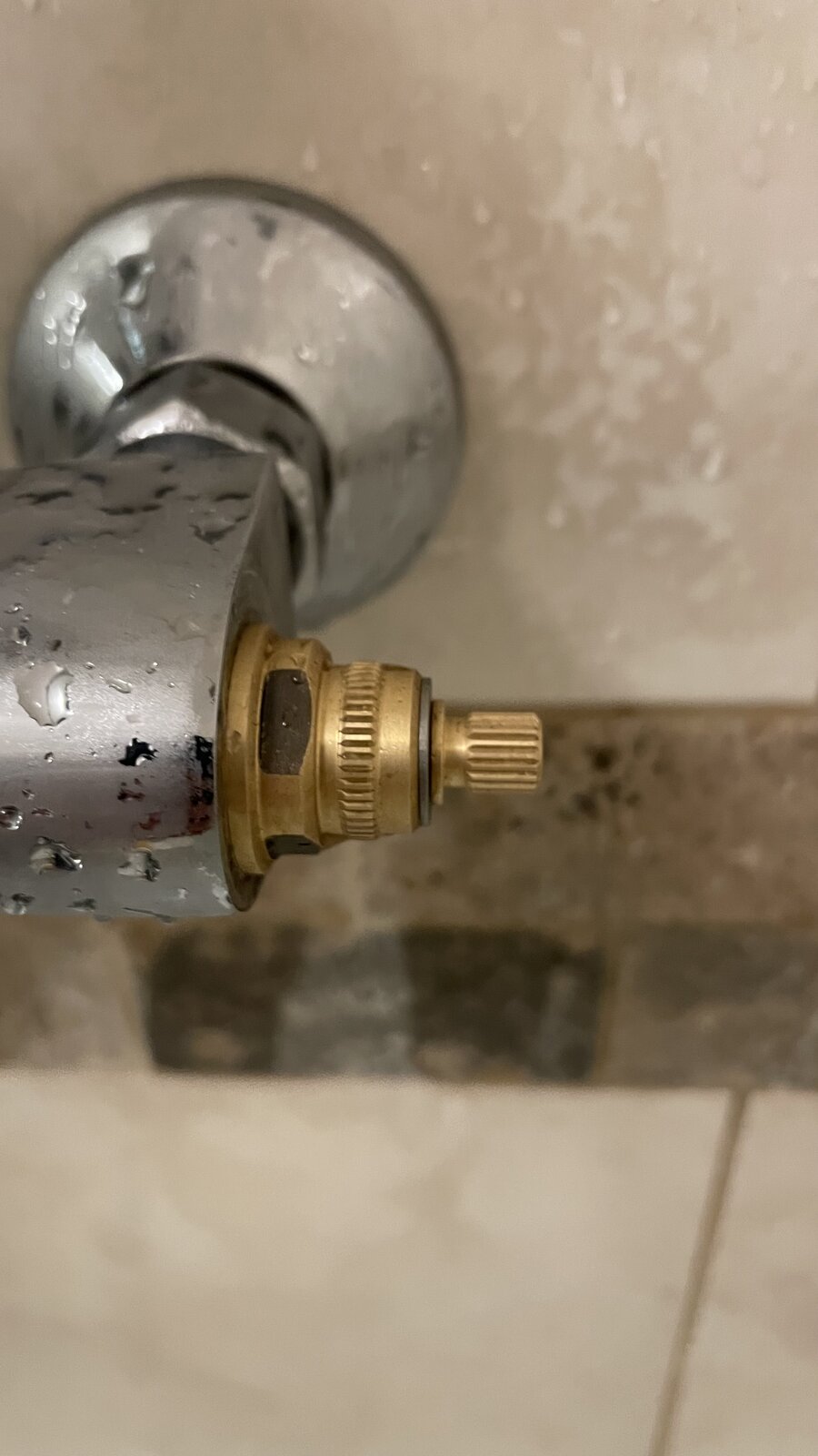

Third photo: what is this part?
With the replacement cartridge fitted no water comes out of the shower. Also, I don’t see how this part could affect anything, as it’s just a metal part that slides as the temperature knob is rotated. Do I also need to replace the part from picture 3?
That's the thermostatic part which goes in the other end of the shower bar. Did the shop sell you both?
Yes. They sold me both.
I imagine there is a similar piece inside the shower bar that I failed to remove, I briefly tried with some pliers with it wouldn’t budge.
Do you mean I need to open the shower bar on the opposite side by removing the flow handle?

One side is the flow control, the other adjusts the temperature. Which one is in your second pic, on the right hand side?
I’ll try and pull it out. The other bit I’m not clear about is that the adjustment white thing that goes onto the spline shown in picture 1 doesn’t fit on the new part. And it didn’t come with one, so there will be no scalding protection (I cannot set a max temperature)
