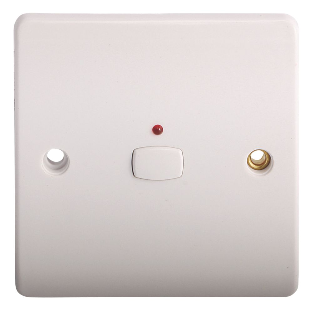

What do you want it to look like? I have a light switch in my bedroom which can be set to go on/off at set times, also on/off with three remote controls, plus on/off with Smart Phone or PC and can even be linked to weather if I want, it does not need a neutral and has a single button on the switch on/off and a little LED indicator so looks like a normal light switch.

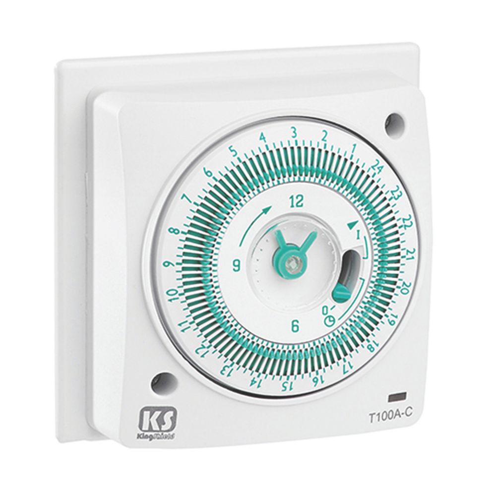

However down side is it also need a hub to set times which in my case already had for central heating, I have Energenie but the is Hive, Lightwave, and a host of others which do basic same thing, and they look like a light switch, as you move to timers some still look reasonable like a light switch often made to control immersion heaters. this

would look rotten but do the job, this

looks like a light switch, both will do the same job, but the latter would cost £17 + £48 for the hub, where the first one costs £9.90 so what are you looking for, I will guess some where between the two? With a simple lid
It would look better, £19.64 but it's your house you need to look at it, so what do you want? Do you want to be able to turn on the light from your phone? is the switch seen at all, or is it covered with coats?
Point is they will all do the job.

Switch is tucked away in the corner of a porch so appearance is unimportant. Simple mechanical or the Greenbrook would do.
