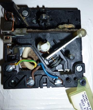

Our room thermostat (Sunvic TLX 2259) has been playing up, it doesn't activate until the temperature gauge is turned up over 20C (even when room is 15c) and then doesn't turn off again until it is reduce to the lowest setting 15c, like it sticks once on.
I've also noticed that it makes a fizzing noise and you can see a green glow between the two sides of the electrodes on the metallic strip occasionally, I assume this is as it's not quite closing the circuit.

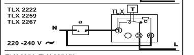

I've tried replacing it with a Honeywell T3630 (told by Plumbing shop it was compatible) but when I wired it according to instructions, live, neutral and earth it didn't turn the boiler on and off. From reading around it appears some heating systems have three wires (4 including earth) and some have 2 (3 including earth) mine being the latter.
The current wiring is as below:
while i had the cover off (with power off) I noticed the electrodes have an adjustment screw on them which alters the gap between the two electrodes. Is this something that can be adjusted or is this thermostat just worn out?
