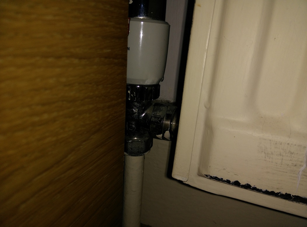

4. You should be OK, unless the TRV3 has "union" fittings, rather than compression fittings. Picture would enable us to confirm.
I think they are compression - see attached pic. So would this one directly fit in : https://www.screwfix.com/p/drayton-rt313-white-angled-trv-15mm-x-15mm/3715r

If the existing valve is permanently closed , is it just the pin stuck ? Could save yourself a lot of work if you just free / lubricate the pin ??
Pin was indeed stuck. Wiggled, pushed, pulled, accidentally removed it. Pushed it back in a hurry, tiny amount of water. It has no springiness and won't push any further.

Look at http://www.directheatingsupplies.co.uk/drayton-trv4-to-trv3-conversion-sensor-head-07-94-012 - no water involved!

2. I can't tell for sure from your picture whether its a union or compression. If nut at side of valve next to radiator and nut at bottom of valve by incoming pipe are the same size, then probably compression. If not, probably union. You can get TRVs with union connections, but they're very expensive. You could use a compression one by changing the tail which goes into the radiator (normally comes with the valve). However, it looks like a very cramped space to try and take the old tail out. You'd also need a tail removal tool (e.g. Toolfix 11467), they're not very expensive.
Thanks, so trial and error for draining it is. Those converter heads are the wrong bit for me, it's the valve body i need. I think I have compression joints.
