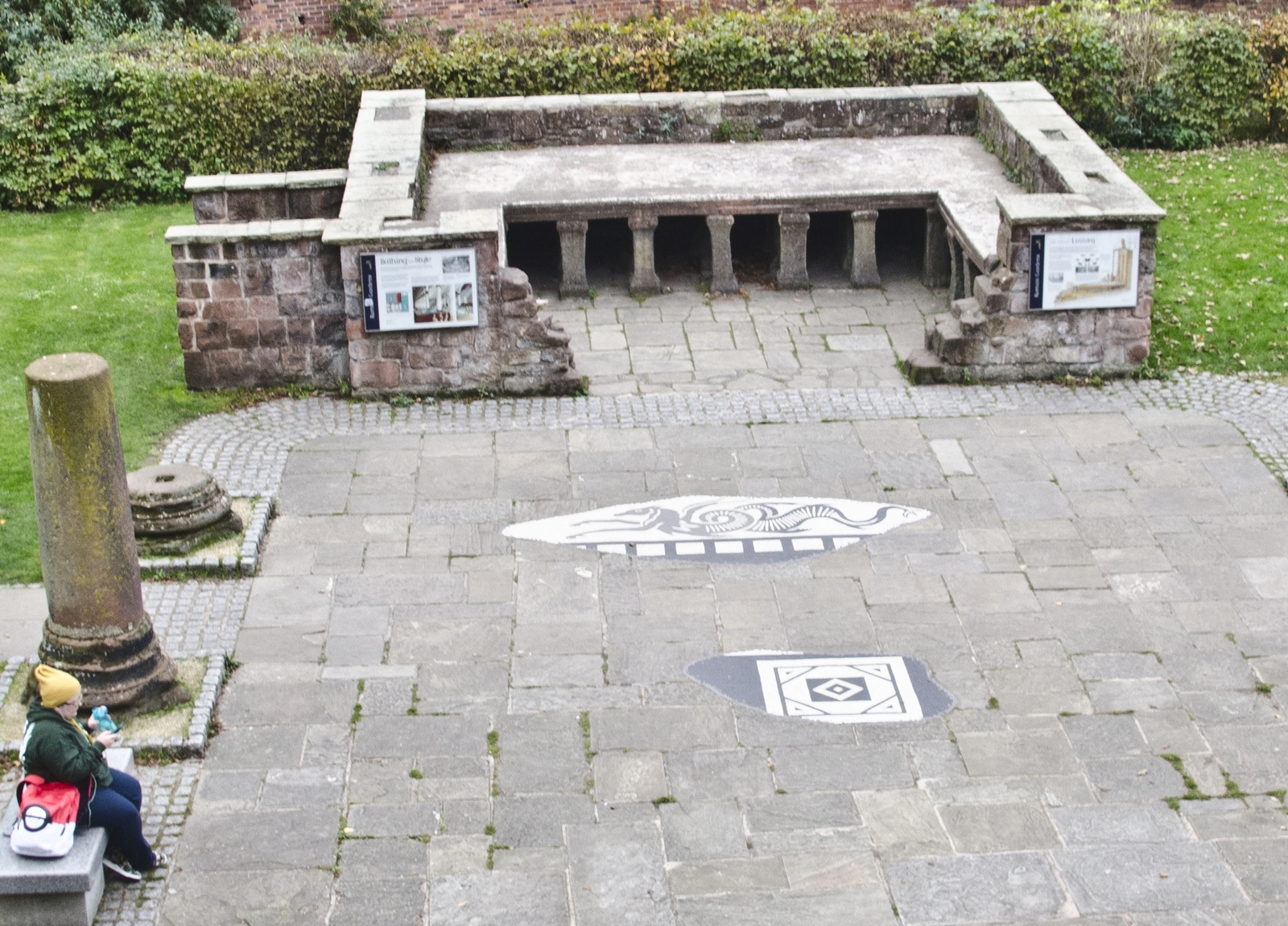

I have often seen radiators fitted under windows, I assume as furniture is unlikely to cover them, I have never seen a coal fire under a window, and I know many a coal fire was poorly planned, there needs to be a air supply to a coal fire, so on the outside wall allows vents to allow combustion air into room to feed fire without causing drafts, however houses have been built with flues going up centre of house without any ducts to bring in combustion air, it would seem builders have not got a clue how to heat a house and have never had throughout the ages.
Here they have not even got a roof on the house, don't think underfloor heating has ever worked?
