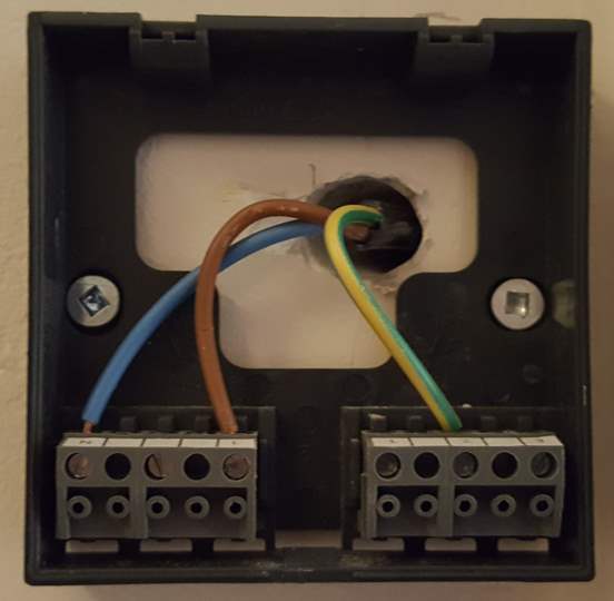

Last winter, I had a new oil boiler & heating controls installed. It was done under the terms of a local authority grant, which did not include a wireless thermostat.
For various reasons (things like cornicing etc) it wasn’t possible to put the wall stat in my living room, which is pretty much the only room in constant use – so it was installed on the wall in my hall, just outside the airing cupboard.
Now, the trouble with that is, it works kind of OK, but of course it switches the boiler off and on to suit the temperature in the hall – so I find myself going out to the hall and adjusting it from time to time, as the living room gets too hot or cold.
Seems to me that the ideal solution would be a wireless stat… however, I’ve given up trying to get electricians or plumbers to come out and do small jobs like this, so want to tackle it myself unless it would be life-endangering to do so :eek:

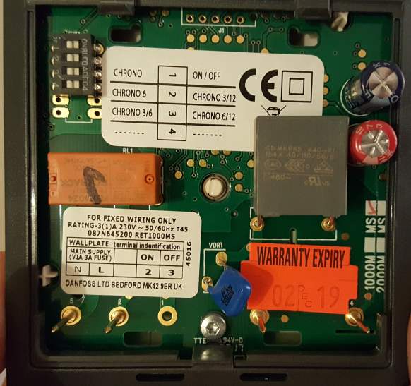

Here are some pictures of what I’ve got. Now it *SEEMS* to me that the wall stat is a simple switch (apart from the thermostatic bit obviously), so it just makes and breaks a loop? If so, first question – can I just buy a wireless stat, and substitute its receiver unit (or whatever that bit is called) for the existing wall stat, and it will work in the same way?
Secondly, I don’t want to have to get into replacing the timer unit (also pictured below) – is that possible? IE, if the wireless stat just makes and breaks the circuit, presumably the new one would be OK with my existing timer control?

Roger,
Sorry but I am wrong, the Toolstation version also needs 240V to power it, so NOT suitable for you as a direct replacement of your thermostat (unless you can run 240V to it).
Manual is here:
http://www.tfc-group.co.uk/assets/graphics/static/RFWRT_instructions.pdf
Your better option is therefore to put the receiver at the boiler location (next to your the timer unit), connecting the receiver to 240V to power it, and identifying where the current thermostat wires go into Boiler from the wall and use those as the receiver to swtich boiler on and off.

The existing thermostat does have mains power - the blue and brown wires to the left.
Even worse, some idiot has wired the switched live using the green/yellow wire.
You serious? It was a qualified electrician that installed it as part of putting in all new heating controls when the grant work was done... it seems to have worked OK for the last year? What are the implications of what you're saying please?
{EDIT} - what I mean is, is he an idiot because he's used something which will look like an earth wire because of its colour (idiotic, I agree - that's what I assumed it was), or is the wire connected incorrectly?
Regulations do not permit using a green/yellow wire for a switched live, or anything else other than an earth connection.
It also means there is no earth - although the majority of thermostats do not require one.
It will work as wired and isn't unsafe, but it does suggest whoever installed it either did not really know what they were doing, or did not care.
At the very least the green/yellow should be oversleeved in brown at both ends.
Ideally that cable should be removed and the wireless receiver installed next to the wiring centre using more appropriate cable.
