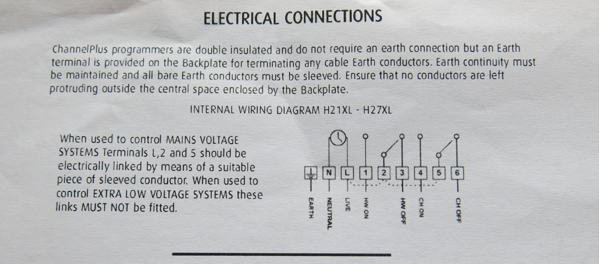

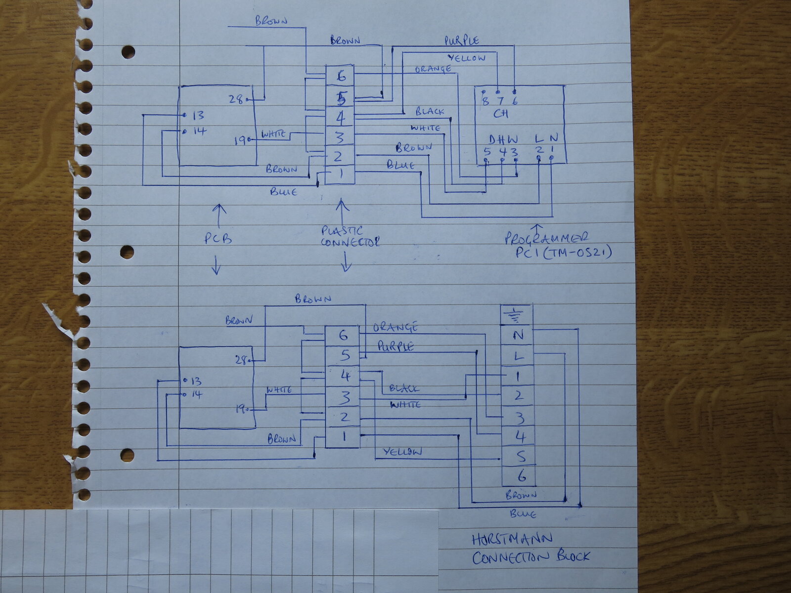

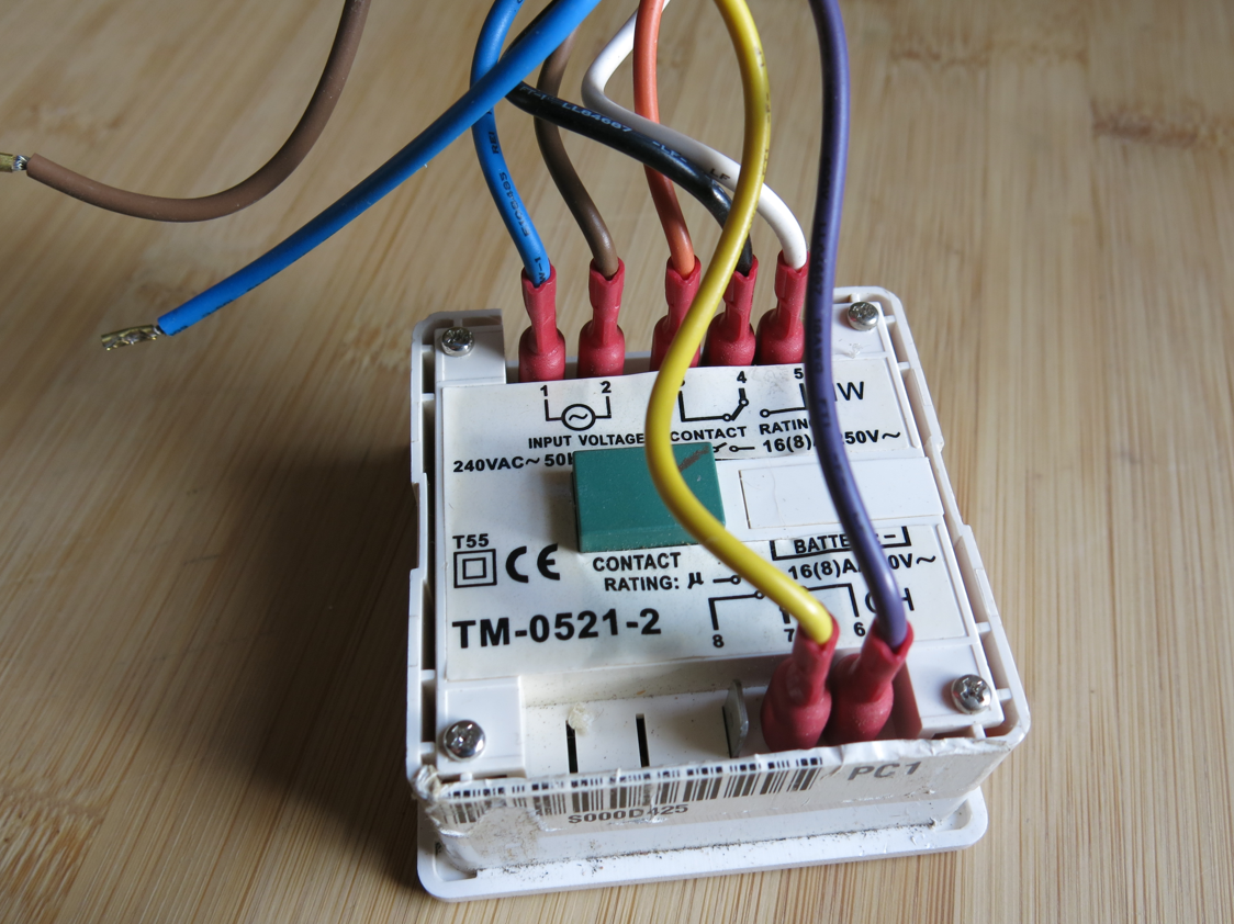

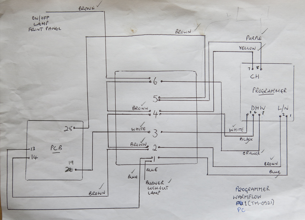

Hi,
I often visit this site for help and information, but this is my first post.
Just under a year a go I moved into a neglected older property in need of a large dose of TLC and I'm slowly working my way through a numerous number of improvements. The property is heated by an old, but working Warmflow oil fired boiler. The boiler, with its built in timer/programmer, is in an out building (probably the old coal shed) and therefor has the inconvenience of having to go outside when ever a change in the timer/programmer is required.
Before the onset of winter I'm hoping to install a new timer/programmer and this is where i need help.
The boiler's built in timer is a Warmflow's PC1 (TM-0521) which can time/program hot water and heating.
The replacement timer/programmer is a Horstmann H27XL (familiar with this from a previous house) which will be wired from the boiler to a position in the house.
Is anyone able to give me advice on the rewiring of the replacement?
Some diagrams are included below.
Wiring diagram showing how my built in programmer is currently wired (slight error - connections labelled at 7/8 should be 6/7 as seen on back of programmer).
The Horstmann wiring options
The Warmflow programmer
