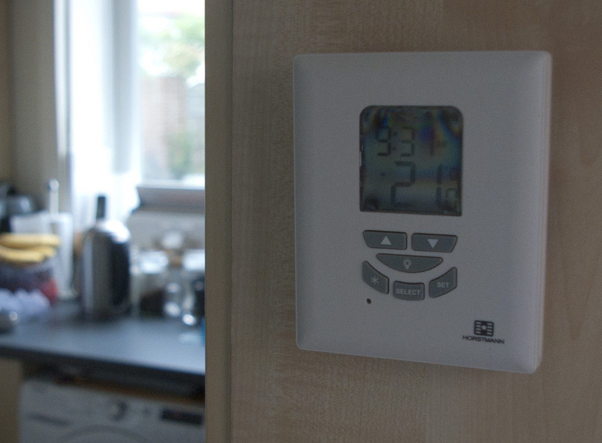

Thanks for the replies would probably feel fairly confident in replacing a like for like receiver ( photographing the wiring first is a good idea)
But other good news is that the daughter has now found the missing thermostat ( will not say where it was ) I have photographed and taken details of the thermostat in case the same thing happens again .
Was thinking of getting a spare like for like thermostat just to test if it works with the receiver that is now in place.

Oh I had that problem with my mother, before fixing to wall I had this IMGP8037.jpg thermostat as free standing, idea was put in room she was using, and TRV would stop other room over heating, I found it in a draw.
But the problem was it lacked a fail safe, this 84067_P.jpgone had a fail safe, if the thermostat not seen every ½ hour it would switch off, but the other one could stay on, before I had set the TRV's and lock shields correctly I walked into the room at 30ºC where it had failed to receive the off command.
After that I set the TRV and lock shields, and the wall thermostats rarely turned off in winter, the boiler did what it should do and modulated, so the room temperature remained more stable, using the TRV's seemed to remove the hysteresis.
