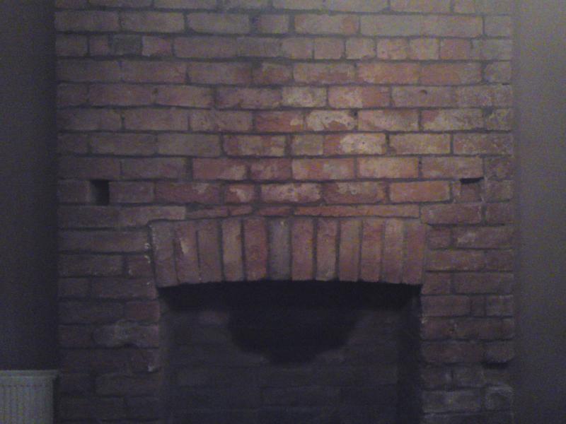

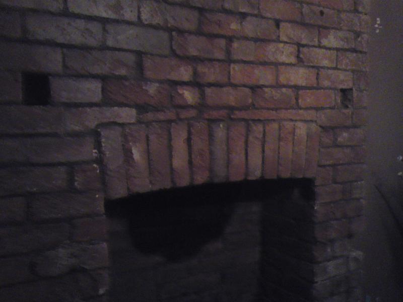

I,m about to replaster my recently stripped chimney breast as my wife with her ever changing mind has decided she no longer likes the bare brick look anymore despite the fact it took me ages with a wire brush to get back to the state you see in the photo's.
However i'm a DIY plasterer and i'm quite happy with my level of skill when it comes to plastering but there is so much i dont know and am always willing to learn new stuff.
1) What is the best way to replaster the chimney with regards of the material to use as it will have a woodburning stove installed
2) The internal back of the chimney is damp not soaking wet but the bricks are darker and when you really close they smell a bit musty(it's about 4 bricks above hearth level and has been like this since it was opened up about 6 months ago with no real signs of drying out i assume it could be penetrating damp as we live on a hill and next door on the other side of my chimney are higher up so my finished floor would be under their floor level if you see what i mean as their house is stepped higher than mine, or it could be rising damp (but after reading a long winded post on here about rising damp i dont even know it that exists).
Is it o.k to sand cement render with water proofer additive on the inside of a chimney and will this stop the damp or is there a better method as like i said before it's not really damp.
3) What is the best way to maintain the curve of the arch of the opening when it comes to replastering the face of the chimney.
Wood burners, multi-fuel & open fires generate a lot of heat in the surrounding wall & it’s important that you do not use ANY Gypsum based plaster, either base or finish, in the enclosure or on the wall area within a minimum of 500mm either side & 800mm above the stove. Gypsum will only withstand a temperature of around 50 degrees C & regular exposure to much above that will cause it to blow, crack & eventually fall off.
You need special heat proof products, something like this;
http://shop.vitcas.com/vitcas-heat-resistant-plaster-16-p.asp
A sand/cement/lime based render will be just as good for the base coat & a whole lot cheaper but don’t be tempted to use Multi over it; you will need a heat resistant finish plaster unless you settle for the coarser render finish.
You can get heat resistant finish boards (again quiet expensive) which may be a better option as it will only cover the bricks rather than obliterating them behind render but I’ve never used them. I wouldn’t use Fireline board either as it’s still Gypsum based & is only intended to provide a one off barrier in the event of fire not as a decorative heat proof finish.
2) The internal back of the chimney is damp not soaking wet but the bricks are darker and when you really close they smell a bit musty(it's about 4 bricks above hearth level and has been like this since it was opened up about 6 months ago with no real signs of drying out i assume it could be penetrating damp as we live on a hill and next door on the other side of my chimney are higher up so my finished floor would be under their floor level if you see what i mean as their house is stepped higher than mine, or it could be rising damp (but after reading a long winded post on here about rising damp i dont even know it that exists). Is it o.k to sand cement render with water proofer additive on the inside of a chimney and will this stop the damp or is there a better method as like i said before it's not really damp.
It’s either damp or it isn’t & a test with a meter will tell you; either hire one or call someone in to test & advise. If there is damp, whatever the cause, you must sort that out first; you will have problems if you just render over it & plaster won’t stand damp at all.
Maintaining the curve should not be difficult & I would use temporary formers & render/plaster to those rather than a fixing a steel beading which could cause problems with cracking from expansion & contraction due to the heat.
Finally; be aware that installing a new stove or recomissioning an open fire is subject to several Building Regulations & will require a Building Notice submission unless you use a HETAS registered installer. The regulations cover the flue, hearth (constructional & decorative), ventilation, stove installation & a small notice stating the fire/flue rating which is usually located next to your consumer unit. You will need certificate of compliance for the above & will be required to produce it in the event of a sale.
