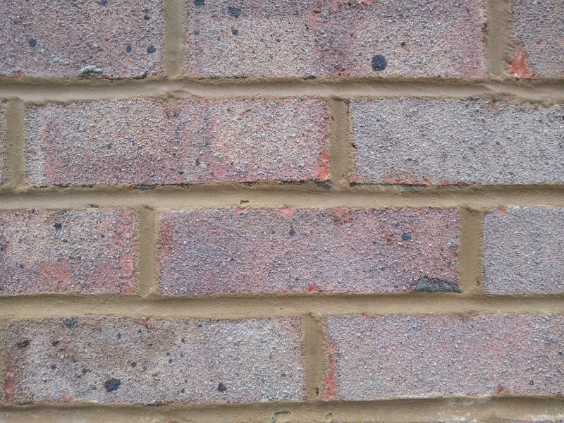

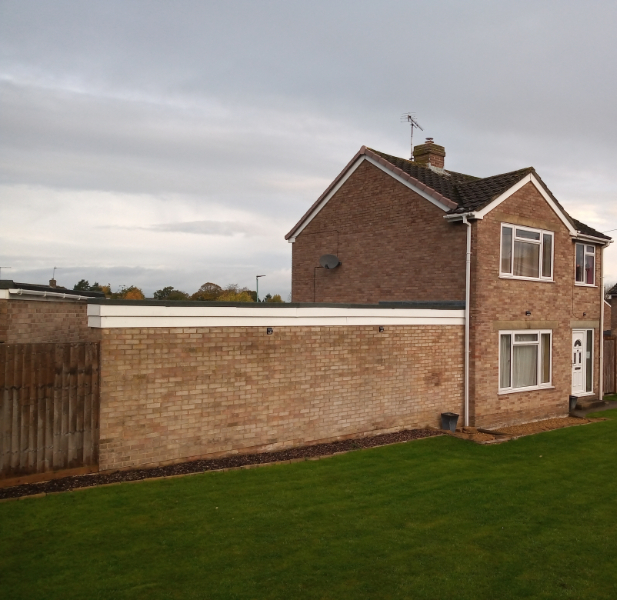

Had some repointing started late last year, the top half of the wall only as scaffolding up.
Builder supposed to be returning to complete from garage roof but have become concerned about how well the work has been done.
I noticed that after rain the repointed portions seem to be wetter in places, I started to wonder why more water was present just in these areas. Also, I noticed that some bits had been missed out.

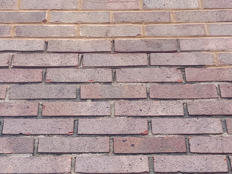

On closer inspection, it seems that the racking out seems to be a little roughly done, shouldn't the whole mortar joint be racked out?
Can still see old mortar in places.
Is the repointing good enough?
I am planning on applying Stormdry to this wall (to help sort garage water ingress) but have become concerned that it won't work if repointing is poor.

Yes, the finish and the raking out is crap.
If the wall does appear too wet after rain then the mix and/or the ironing (compacting) of the joint is crap too.
Water repellents rely on the grains of sand and pores of mortar being tightly bound.

Am assuming the entire joint should be raked out down to a level of 10mm, then dust cleaned out. What else should I insist on to get the job redone correctly (i.e. Am not sure what mix he should have used, how do I ensure it's correctly compacted)?

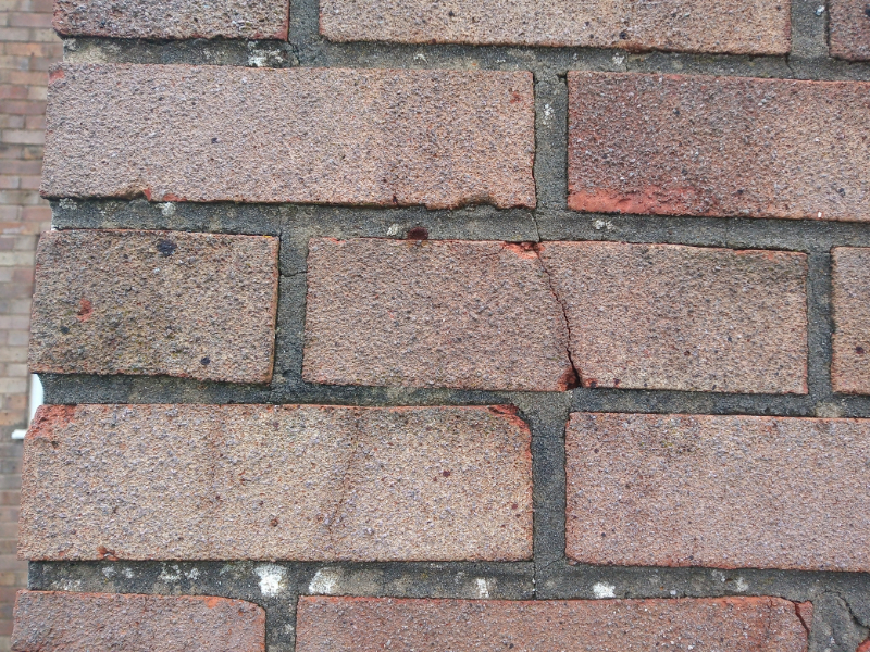

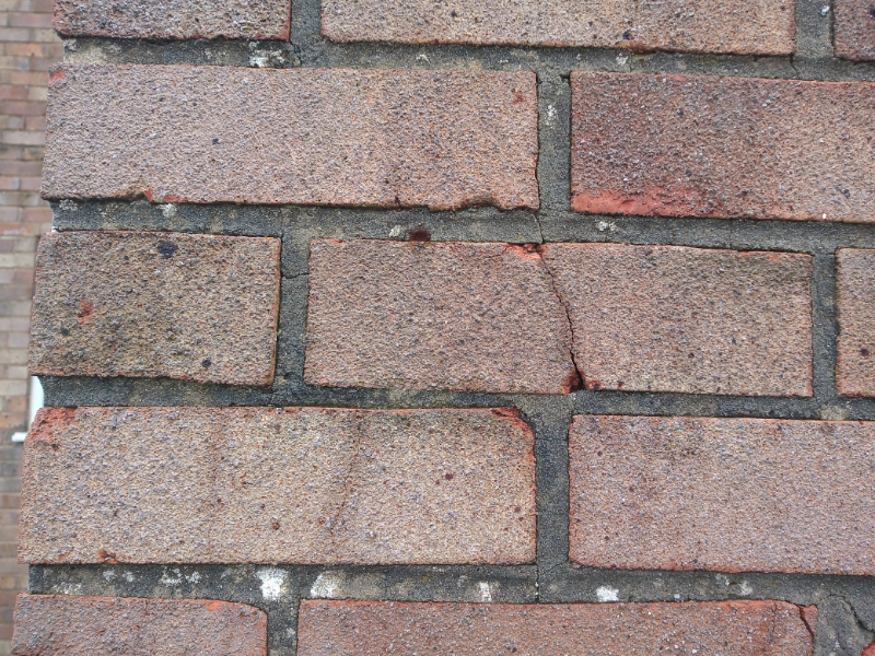

Also, should cracked bricks be removed (bear in mind we have lose-fill insulation with no adhesive added in, so it will fall out)?
Any brickie worth hiring will know that joints are raked out to 20mm minimum, normally 25mm max. Knowing how to point is knowing how to clear the joint, dampen it, fill compact and iron the joint. You should see a smooth hard mark-free surface that looks solid not grainy.
The damp joint spots are likely voids full of water.

Bad job, as a rule off thumb the raking out should be a minimum one and a half times the width so in this case around 15mm.The pointing they have done is rough.

Can someone give me a rough steer on the price I should expect to pay a competent brickie to repoint the gable end excluding the garage?
Have tried to find a bricklayer, (asked on Facebook / asked a couple of friends) so far no joy, any suggestions on places I could try also and what should I be looking for (qualifications etc.)?
Given my current lack of funds (and difficulties finding a brickie) am now wondering if I should leave the work above 6" from the garage roof (my height) and redo the repointing down from this point myself. Is large scale repointing like this a task a DIYer should undertake, have done some small amounts of brickwork in the past (filing in garage window / replacing single bricks)?
