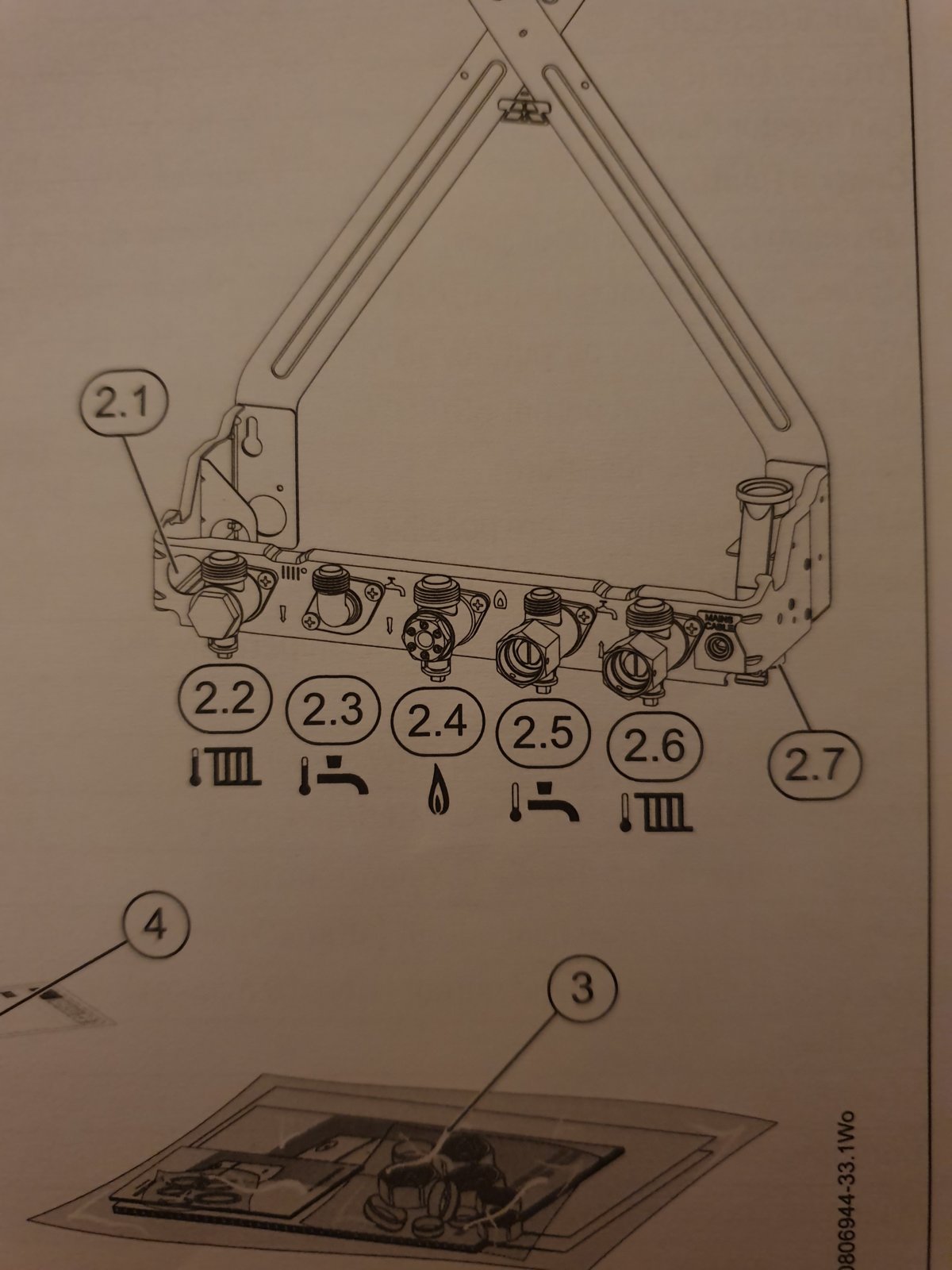

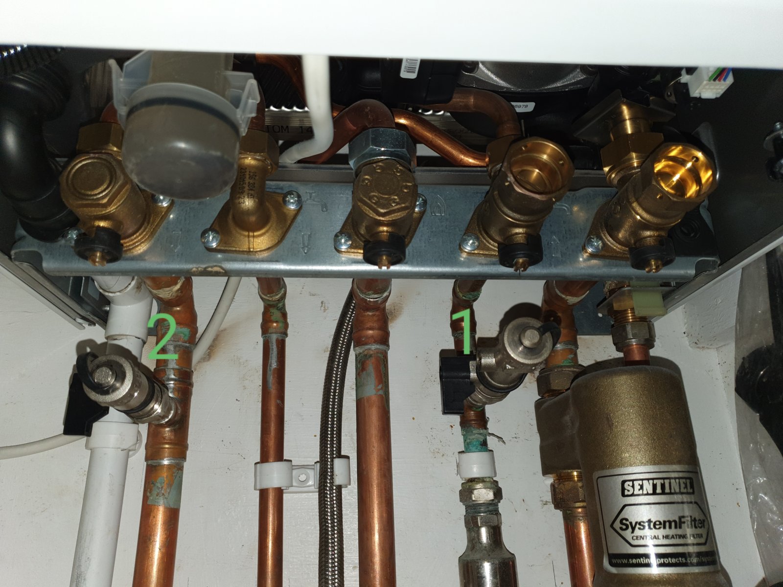

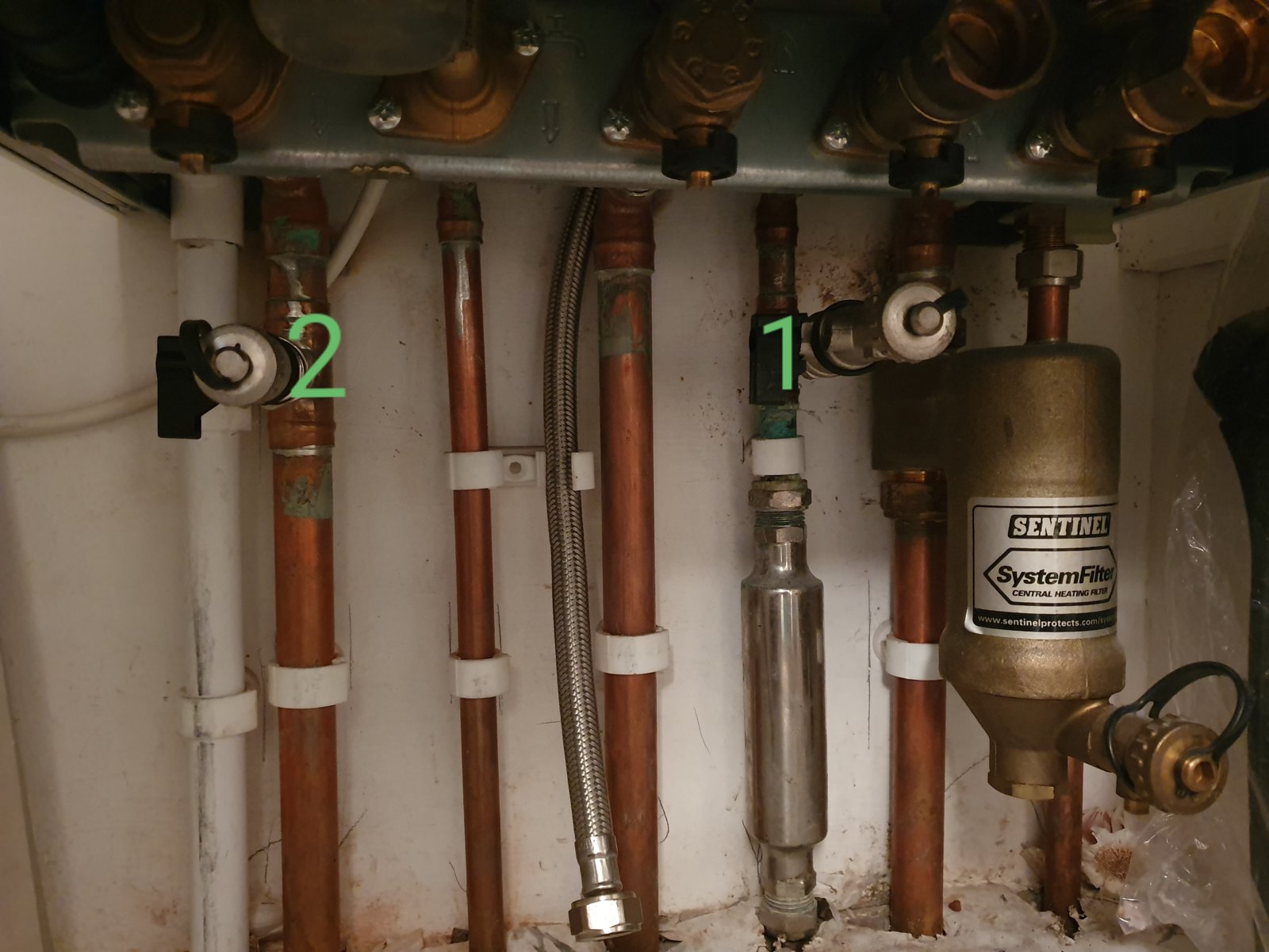

Our boiler pressure gauge is just above 0. I've worked out that we have an external filling loop but the problem I have is that it is not connected to anything at all, so I'm not sure where I need to connect it.
I've attached 2 pictures of where I think it needs to be connected (theyre the only pipes with caps) but wasn't 100% and didn't want to end up doing something and damaging it. Also attached 2 pics from the manual.
Any help/advice would be very much appreciated.

Take the silver braided hose and attach it to where you have labelled and open the valves
Brilliant, thanks! I put it to in between 1 and 1.5 bar.
