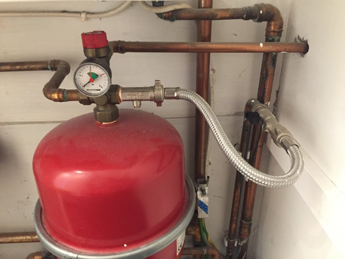

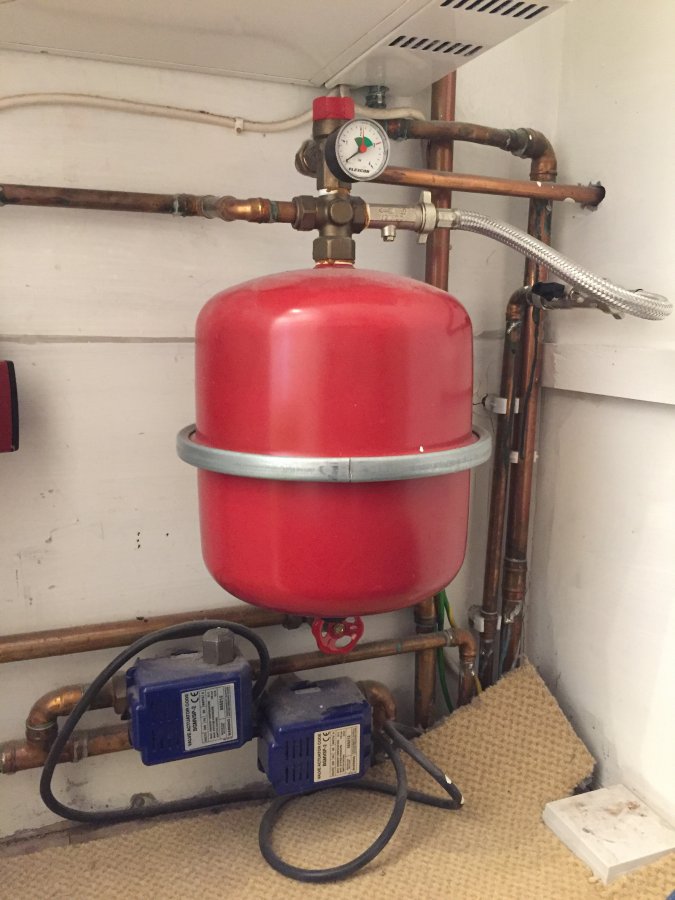

I've got a boiler and expansion vessel upstairs, and a few days ago, notices the upstairs shower had crap pressure. The pressure gauge on the expansion vessel shows next to zero, so it seems I need to repressurise it. There's a filling loop attached (as seen in the photo), but only one black valve, and turning it does nothing. I've detached the filling loop, and nothing comes out when I turn the valve. I don't see a second black valve anywhere. Any ideas?

The pressure on that gauge has nothing to do with the pressure from your shower. I think you may have multiple problems. Are any other outlets suffering from reduced flow?
That filling loop looks to have Check valves at both ends (these are directional) the one at the vessel is pointing the correct way, is the one at the other end? The arrow on it should point towards the braided hose.
What type of shower do you have? Is it gravity fed from the cylinder and cold water storage in the loft? Or is it an electric shower, fed by mains cold?
Have you checked the tank in the loft to see if it full and that the ball valve is operational?
Have you shut off any isolation valves anywhere?
