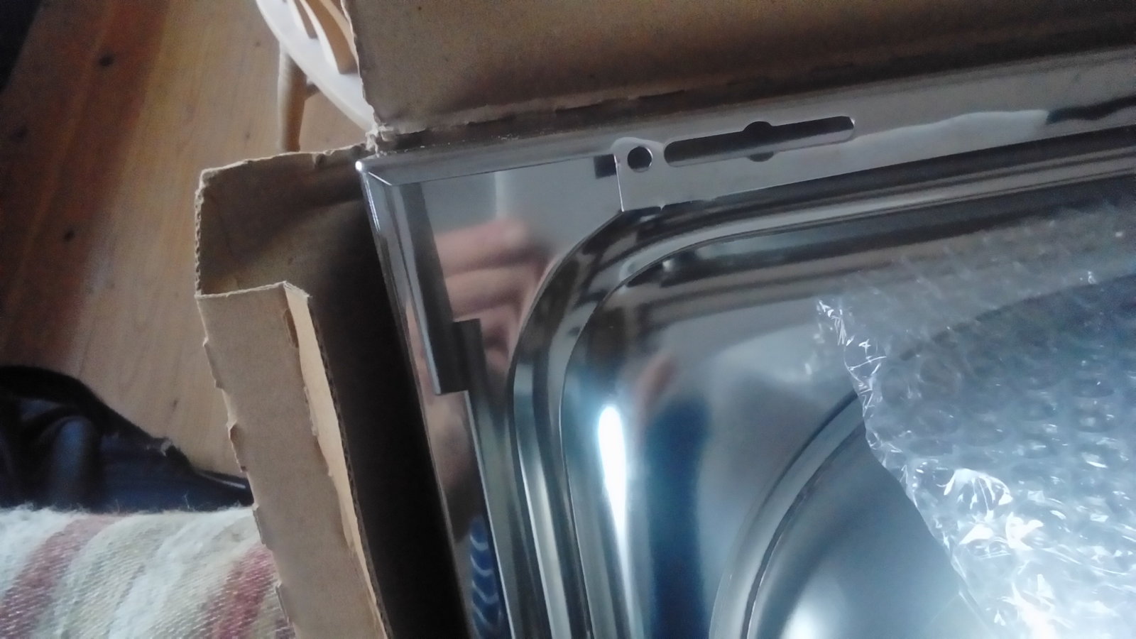

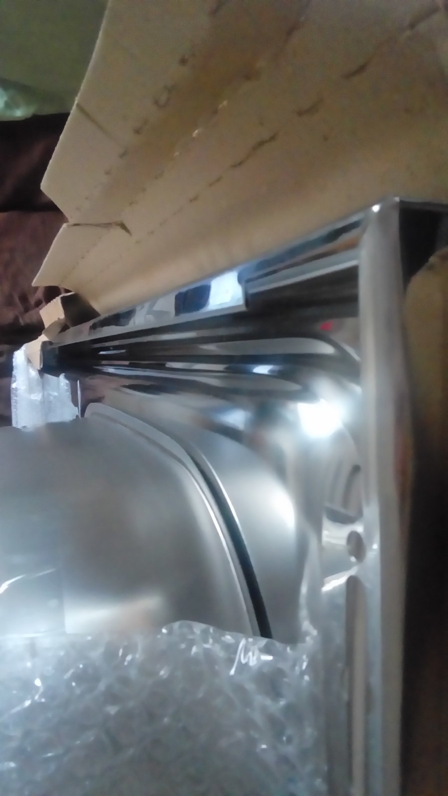

This Pyramis sit-on is a 600 deep square front, the lip that's folded under the front only projects10mm back, although it is folded over on itself again so that there isn't an unprotected guillotined edge under there, and that does add rigidity along the front of the whole thing. It would have been better if that lip projected back under far enough to sit on the carcass top front though. I can't think what type of unit it was designed to go on.
Benjamin James bases are 560 deep...so the whole of the front edge of my sink will be floating. Maybe I should h
ave gone for a Leisure Contract sit-on, it was thinner gauge but at least the front would have had support.
