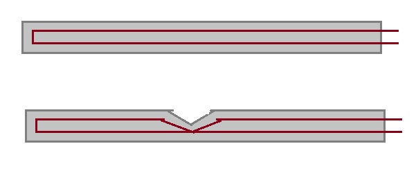

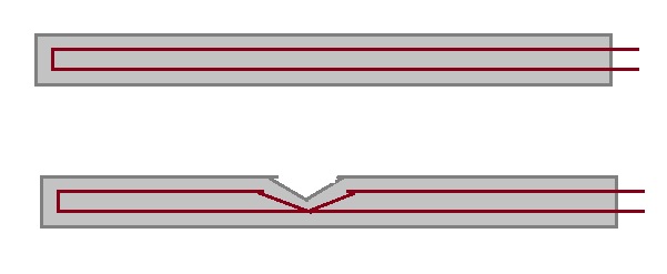

A bifilar heating element can be crushed and if the two heating cores come into contact then the resistance is reduced.

Most heaters with mineral insulation can run with the core(s) red hot for long periods of time in an over current fault situation
In fact mineral heater elements in air handling units often are glowing, very dim but visible in the darkness of the duct. The first time I saw it I was sure it was incorrect & got the engineer in there PDQ.
