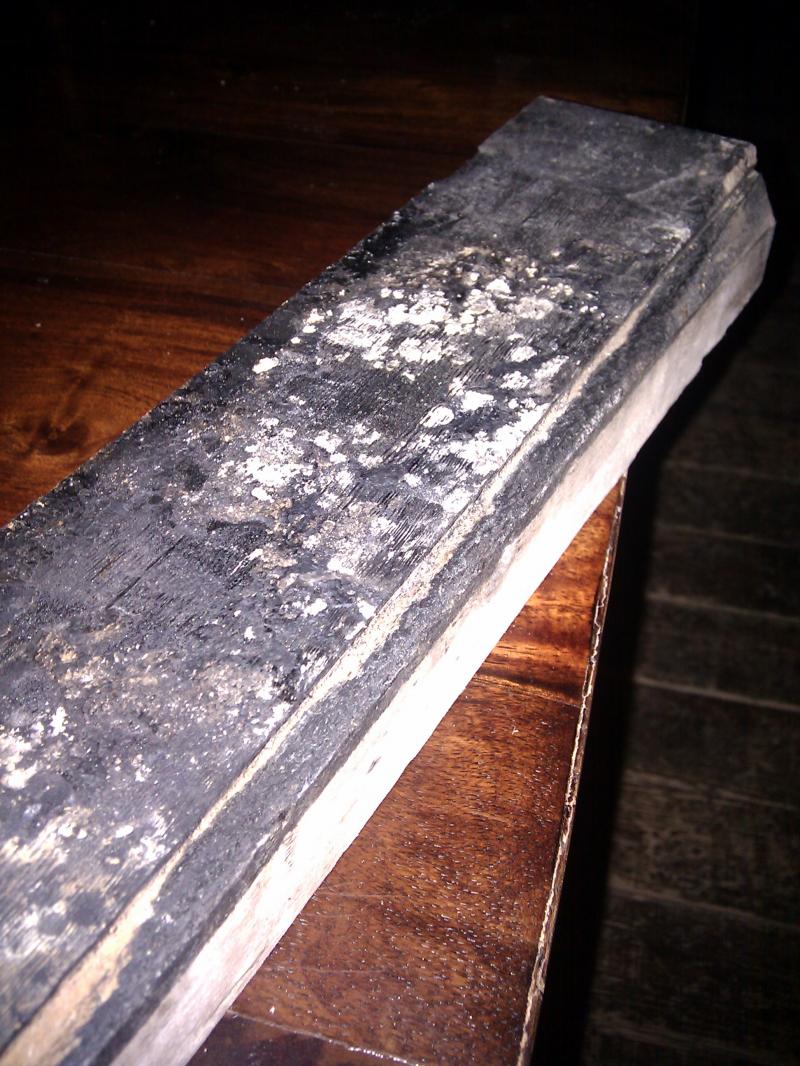

I'd assumed this white stuff on the bottom of the blocks was mold where moisture had got in over the years.
Someone in a local flooring shop today told me they used to mix asbestos in with bitumen, and given I've just spent 2 weekends scraping it off I'm really hoping it isnt that!?
I have been stripping the bitumen off my blocks- some have residue of the concrete they where on stuck to them. You may have the same thing on yours.
I have however bought a suitable respirator since I was using a heat gun to heat it before scraping it off, the fumes were quite bad, despite good ventilation in the area.
I have then used a belt sander to clean up the top side. I then plan to use a planer/thicknesser to get them all the same dimensions.
Another trick would be to dump them in a freezer, which makes the bitumen brittle and chiseling if off will be easier (and not toxic vapours!)
Hmm I don't fancy filling my freezer with dirty wood blocks. Whilst a bit smelly the heat gun/scraper is working fine. Though I will admit it is better on a cold day as the residue cools quickly so they aren't sticky for ages.
