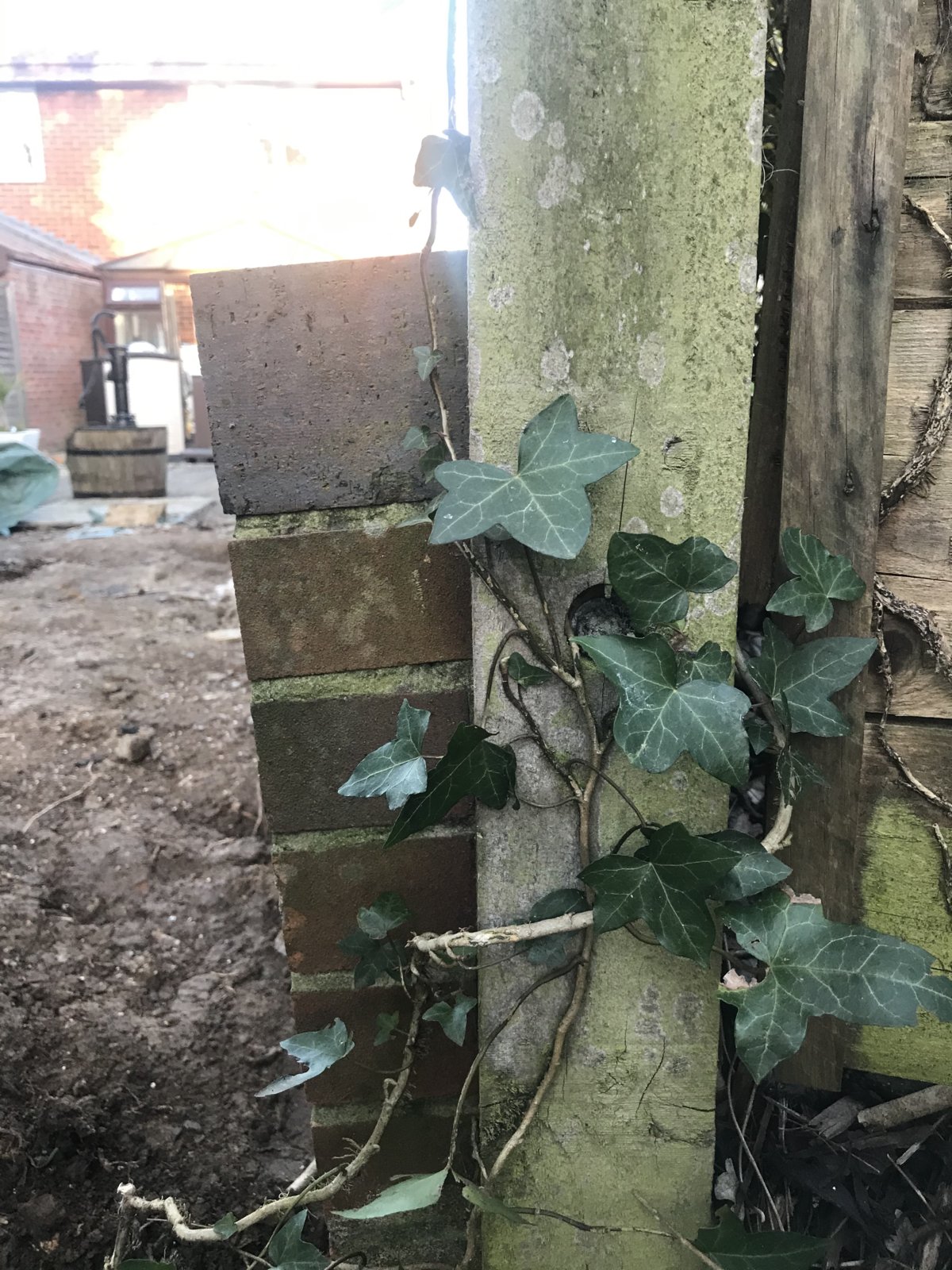

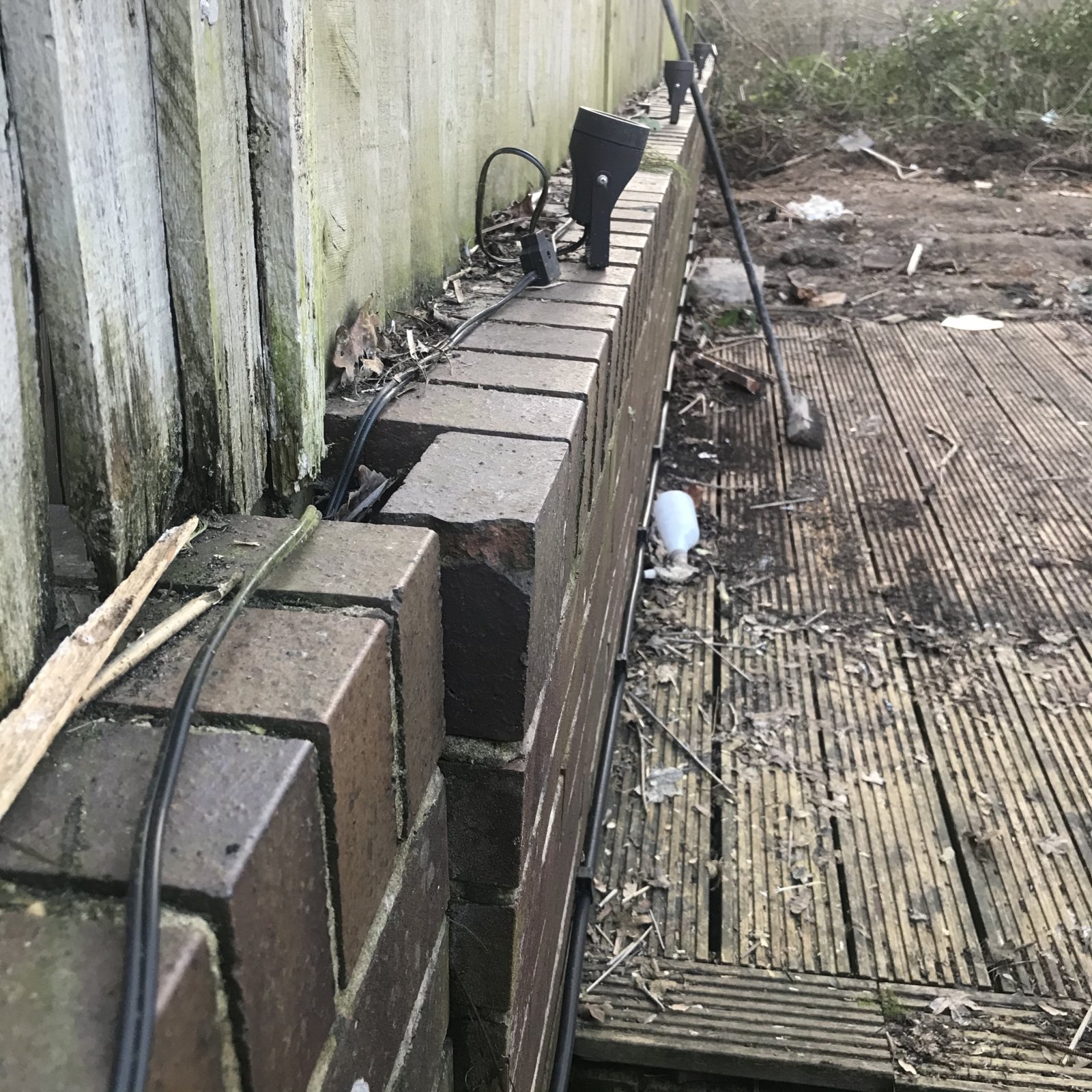

Hi all,
I am looking for some suggestions on what could be done about the problem shown in the attached images. The gardens that neighbour my rear garden are around 1m higher with a retaining wall holding everything back. Over time the wall has started to rotate on the footing and I am concerned that it may come crashing down into our garden.
We are currently looking into who's responsibility the wall is as I was under the impression the owner of the land pushing the wall over was liable to fix any issues like this. Either way, I'd like to understand the technicalities of the issue and what could be done, regardless of liability.
If it turns out it is my responsibility after all, I don't have much of a budget to play with so need to know if this is an expensive job!

ground water pressure & growing foliage etc. will topple a retaining wall.
Perhaps you can post pics of the neighbour's side of the wall.

The wall has failed completely either at foundation level or because of the foundation, and will need rebuilding completely, and hope that the foundations themselves are adequate.

A similar issue occured at the front of the property a few years back and the guy who had that fixed noted that behind the facing wall was another wall which sat below the ground level. When they rebuilt the facing wall, they tied it back into the hidden wall.

Firstly, obviously the wall has failed, but it doesn't look too bad. Its quite hilly round here and there are plenty of walls worse than that still standing. Its not that high either. What's behind it? If the neighbours house is right there its a bigger issue than a load of garden. Also are there any trees? If their trees are knocking the wall over it may change the responsibilities a bit.
