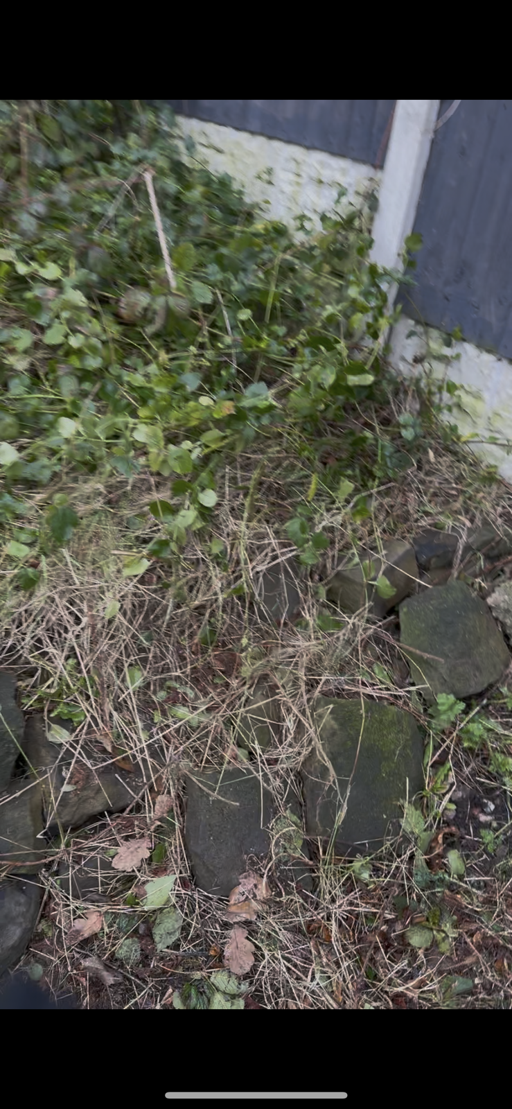

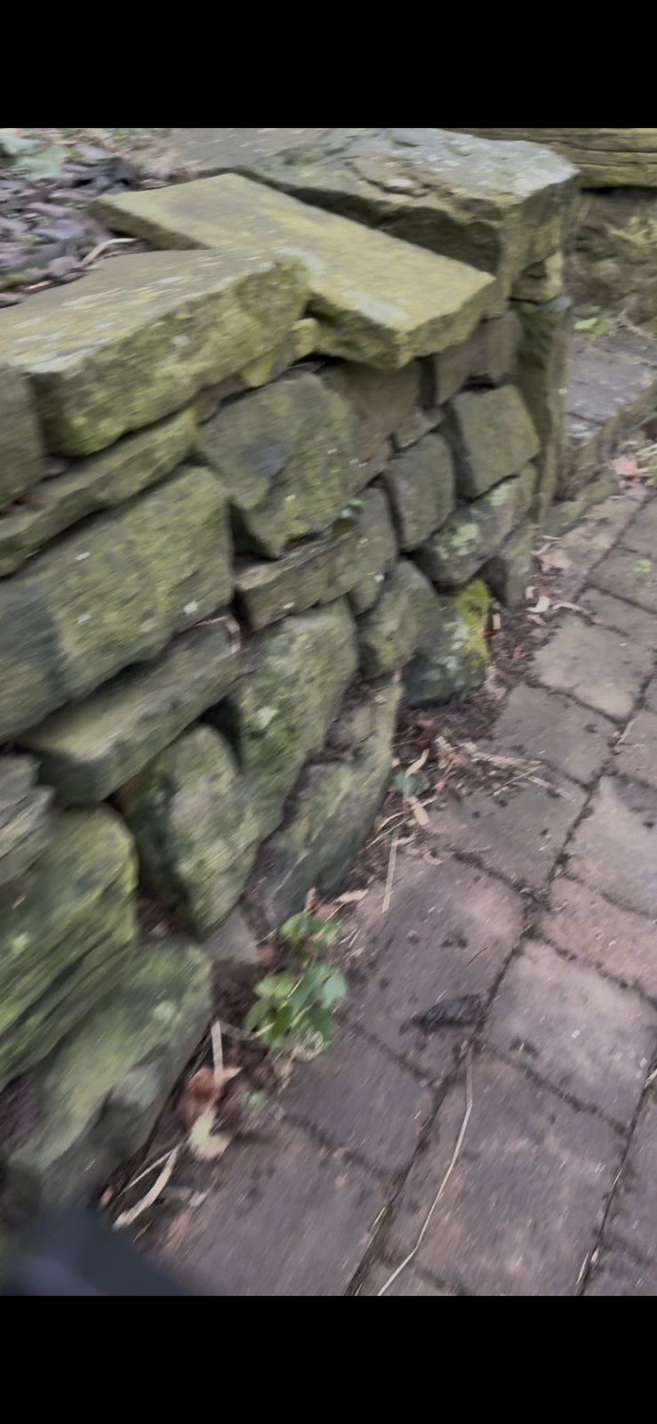

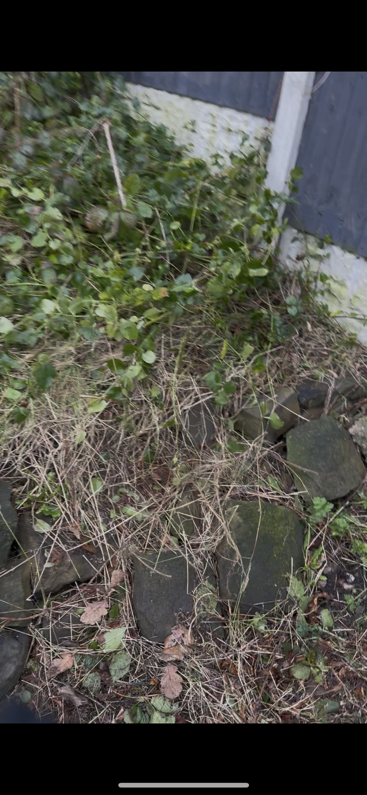

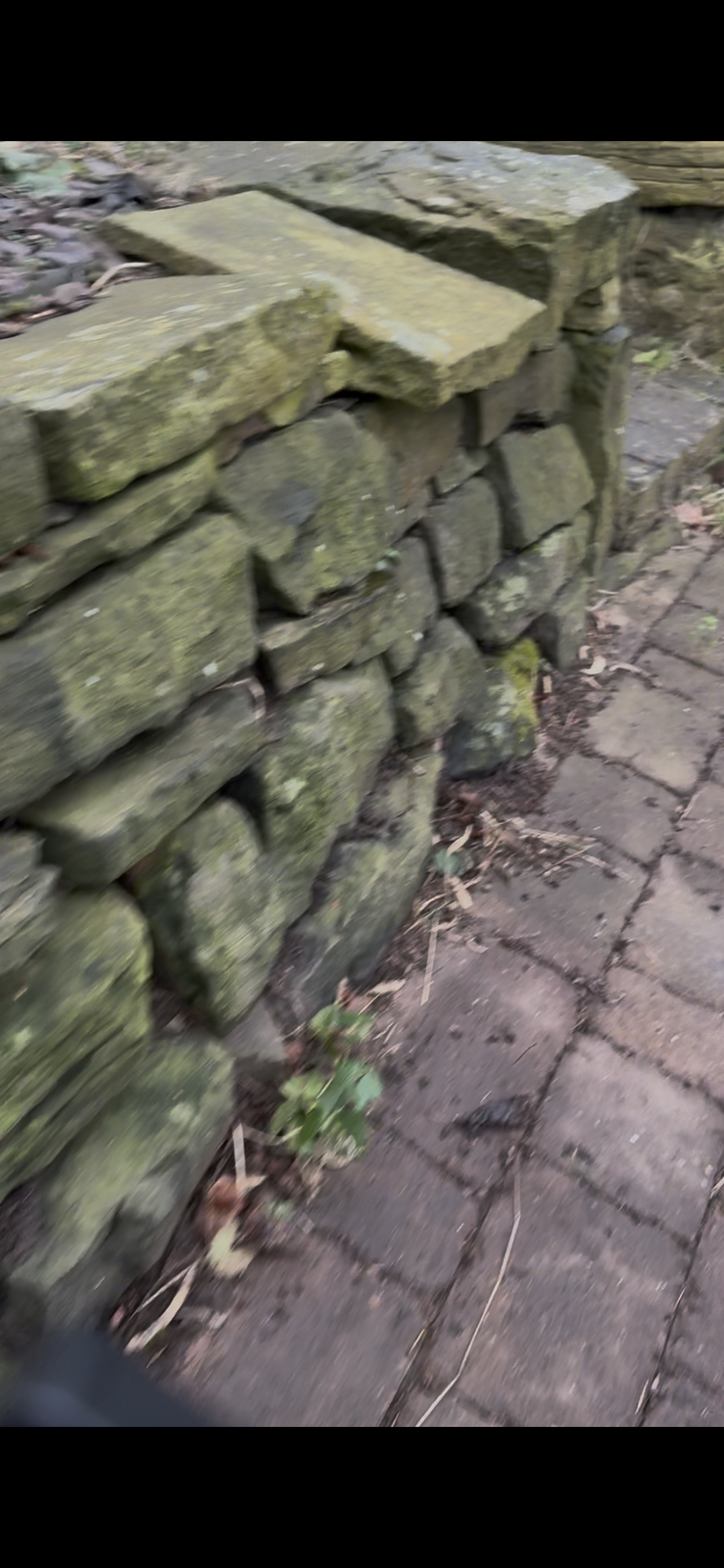

Excuse the rubbish pictures, I only had a video of it and I can’t upload videos it appears.
The wall looks like a dry stone wall type build. I’ve never noticed any mortar. And the crumbling part is where all the stones have fully fallen out and soil and weeds have taken over.
We are also planning on taking it back to actually make more room at the bottom of the garden for a shed and garden office so the existing wall foundations will be out of position sadly.

You've got some lovely stone there, make use of it, either in your new wall or elsewhere.
Building with stone is a definite skill that needs experience - either drystone or mortared.
Give it a powerwashing before pulling down, as the green will only be on the faces that are currently visible, where the daylight is. What's inside should be reasonably clean, it will still need a wash but not as much of a blasting.

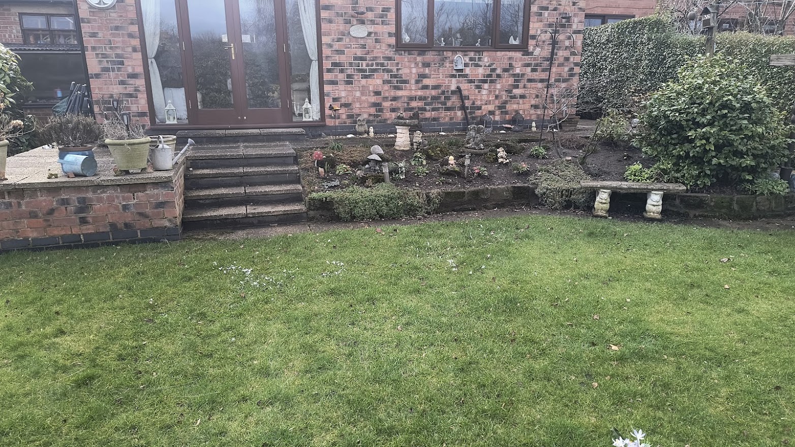

In a few years time your toddler will be 5 and if anything like my grandkids will happily jump off my 600 high patio, yours will have more fun because they will have to climb up the wall and jump off 1000 high. Personally I would keep the rustic charm of the stone wall, re build in new position with slight backward batter, no foundations as such needed (lot easier/cheaper than laying brick) and if you want to protect the toddler for a few years put some temporary 2ft fence panels in at the top of the batter which you can take down as and when and have a open looking garden as opposed to a brickwall to look at. You could make the wall into a flowerbed area I attach a photo of my wall/bed area, I mortared the small retaining bit at the front, basically laid it at ground level bedded on mortar and battered the soil back with some of the stones placed to give it a bit of kerb appeal but I guess it depends on how good a bricklayer you are and what your attitude to gardening is, good luck
