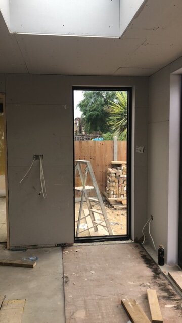

Building inspector wants a trickle vent installed in our new extension. Glazing company did not explain this although FENSA registered. I thought it should have been in place as standard but we didnt ask. They have offered to retrofit the vent but will it look terrible seeing as window has slim aluminium frame? Here is a pic and I would be grateful for your input as always!
Did you discuss other options with BC? Could accept ventilation elsewhere .
One option is to stick a vent on and remove once BC has signed off.
It'll look fine if they have enough room to install one. On our aluminium windows vents had to be installed in a separate aluminium header attached to the frame.
Didn't the drawings show that a vent should be fitted?
We didnt get any drawings. The windows and sliding doors are of good quality and reasonably priced for what they are. But I have never come across trickle vents not being fitted unless we specifically asked them not to.

Why will a trickle vent "look terrible"? Get a nice one.
Who designed the extension without trickle ventilation, FFS

it wasn’t designed with out trickle vents, it was assumed they would be on the fixed window as we didn’t ask for them not on there. Hopefully won’t affect looking sim profile too much on window. To be honest if we are opening sliding doors etc to garden I don’t see point of them. Perhaps winter though…
There was no need for FENSA registration I don't think, as it's part of an extension already subject to Building Control.
