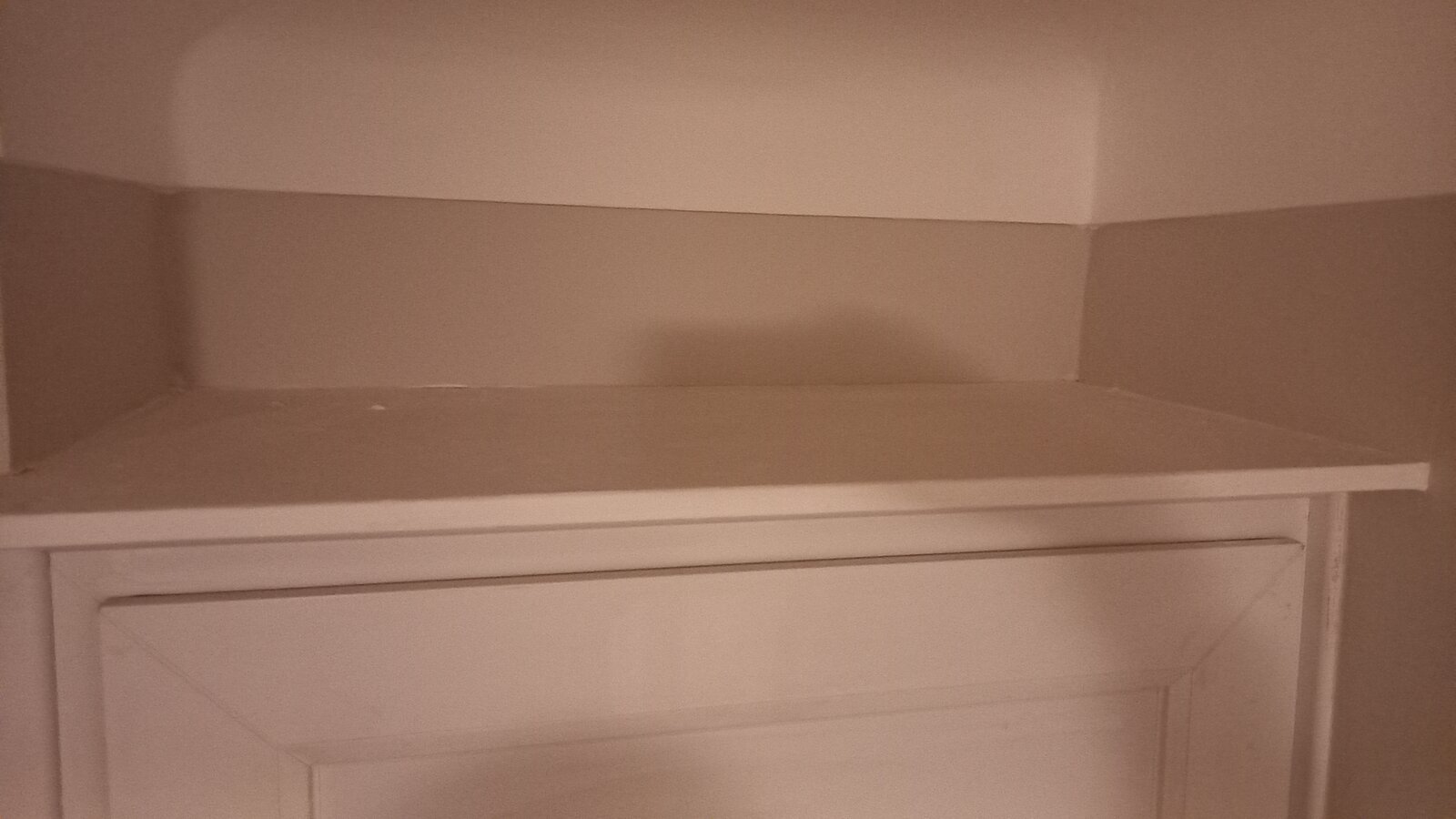

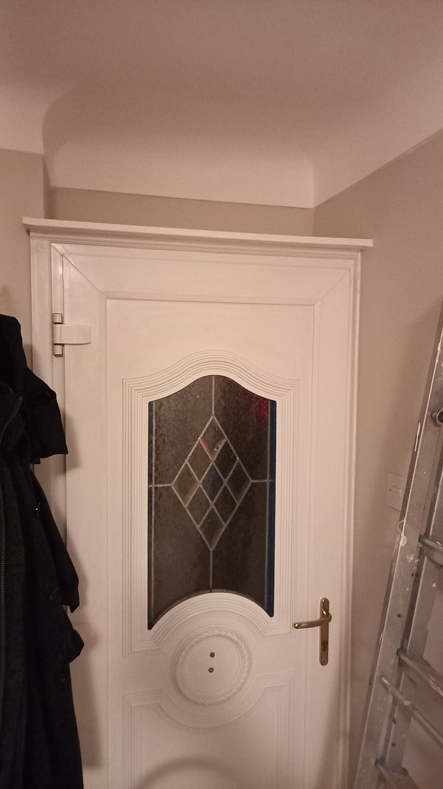

- for installing one into a UPVC door, would you just go through the frame at the top?
- my front door has a possible option that would not entail any drilling through the frame. Photo attached. It has this piece of wood sat above it which is basically the roof of the open porch, or alcove, outside. Firstly, I find it slightly weird that there's only a piece of wood that thick separating the outside world from my home, but beside that point, how about installing a trickle vent into that piece of wood so the holes go through the top and the vent pieces are above and below?

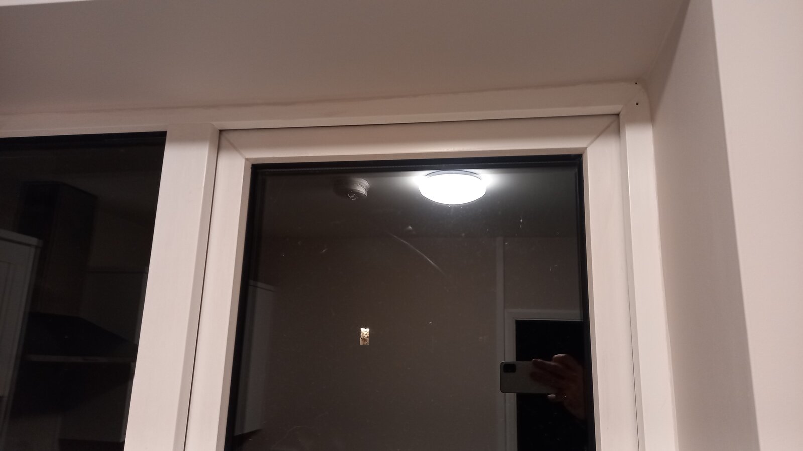

- otherwise planning to install them into the top of the sash of windows. Like the one attached. Besides avoiding the glass, any thoughts?

Any thoughts on going through that piece of wood "roof" over front door?

My plan is to put them into the window sash in each case. Do those have metal bars in them? They are also removable to make thr kob easier.
I've fitted quite a few recently, I must have cheap windows, no metal found. I drill a hole at each end and slot with a multitool.

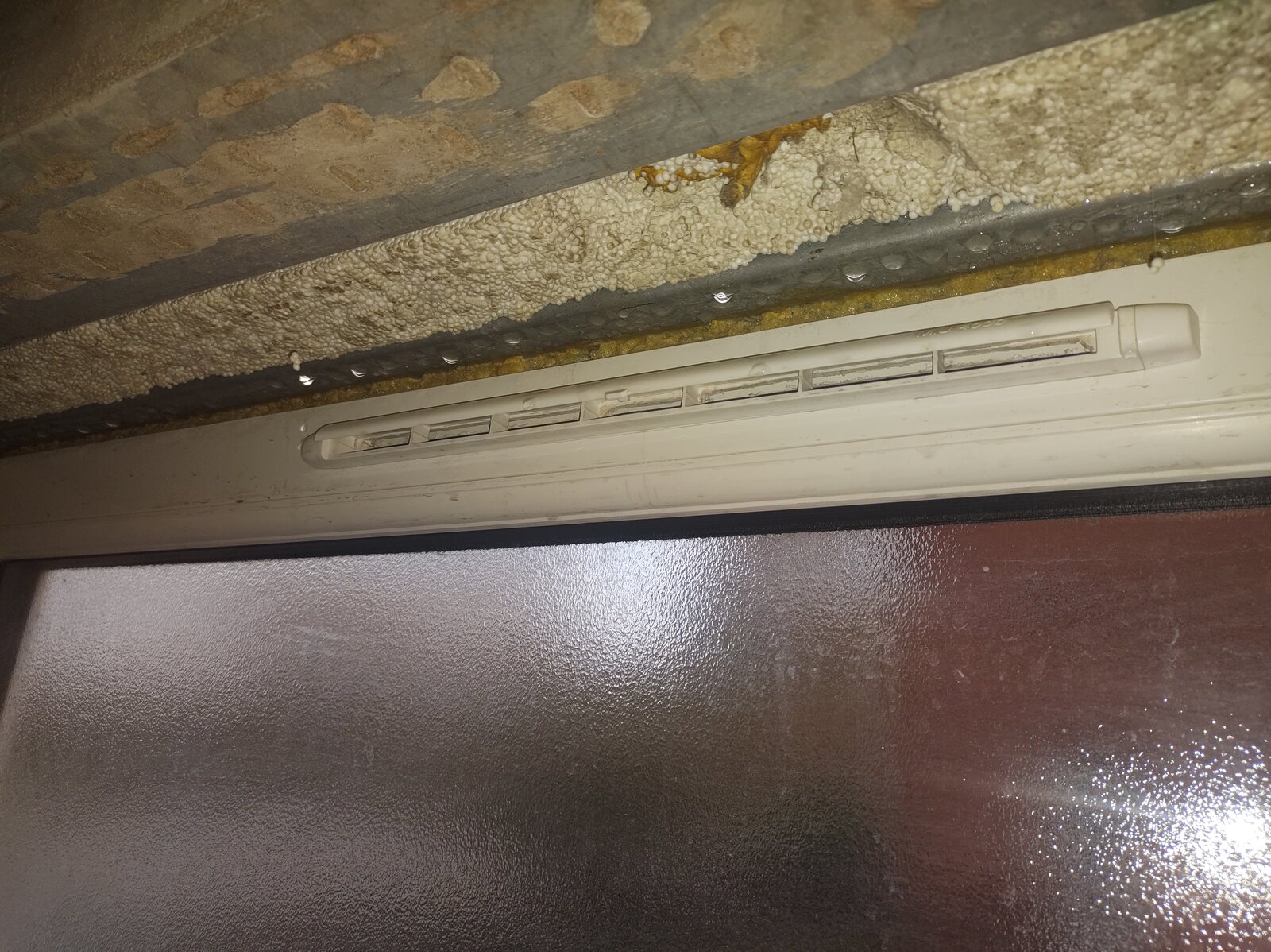

This one's a rehau - you can see the drips of condensation on the lintel - I'm hoping that when I foam on the plasterboard it'll all go through the vent!
