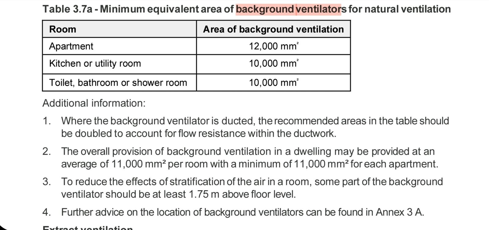

Thanks for the replies. The window supplier isn't enforcing trickle vents I think because the old ones dont have them. They said if the old windows had them they would be more likely to enforce. I guess it should be based on whatever the regs say but that is for new builds? Looking at the regs for Scotland they talk about natural ventilation with intermittent mechanical extractor is sufficient for air infiltration above 5m (hm2)@50Pa. But they seem to focus mostly on rooms generating moisture i.e. bathrooms/kitchens/utility as you'd expect. I can't see anything in the Ventilation section of the technical handbook that mentions trickle vents in windows. But that there should be natural ventilation but not by what means from what I can see. Other than gaps under doors..

Ok minimum of 11000mm2 per room is what I'm getting from this now. If I square root that I get 105mm, maybe that is the vent size requirement.

Found this on Gov UK website-Document F volume 1 FAQs. Only applies to England though..
"What do I need to do if I already have a wall ventilator in my room?
When replacing a window in a room where there is already a wall ventilator present which meets the minimum equivalent areas in Approved Document F, volume 1, no further background ventilation needs to be added after replacing the windows."
In my view the wall ventilator is a better solution so will keep that at least in rooms that have them.
