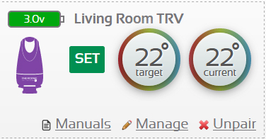

I looked at what to me seemed simple,
the PC shows both target and current so all it needs is a switch so if any TRV head reports target above current then boiler runs, other wise boiler stops, the unit supports IFTTT so it should be easy enough to do.
But when I looked for an app to do that, nothing.
