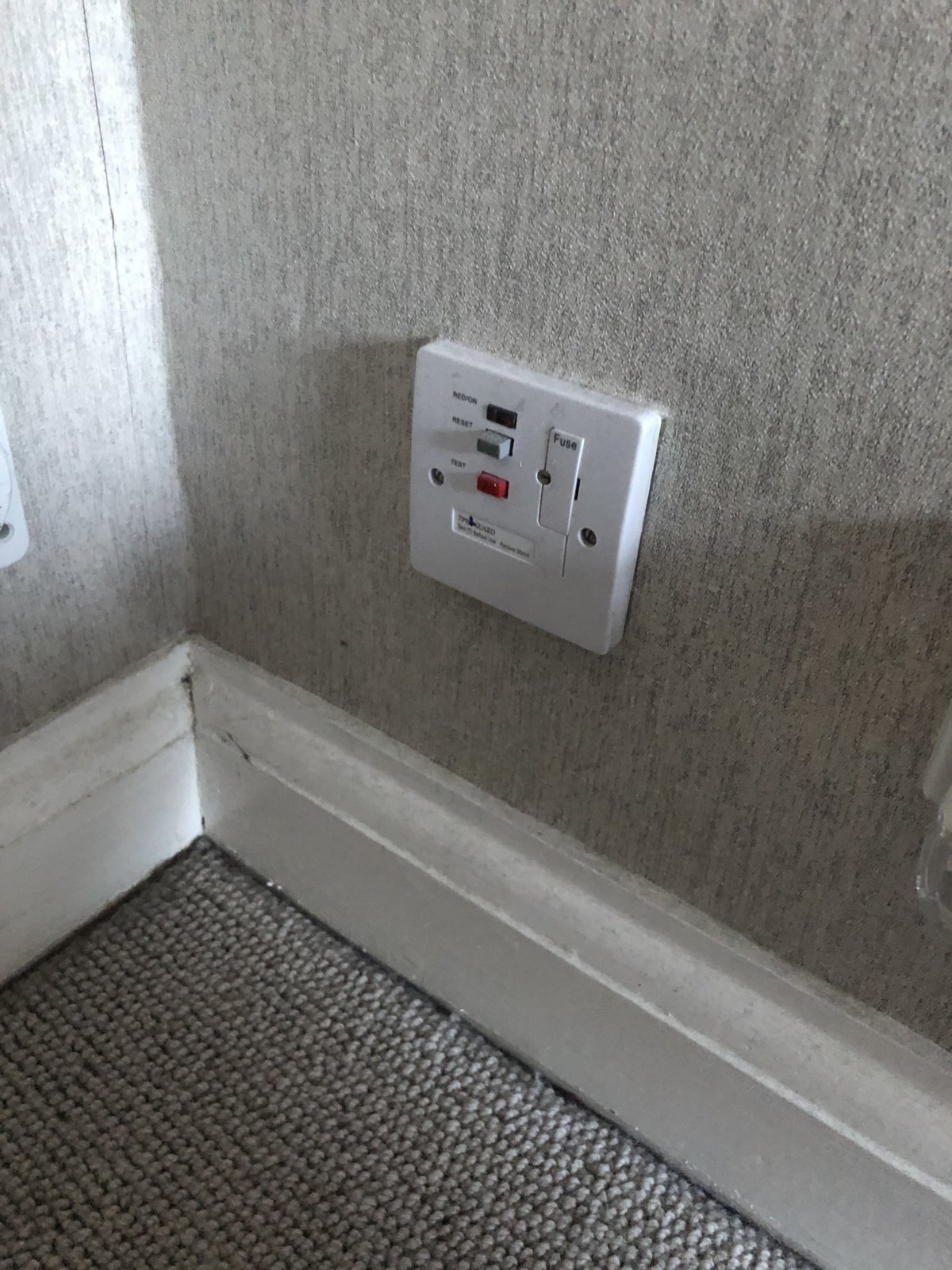

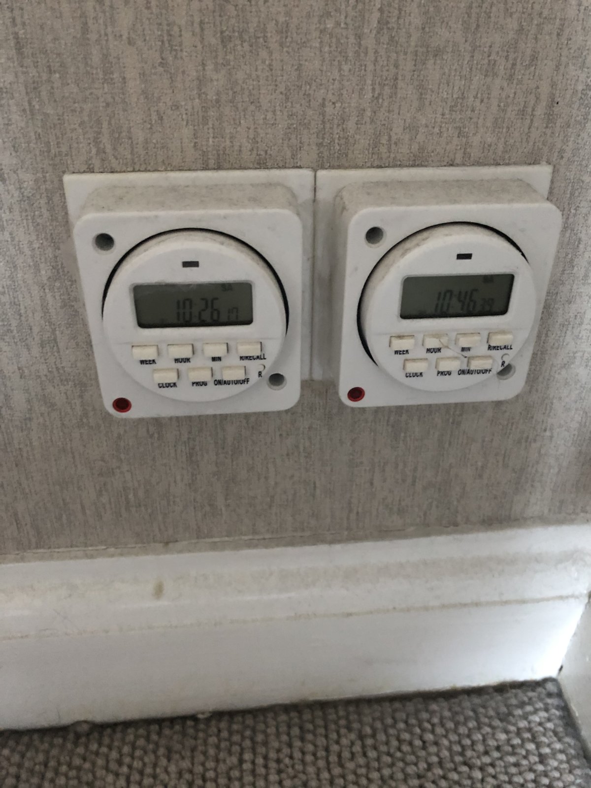

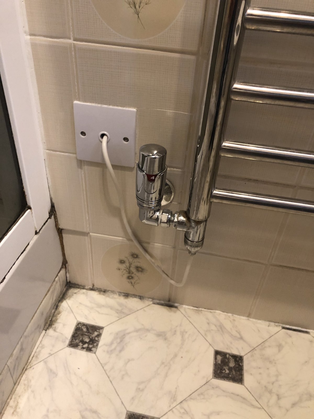

Hi,
Renovating our two bathrooms. Both have towel radiators which are both electric and water fed. Looks like they are fed from a RCD's spur. See pics.
Thinking of installing underfloor heating and it would be helpful if I could reuse the cables already in for the towel radiators (obviously taking the cable out of the wall and straight to the underfloor heating). I would also use the same spots the electric controllers are now for the two thermostats.
Can that be done? I also think I would need to feed a thermo feed back to the controllers as well.

Underfloor heating for bathrooms needs either an earth mat or special cable which is earthed, could not use reychem without earth mat, may have change now.
Thermostat should be 900 to 1200 mm from floor, the existing timers look too low, it will need a pocket (tube) from thermostat to under the floor for the sensor. So wall will need chasing anyway. So may as well set at right height.

Some electric UFH mats have an earth shield in the cable (like you see on co-ax) - simple to fit. The Heatmiser Touch-E V2 timer stat is good. It can be a timer or just a stat. It can sense the room temperature and floor temperature, or just the floor temperature. Best to fit it outside of the bathroom in the hall, not inside where there is moisture, then set it to control the floor temperature only. The floor sensor probe from the stat must be fitted so it can be pulled out and replaced, so it must be free to move in the corrugated plastic tube under the floor. Fit a fused spur just above the skirting in the hall with a 3A or 6A fuse. This could isolate the UFH mats and the towel rail. Both will not draw a great amount of current.
The mats consume approx. 140-150 watts per square metre. 2 square metres is usually big for a British bathroom, so low current draw.
I see you have an RCD fused spur outside the bathroom. Good. The towel rail must have its own isolation switch outside of the bathroom, with the RCD fused spur as the master for both. The UFH can be switched on and off from the stat.
