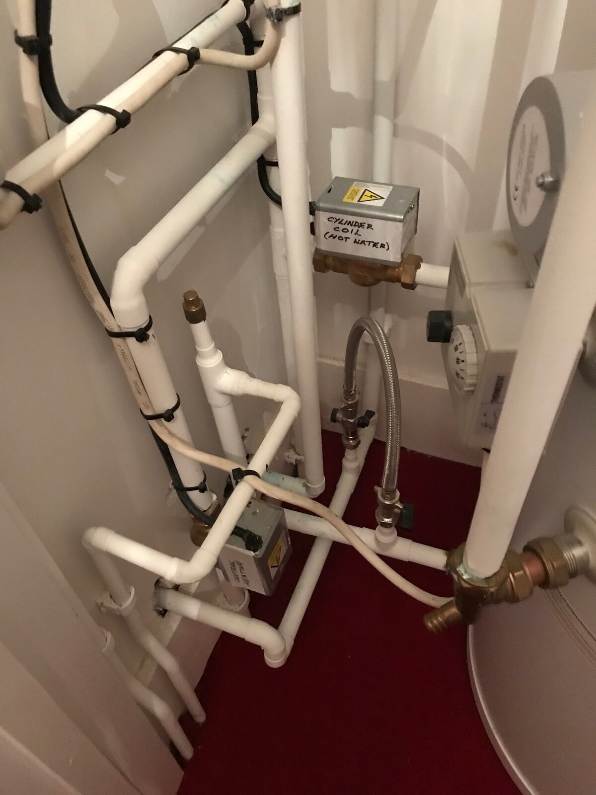

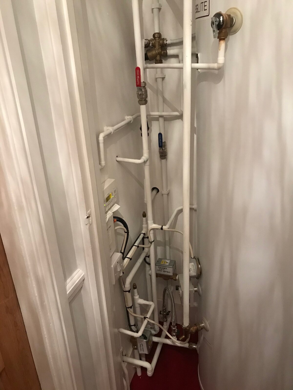

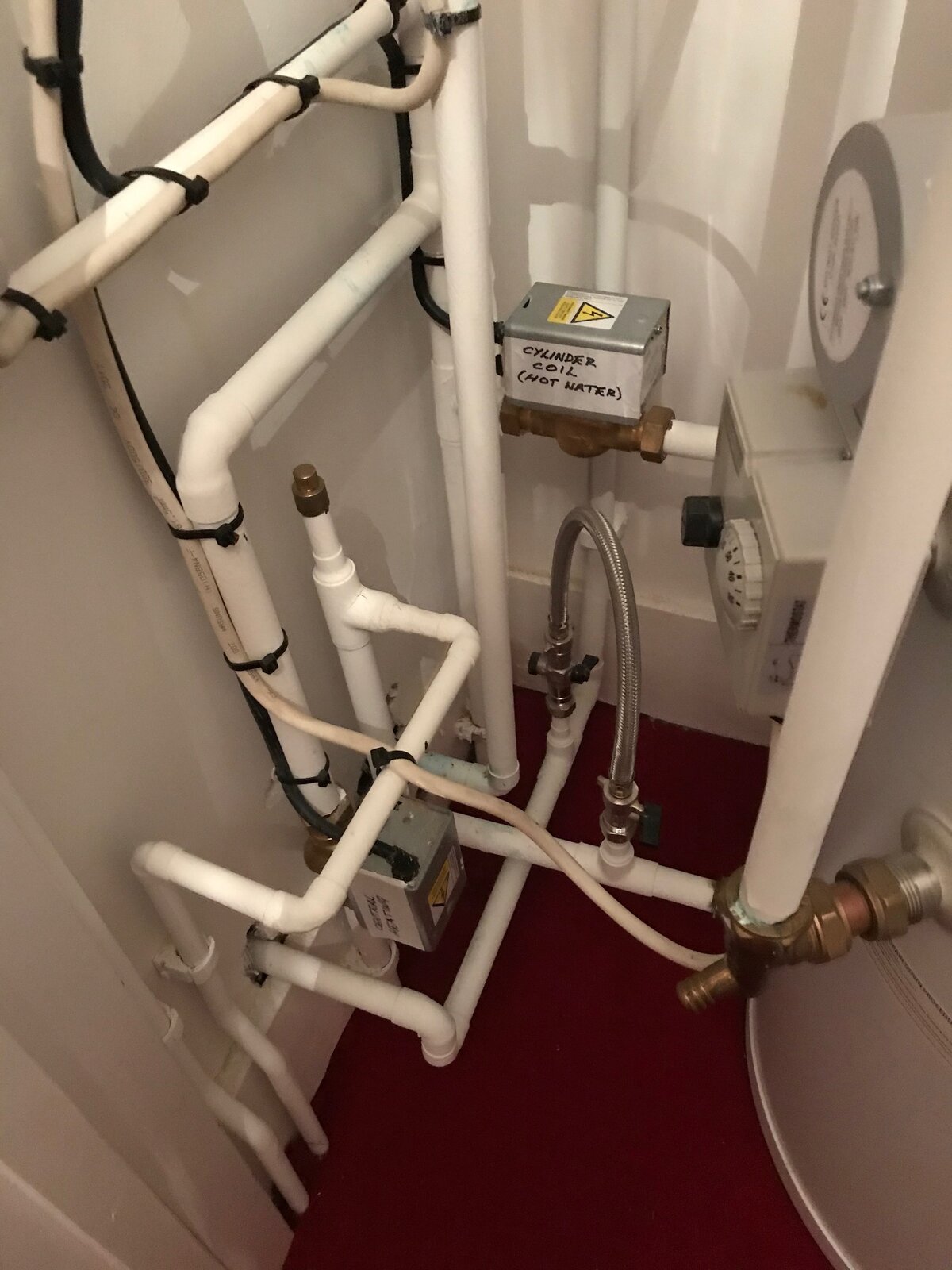

Pics show everything you can see in the airing cupboard. Boiler is directly below in the kitchen on the ground floor. The pipes to the far left coming out of the floor is the flow in and flow out for the rad in the bathroom on the HW circuit. All the rads connect to the return pipe to the boiler under the floorboards.

Pics of pipework in airing cupboard as requested.
The small bore pipes coming out of the floorboards on the far left are the pipes for the towel rail.

Well it certainly would bring on your towel rail with hot water demand, so yes, in theory it’s wrong. It should be fed from flow to heating.

It does go to the ch valve, but it’s before either valve, so whichever valve is calling fo heat, it will distribute via that feed.
