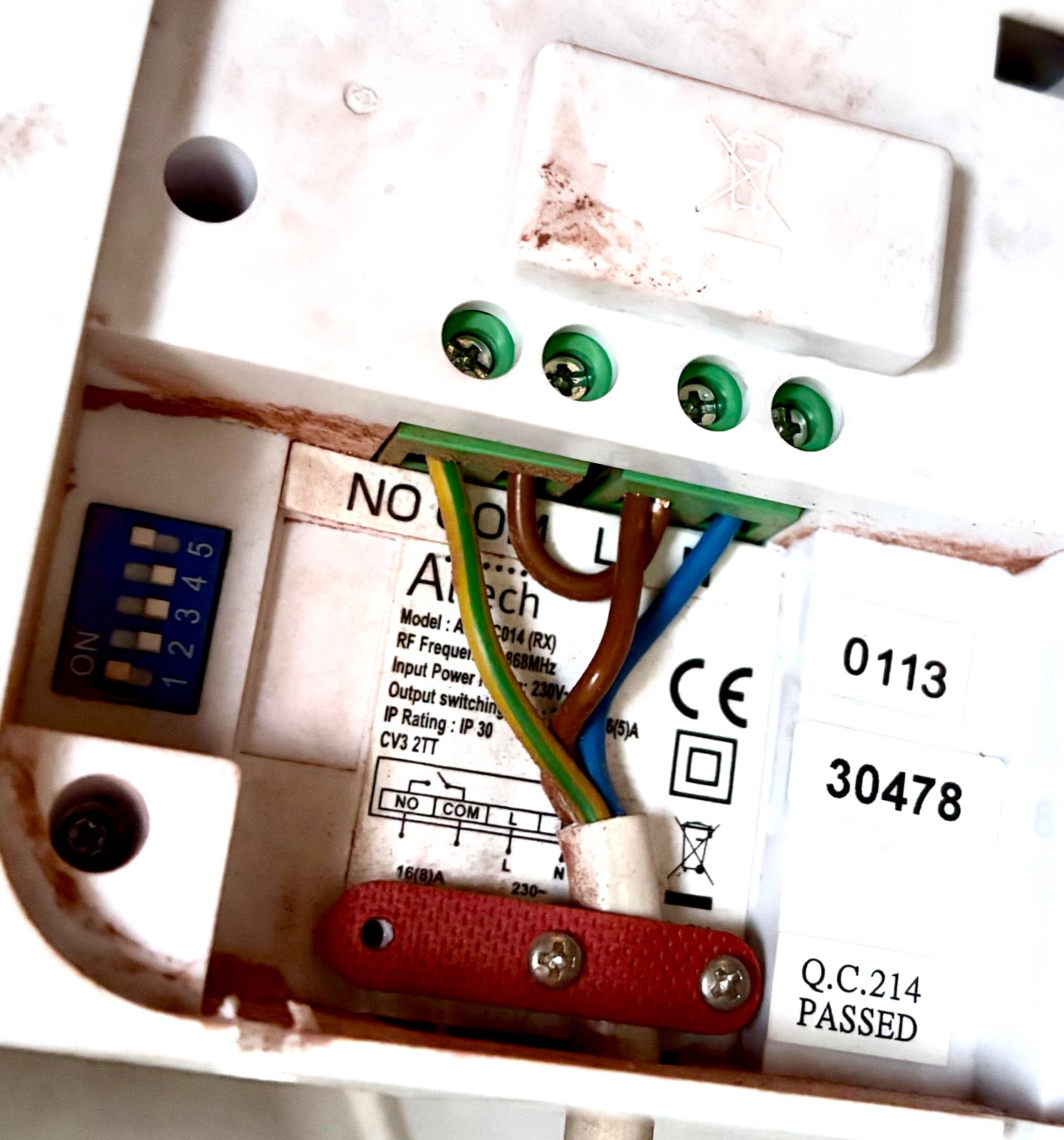

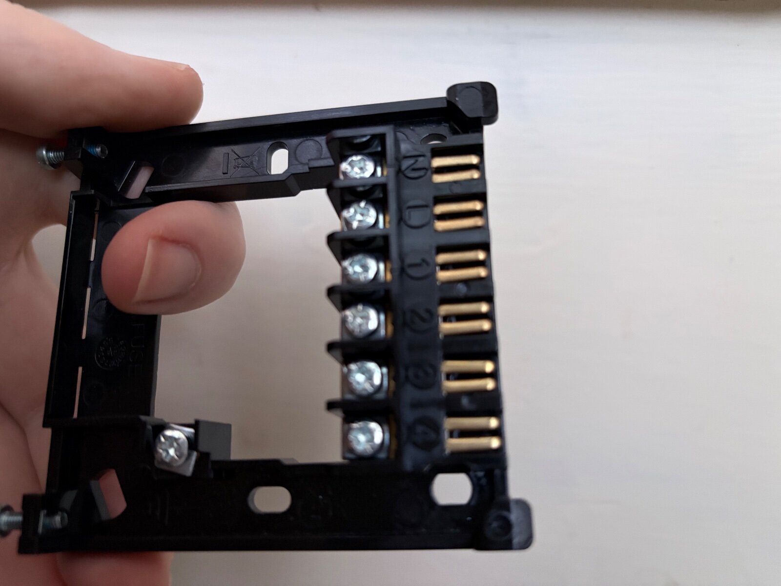

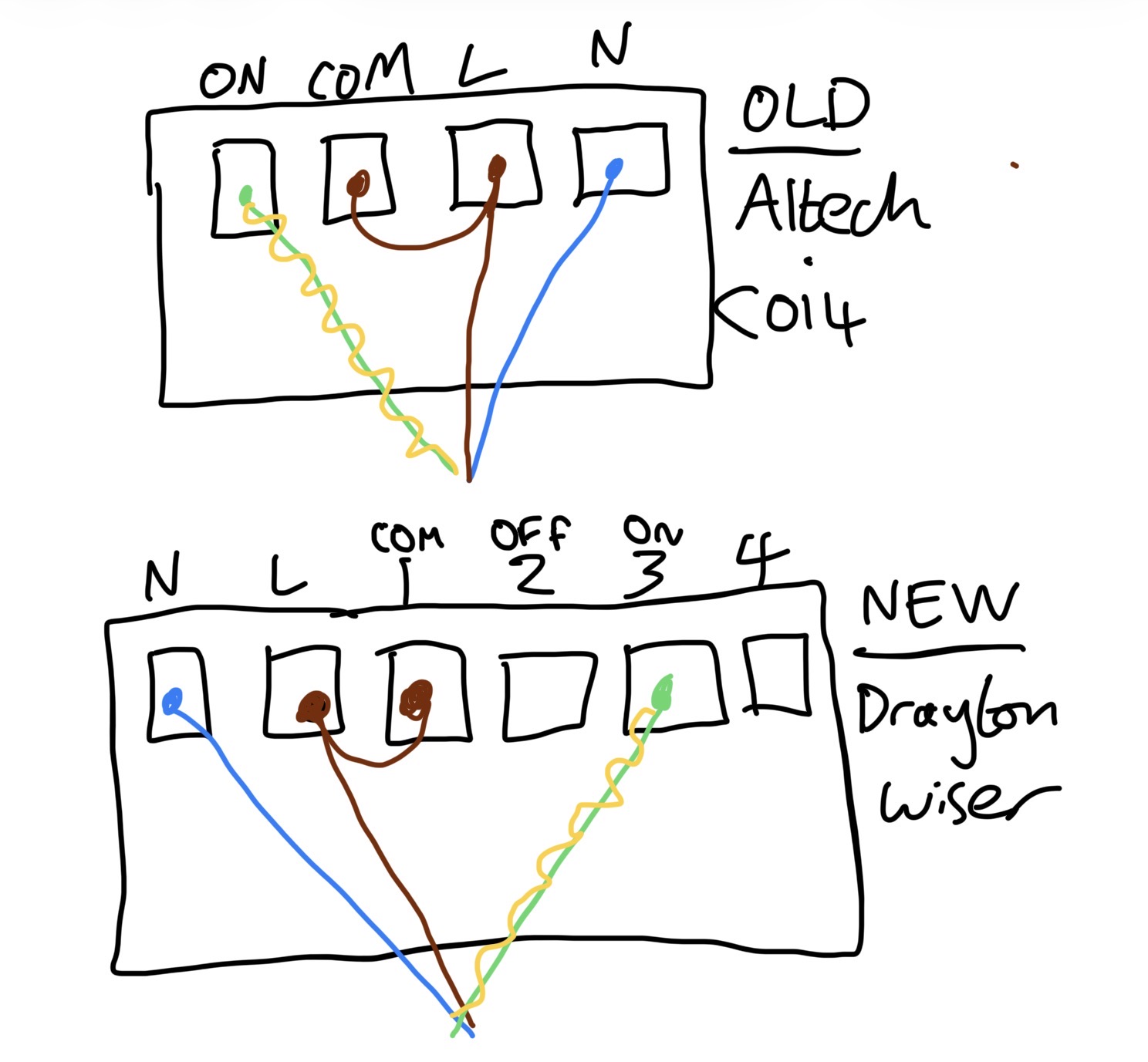

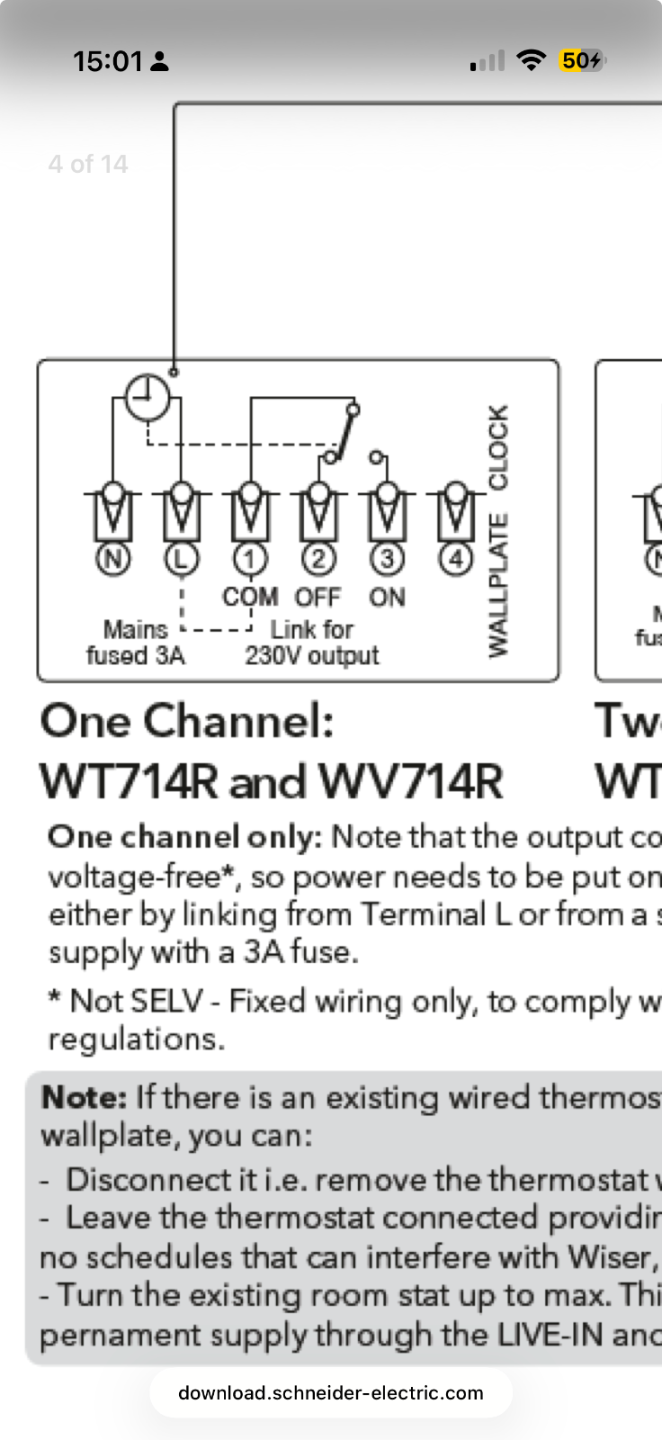

My house has a single circuit combi boiler, with an Altech C014 Controller and wireless thermostat. I want to replace this with a Drayton Wiser controller. Both of these are double insulated.
Photos show the existing wiring, and my proposed new wiring for three new backplate. Is it correct, or should I be getting an electrician?

As above, looks ok, but the green/yellow shouldn’t really be used for a live wire. Perhaps brown sleeve it or use brown insulation tape.
Yes, your diagram is correct.
It has recently been made against the regulations to use the earth wire as a live conductor but it was not when installed.
It would be good to sleeve it brown but it doesn't really make much difference.
Thanks so much. My spark wanted £120 to do this, which I don’t begrudge him, buts it’s a lot to change 4 wires.
