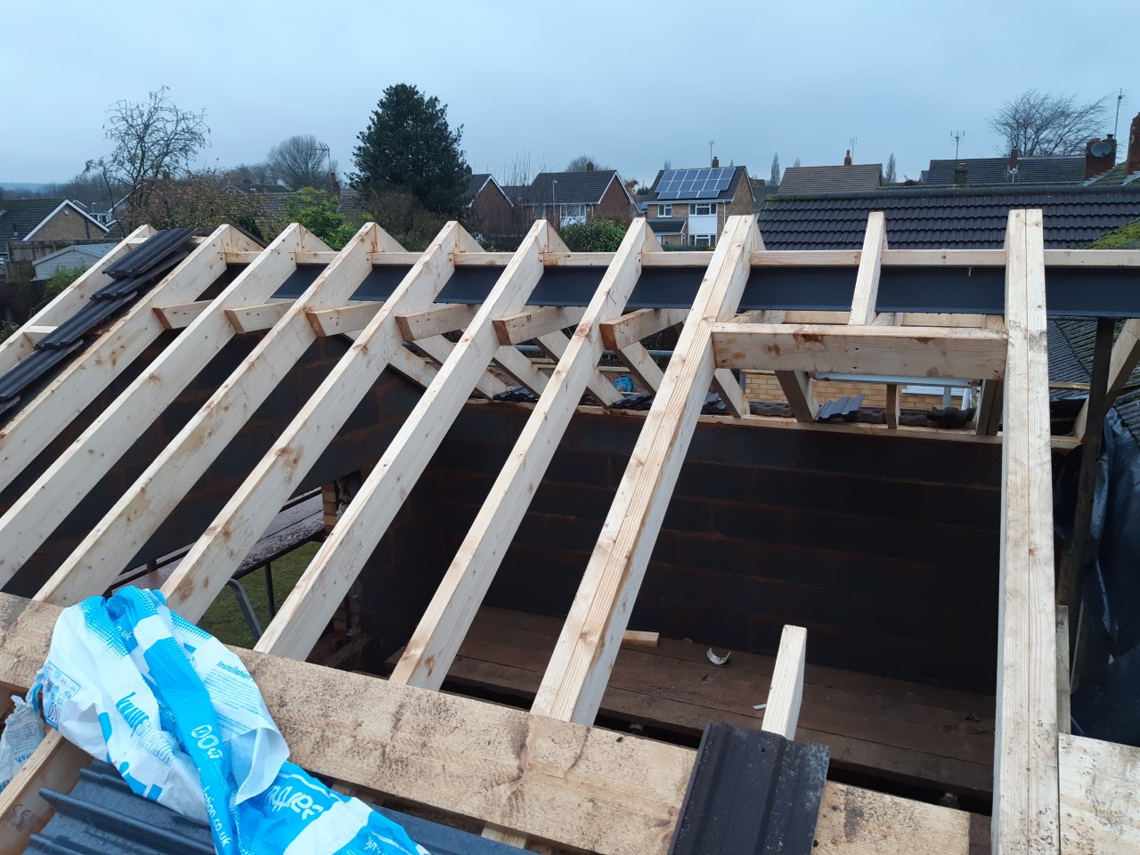

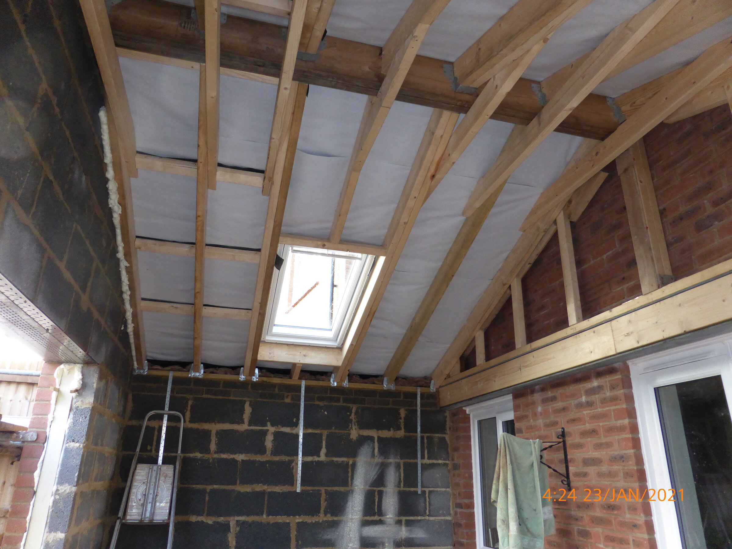

Siting rafter on the beam is potentially better for loading, but probably not much in it for relatively small roof
You don't need collars or ties with a ridge beam
You don't need to double up the rafters - 5x2 timbers at 400ctrs. would be more than adequate for the size of roof you've got.
It makes no difference structurally whether the rafters are sat on top of the ridge beam or supported from the side on hangers.
No need for ceiling ties or collars with a ridge beam. Bolt your timbers together for the ridge beam with coach bolts and timber connectors.
