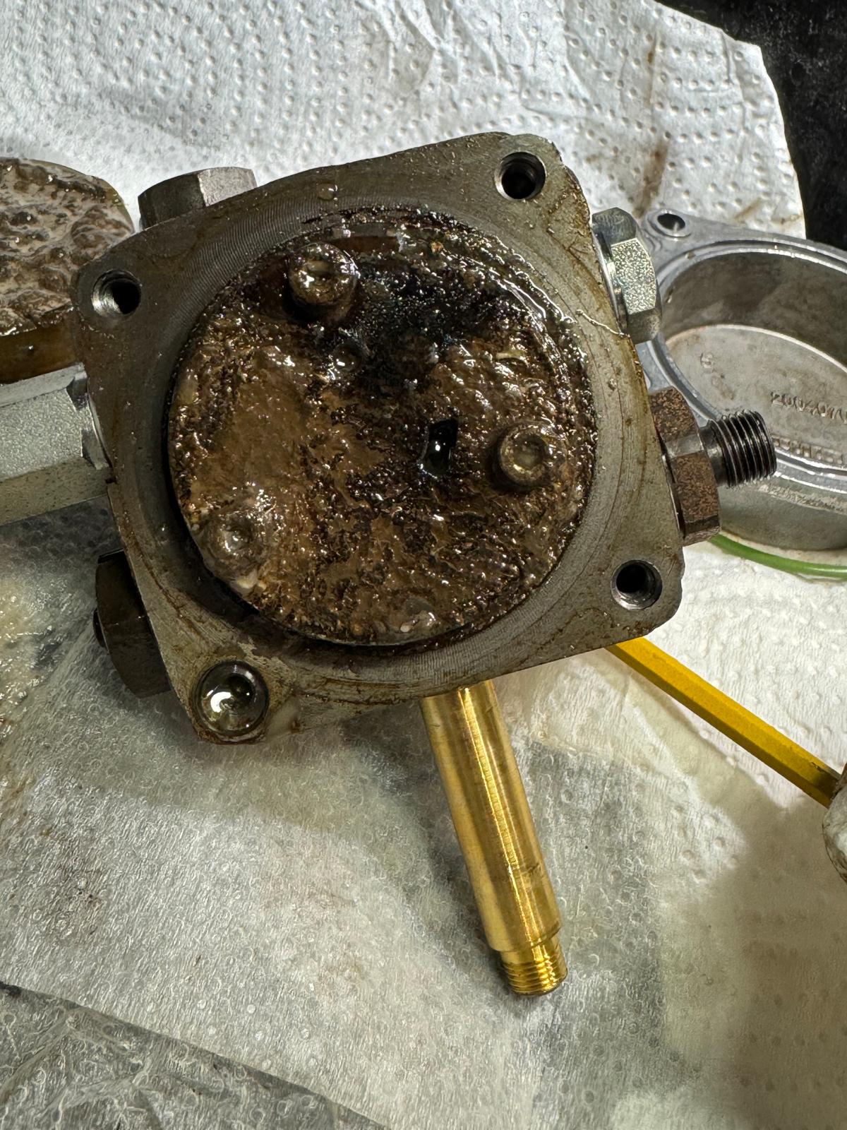

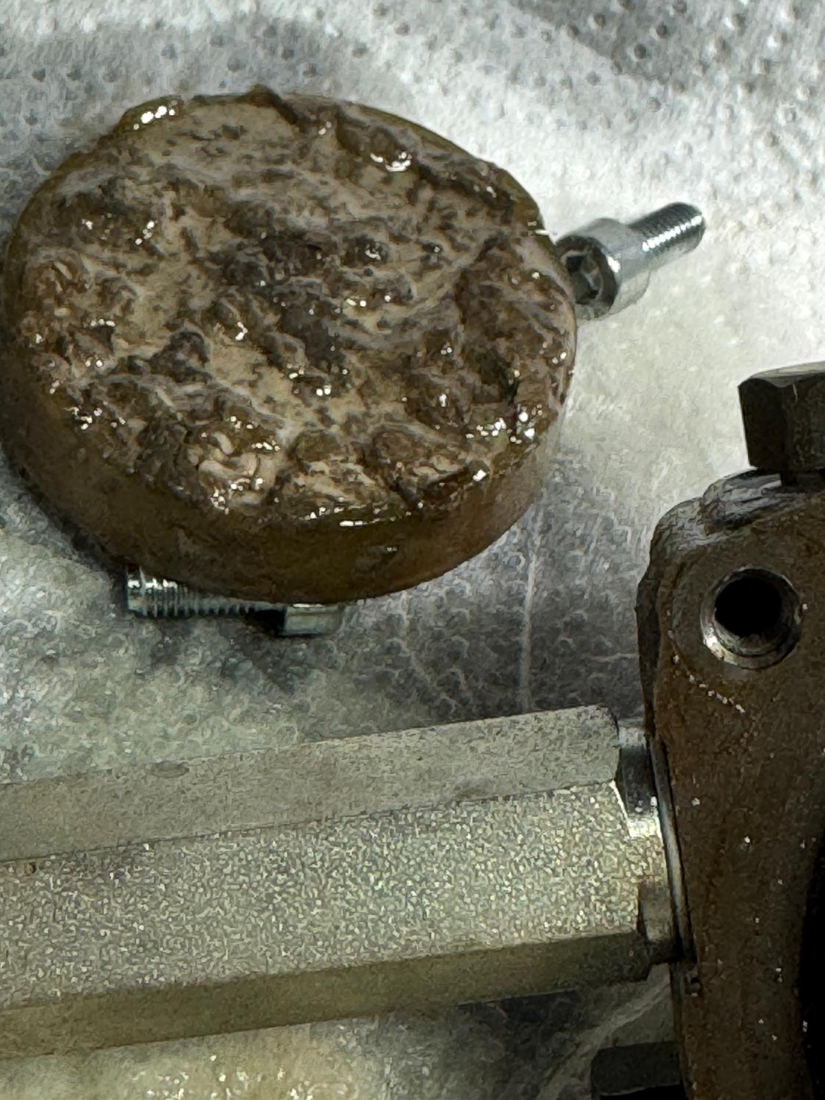

Hi all , I have a Grant vortex pro external boiler which stopped working , the burner motor would not start but also no Led light on , I thought it was the capacitor as it just sounded like it wasn't getting the current, I changed the capacitor and still wouldn't start ( old capacitor measured 3.5uF) I left the new one (4.5uF) on any way .
I found a Riello flow chart , I had 240 at the control box and 54volts on the white wire of the terminal to motor so i took the fan cover off the fan to see if it had seized, it had a little resistance to start but then seemed to turn freely , I put it back together and it all worked fine for a week now it has just stopped again same issue , the motor not starting and no LED ,.
Any advice appreciated , I am thinking the motor may be going bad , ?
Regards..
Its a RBD1 Vortex 15-26 , control is R.B.L 535 SE/LD ts8/1s
