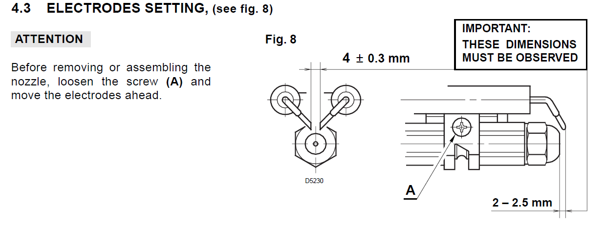

You could wipe down the electrodes and check the gap although I have never had to adjust mine (Riello G5X) in 18 years, the settings are below but probably similar for your friends burner. Also access the electrodes insulators as far back as possible and wipe these down as well. Presume you have checked tank oil level OK and fire valve open etc.
